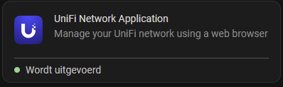

I fully agree with the AP suggestions. I use Unifi PoE powered AP’s which I manage with the Home Assistant Unifi Network Application app.
