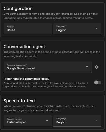

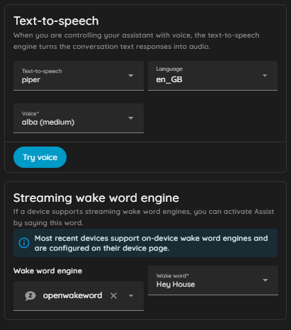

Also, if anyone can spot anything wrong with my personal setup…
Service/device Port Successfully in HA
Wyoming Piper (TTS) 10200 yes
Wyoming Whisper (STT) 10300 yes
Wyoming openWakeWord (wake) 10400 yes
Kiosk (voice satellite device) 10700 yes
Kiosk
And in HA WinKiosk, the revelant settings…
voiceAssist:
  enabled: true
  wyomingHostPc: (server ip)
  wyomingHostPcPort: 10400
  inputDeviceId: '(mic here)'
  wakeWordDelay: 3
Voice Assistant
Hey House wake word was custom trained but I am having the same issue with Hey Jarvis (built in).
OWW
