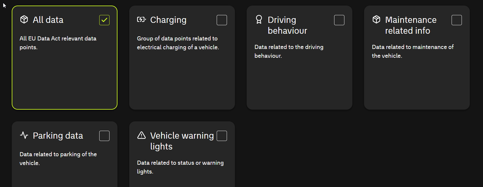

Which data cluster(s) to pick ? All ?

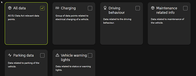

On the portal side, each car needs its own active request: continuous, 15 minutes, dataset preset All Data (not Charging-only, and not every individual field ticked). “Daten abrufen” every 15 minutes sounds right. Then wake each car once (short drive, ignition on, or open the brand app) so it uploads telemetry. Empty _no_content_found files in the first windows are normal; Home Assistant skips those until a real snapshot shows up.
For the Golf you can keep using EU Data Act the same way. You do not need vag_connect working for either car if the portal delivers data. If Integration status stays on waiting_for_portal_data for more than a day with the car definitely online, check on the portal whether real ZIPs (without _no_content_found in the name) are appearing for each VIN. If not, delete and recreate the request with All Data only.

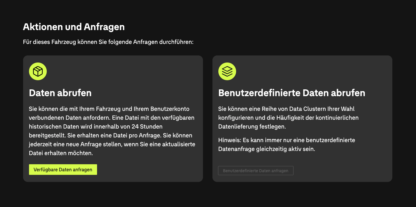

you have to choose “Benutzerdefinierte Daten abrufen”

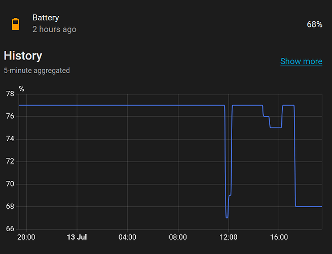

I’m having trouble with the data being garbage. In a single file (so a single .json in one package that I’ve downloaded from the portal - HA uses the same file I assume), I see two different values for SOC for example:
      "key": "7bddd5e7-43a4-3878-bd63-9502782f77a5",
      "dataFieldName": "battery_state_report.soc",
      "value": "77"
      "key": "506cb83e-f99f-3af3-bbeb-0429b69a78d9",
      "value": "75"
The two values are in the same data list, I have one vehicle.
In some other files I see just one value, but it can be incorrect. (I assume something from history, as it appears in multiple files with the same value and the same UUID key).
This of course has an effect how things look in HA. Here’s the battery graph from today:
Not something that can be fixed within the integration, just writing this here in case somebody else is struggling with similar issue.

Can some help me out where in the portal i can create the 15 min date refresh? It seems I can only select a monthly report. I managed to get the .zip file and stuff. I think i’m the problem, please help me out:)
