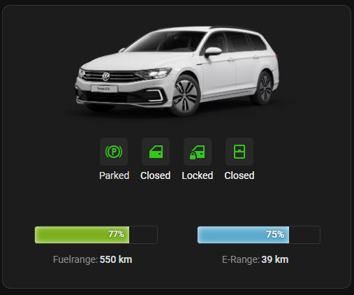

I own a 2020 VW Passat GTE (B8) and can confirm that the integration works wonderfully. I received the first valid data after about 12 hours, and I was able to rebuild my previous vehicle card in Home Assistant using the new entities.

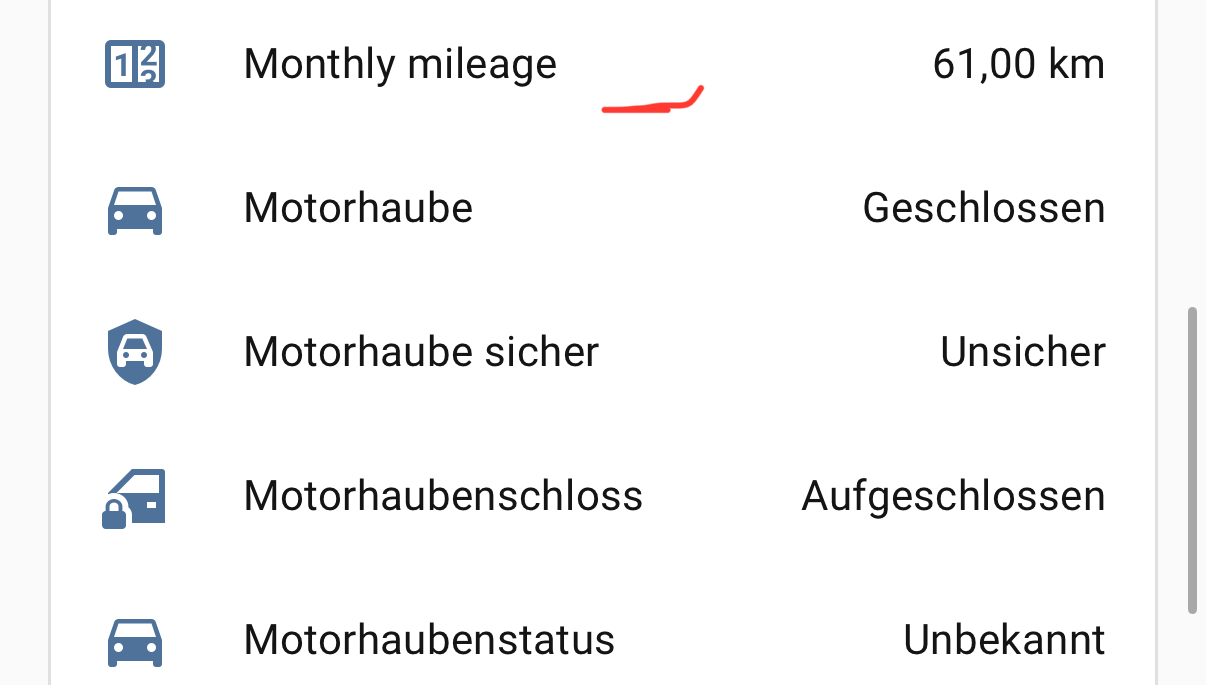

Translation bug:
