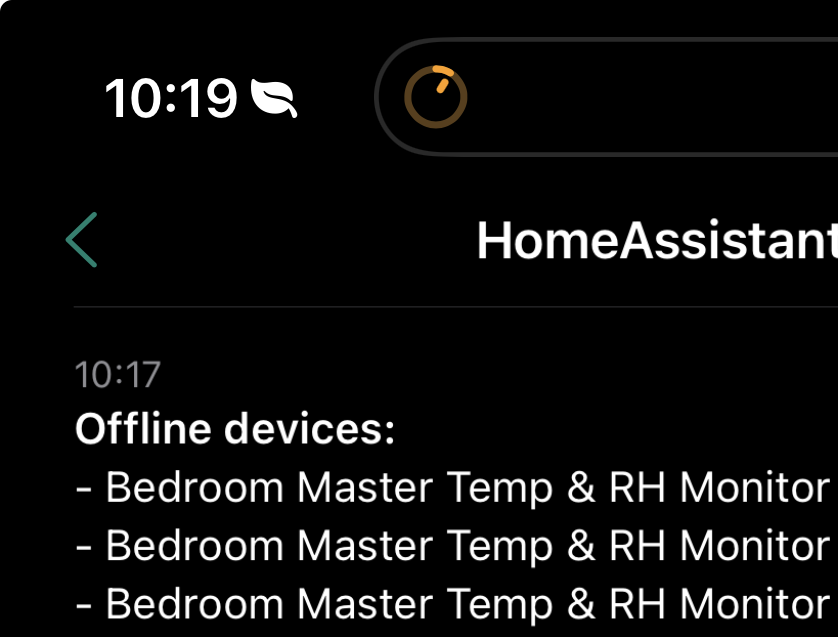

ok, I checked and I am using the latest version. The offline devices uses hyphens when accessing the {{offline_devices}} variable that I use to send notifications to my ntfy server.
When sending persistant UI notifications I do see a buttet list where the first item has a bullet too.

ugh ha doesn’t like me at the moment. I tried to take control of the blueprint and update the file to add the extra hyphen at the start. That worked for my published ntfy message but now the ui notification has a double bullet :rofl:
and ntfy:
So I reverted back, removing the automation and creating a new one, but now the HA persistant message still shows the double bullet :sweat_smile:

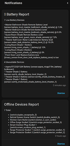

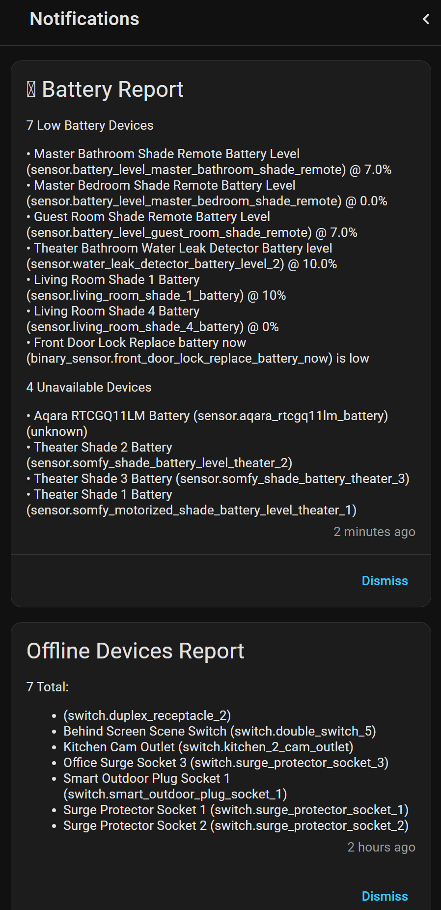

I use Google Chrome on Windows, this is what mine looks like. Please note that your screenshot shows the Offline Devices, -not- the Battery Report. My screenshot below shows both so you know what they look like
