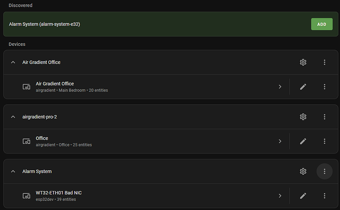

I changed old device (esp32) to a new config with different IP and name.
HA changed where it points via some mechanism (mac address tracking or something)?
HA changed the name for this same device but with new config
I installed same old config to new device
HA detects it as a new device
I try to reconfigure the HA device to new device IP
Fails
What do I do?
Edit:
Delete old device (with new name)
Add new device (with old name)
Working, yay
It would be nice if there was a button for ‘replace’ and it just did that for me. Or let me force replace the IP address or something, idk how it should work. But I was scarred to replace for fear of reprogramming everything.
