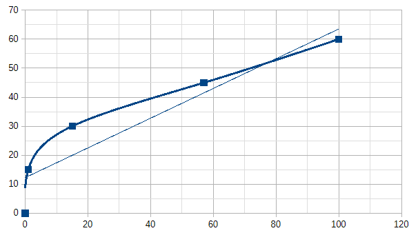

Well those points aren’t linear.
And the default degree is 1 (linear):
So if you had not commented out the intermediate points then you were getting predictions as per the thin line:

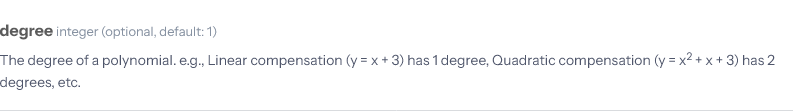

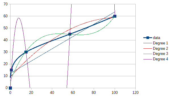

Degree refers to how many terms the polynomial you are trying to fit to your data has. In most cases the higher the degree the higher the accuracy, but not always:
