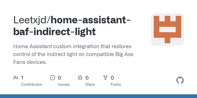

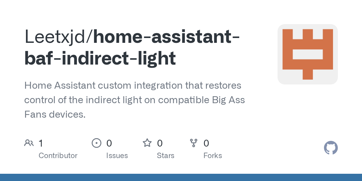

Project and download
Repository and complete documentation:

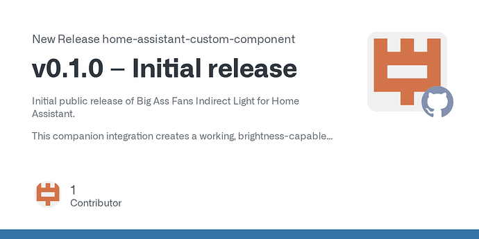

Direct download — version 0.1.0 ZIP:
https://github.com/Leetxjd/home-assistant-baf-indirect-light/releases/download/home-assistant-custom-component/home-assistant-baf-indirect-light-v0.1.0.zip
Release page:
This is currently a manual custom-component installation and is not yet distributed through HACS.
