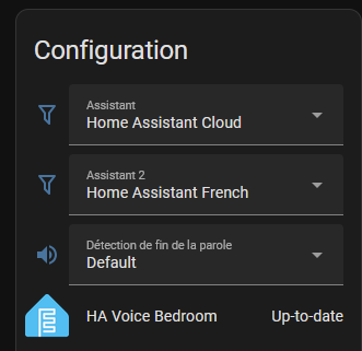

Here is my config for the Voice PE

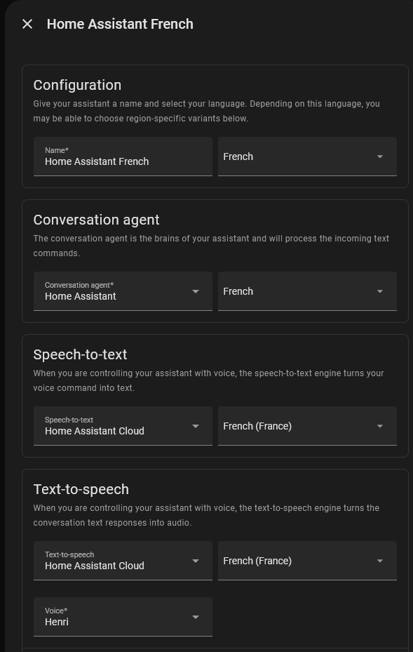

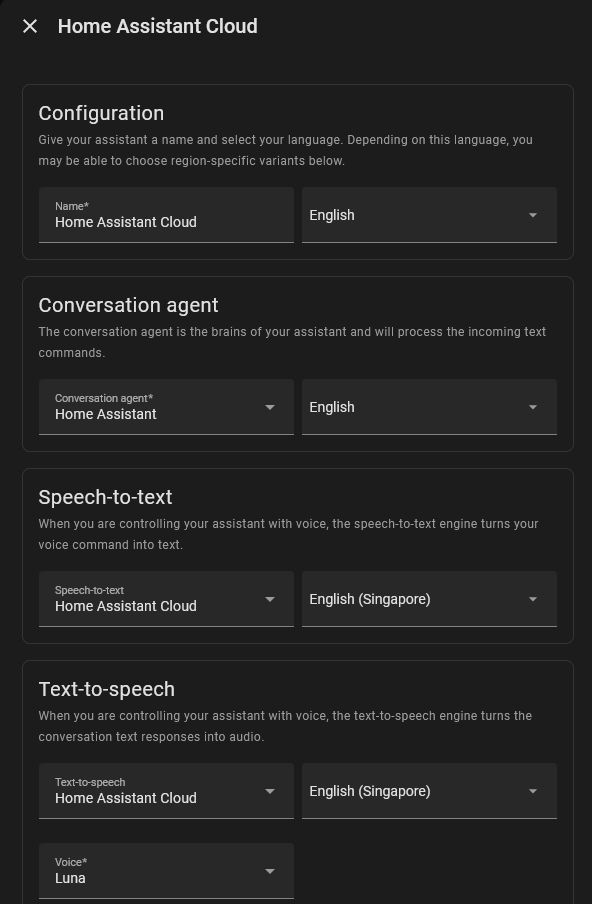

And for each assistant
English
French
Only the english language works at the moment.
Am I missing anything obvious ?

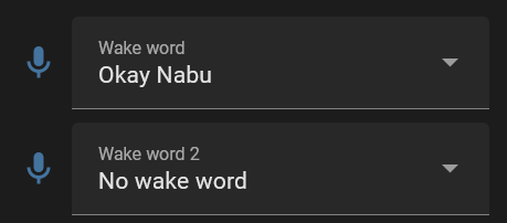

Hi, are you using different wake words for every language?

Hey thks for taking the time.
My current setup looks like your screenshot so I guess same wake word for all languages. Should I not?
No, that’s the point: you have to use different wake words for different languages.
I only use 1 language.
So for your “Assistant 2 / Home Assistant French” you have to set up “Wake word 2” with something else then Wake word 1 (which is for Assistant 1)
Ah now it makes sense ! Ok that works as intended thank you very much.
