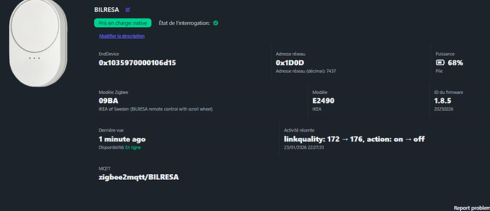

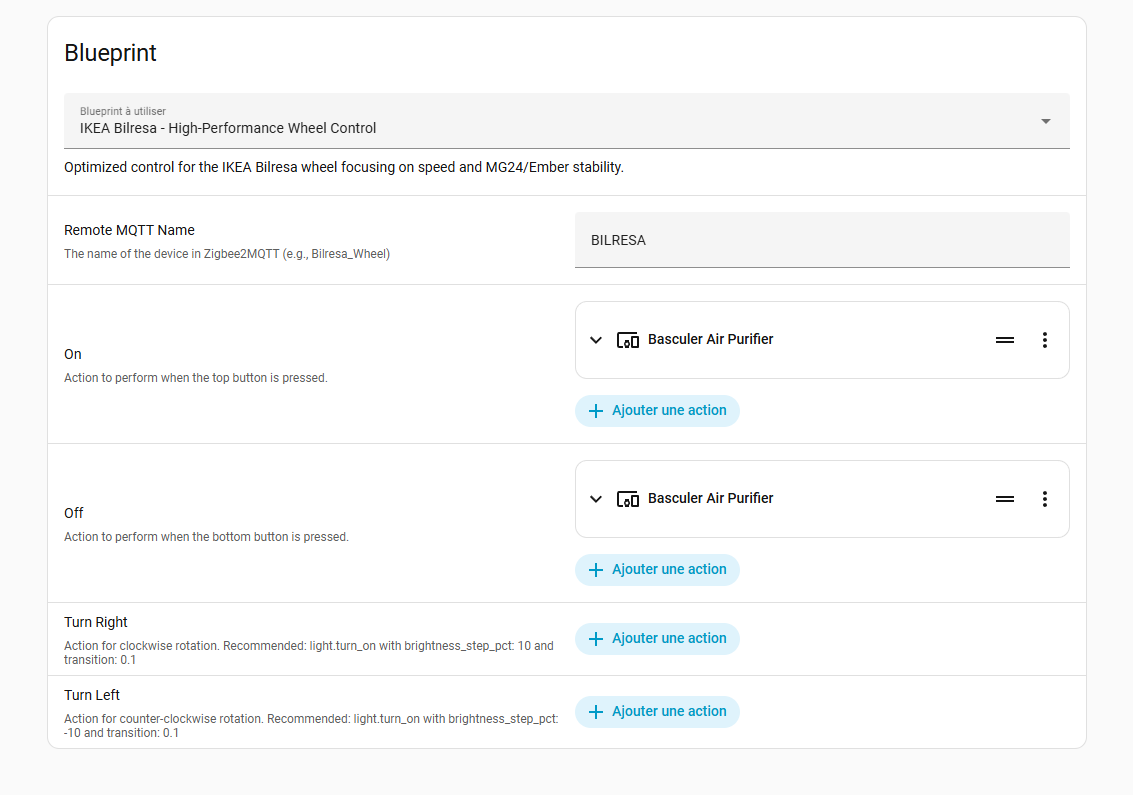

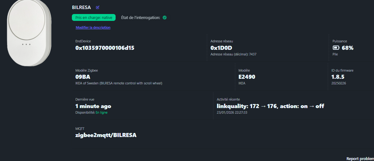

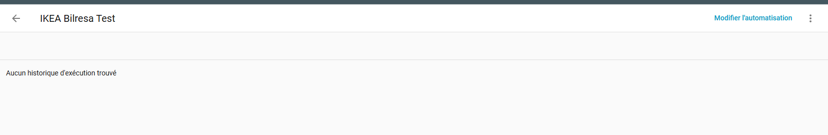

Ok maybe I miss something :
My device :
My automation :
But nothing happen.
My mqtt topic is zigbee2mqtt/BILRESA
What is in the Z2M log when you press the button or turn the wheel? Are there any signals from the remote?

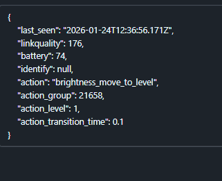

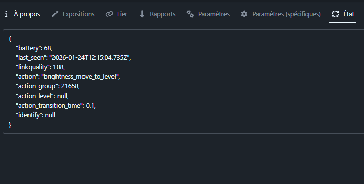

See that in state :
That in log when I go one side and other side :

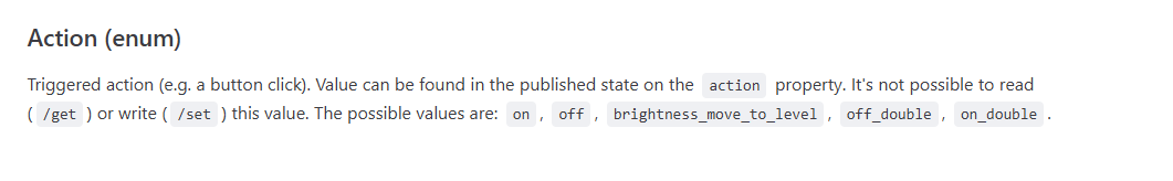

In Z2M documentation, the device has only those action :slight_smile:
Yeah, you are right… but why I got this log? :sweat_smile:

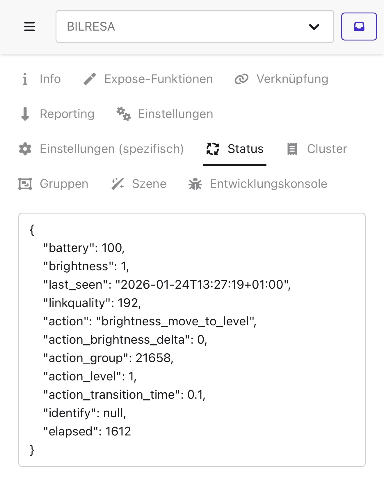

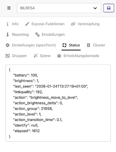

I got these states:
I will try to change the code, so the Automation will only react to Action_level
Just and another one and same thing :
Same firmware : 1.8.5

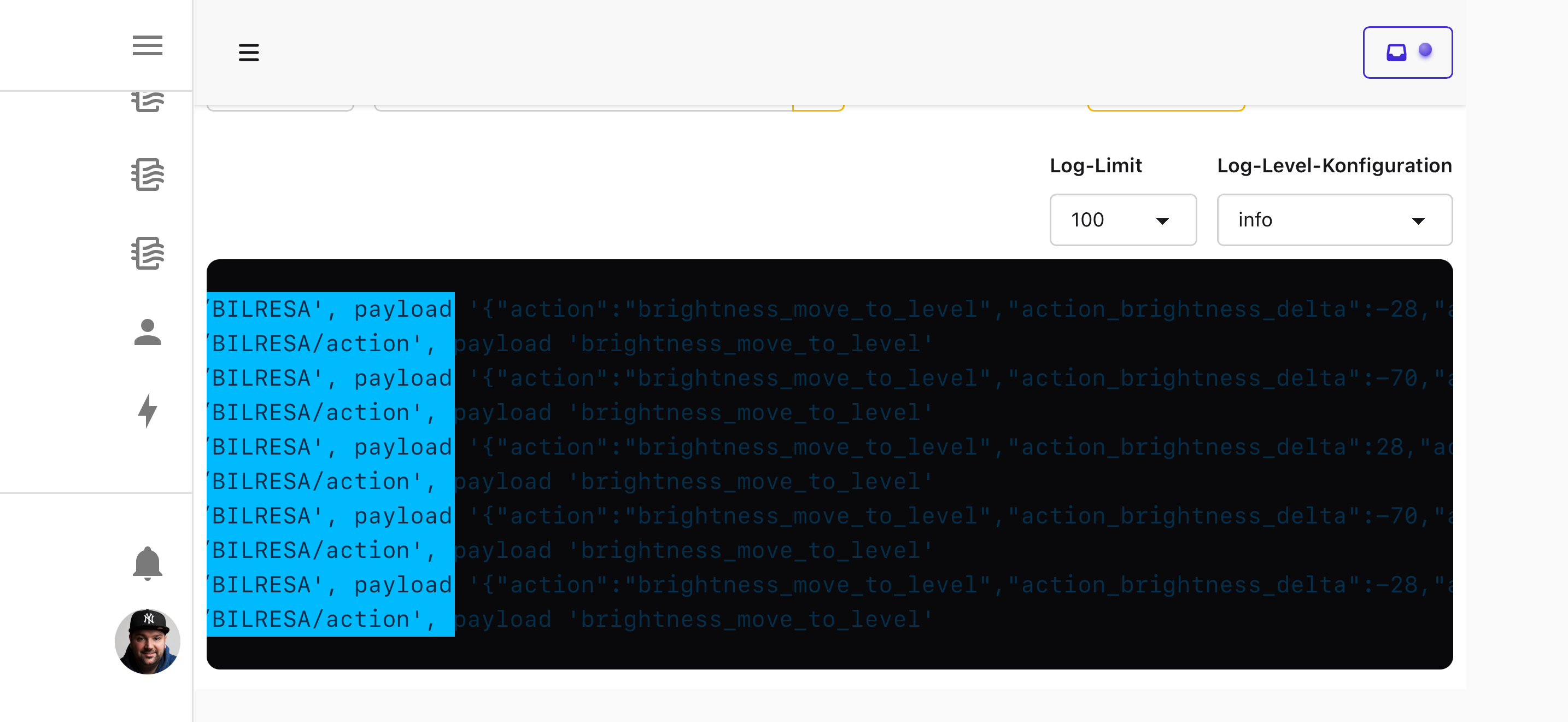

I set the simulated brightness to this value:
If it is activated it should add the State action_brightness_delta.
I fogot, that I have activated it :sweat_smile:
OK everything is alright. Thanks !
This works perfect.
