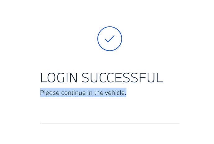

I must be doing something wrong but in the setup process I am stuck at point 12. I visit the provided URL but then it doesnt ask for any code. This is all I see on the prvided URL:
In the car it doesnt ask for anything. Can somebody help me out with this one?

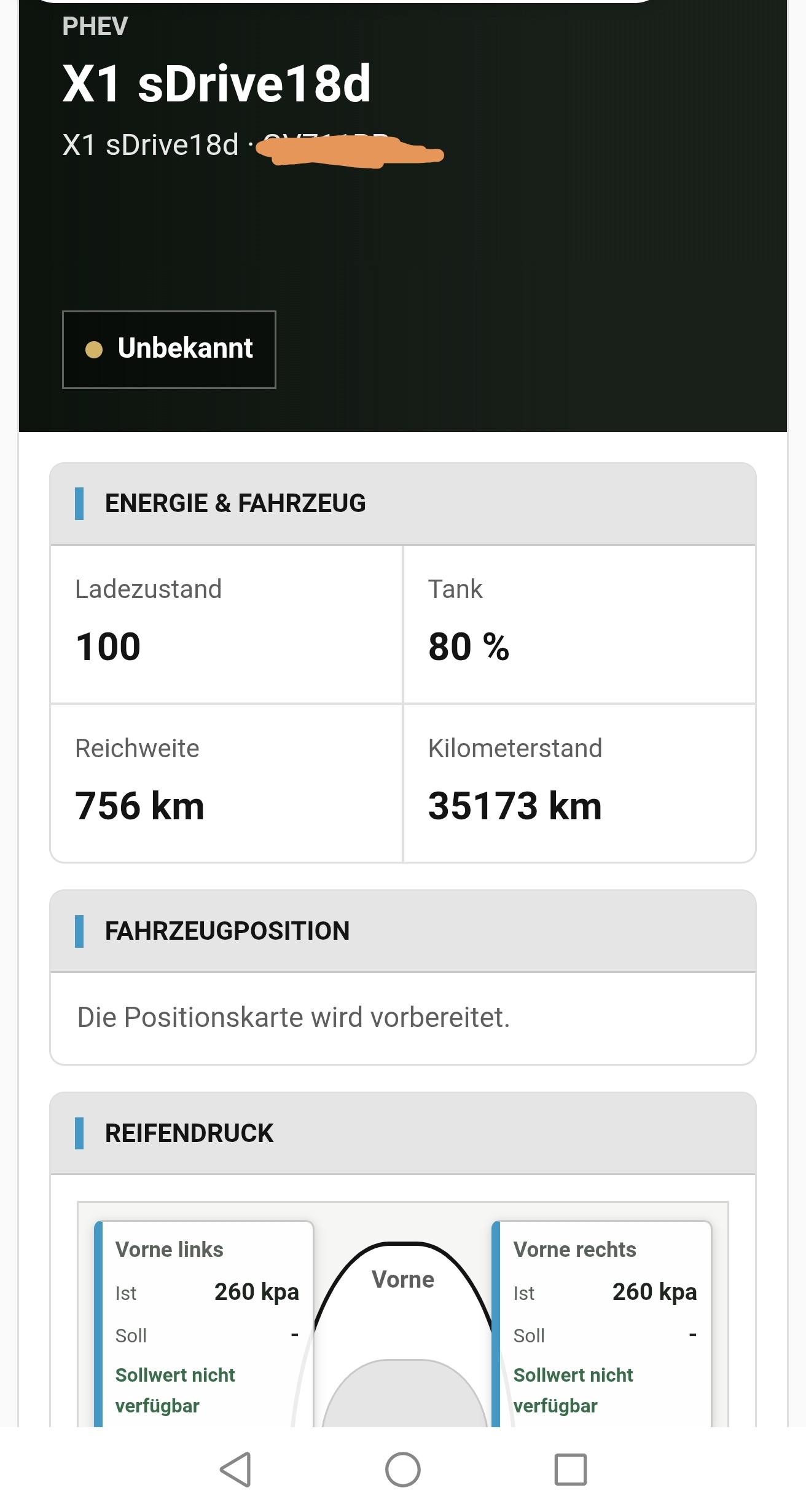

Hello, i have tried the card but I must have made mistakes with Api Keys during the flow configuration.
I have selected only Gemini and then it asks me another Api Key maybe the OpenAi one?
However the result is this (no image) and some info missing.
What can I do?
Thank you
