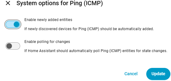

no I did not try. but found this :
and using
- action: homeassistant.update_entity
      entity_id:
        - binary_sensor.8_8_8_8
will this work?

Is this how ping configured for custom polling interval?: Ping (ICMP) - Home Assistant
Yes, like that.
