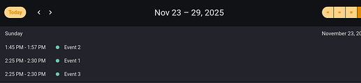

I’ve tested the sensors and they are working as expected for me:
