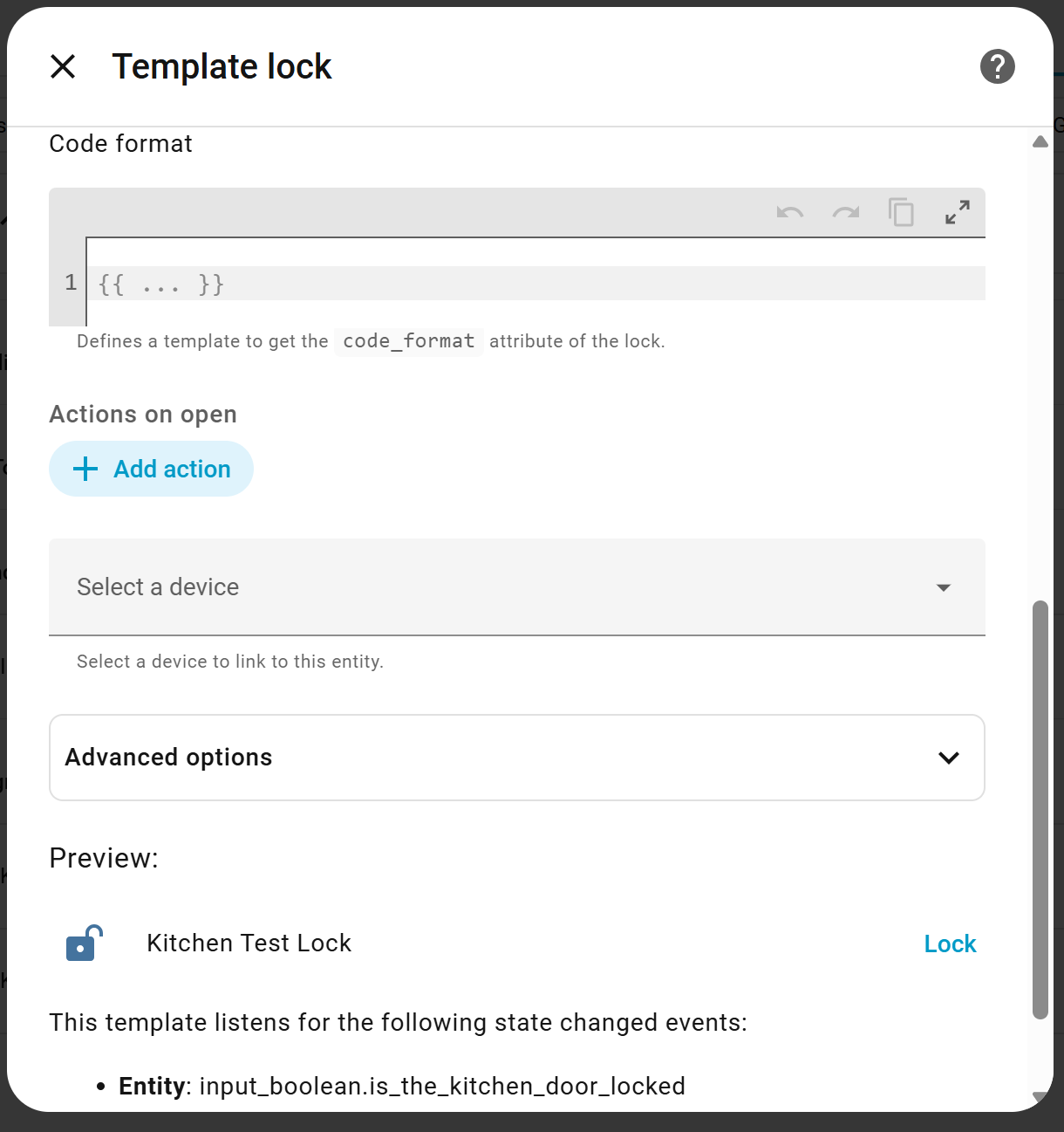

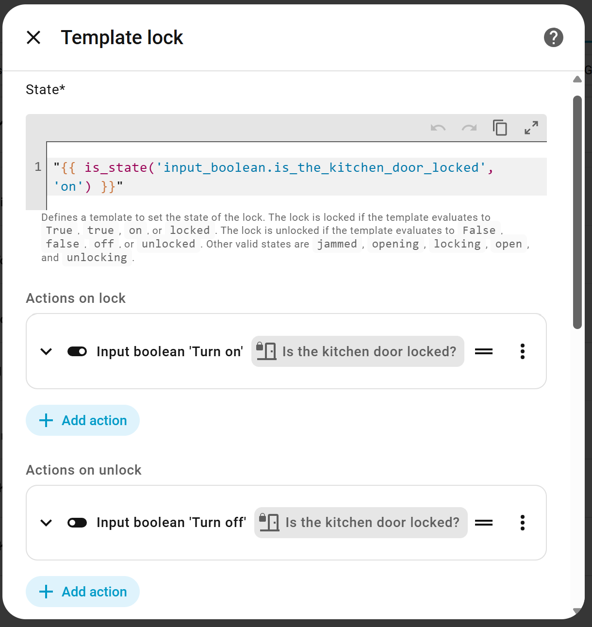

This is my partially working helper:
Both use the same boolean as a state. The helper Kitchen Door Test will turn the boolean On when I click Lock. But it does not maintain its state. If I set the Boolean to Off and click Lock on Kitchen Door Test, then Kitchen Door Lock switches to Locked (as expected), but Kitchen Door Test does not.
I’m not super concerned as the documentation does say it should be done by configuration yaml not in the GUI. It just seems odd and it would be nice if it worked (I prefer my helpers in the GUI).
The state template should not have the quotes around it. Those are for yaml only.
It works! Such a simple error. Thank you, I would have never worked that out on my own.
