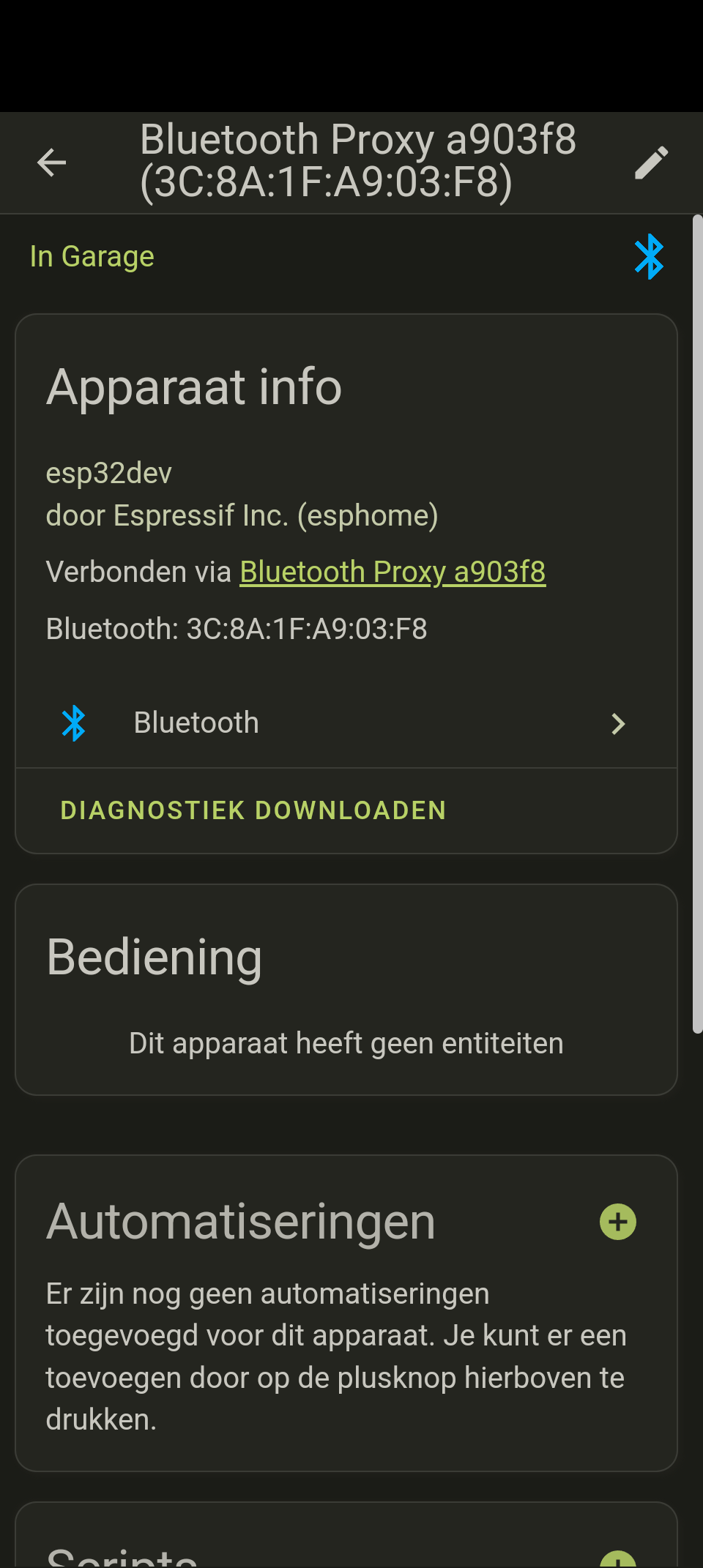

I have a esp32 by proxy and that’s working. When I try to install your integration, I get: “no supported devices found”. I have Seplos v3 bms and when I use their Bluetooth app, it connects to the bms. It’s also visible in the esp32 advertising monitor.
See attached screenshots.
Please follow the guideline and if it still does not work, post the output of the advertisement monitor. Probably, I need to adapt the auto detection.
The first screenshot is showing the bms on advertisement monitor.
See attached outcome of bluetoothctl devices.
Please click the correct device, i.e. the BMS and provide me that data using copy to clipboard .
{“name”:"CSY012405290042 ",“address”:“C0:D6:3C:4C:A5:B1”,“rssi”:-78,“manufacturer_data”:{},“service_data”:{},“service_uuids”:[“0000fff0-0000-1000-8000-00805f9b34fb”],“source”:“3C:8A:1F:A9:03:F8”,“connectable”:true,“time”:1742727695.8344843,“tx_power”:null}
@broekieman please see the corresponding ticket on Github.
