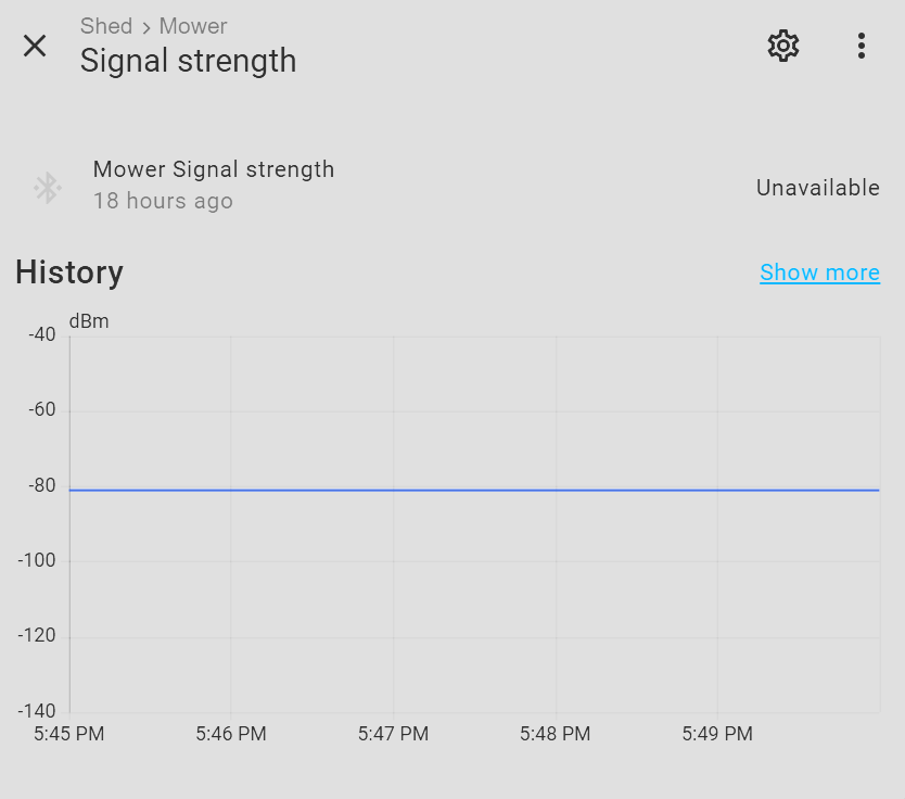

One issue I have is “Signal Strength” always reads “Unavailable”. The ESP32 is about 8feet from the router.

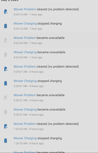

Another issues is this:
Not a huge deal but I wouldn’t mind fixing them.
Not sure why this is the case, actually the integration just takes what HA is reporting. Do you see an RSSI value in the Bluetooth monitor? If yes, you can raise a ticket on github. Please include a debug log.
Regarding the other issues (sensors going unavailable), this is most likely due to the Bluetooth connection being lost for some reason. Nothing the integration can influence. Please check the documentation of the Bluetooth integration for some hints: Bluetooth - Home Assistant

I do not see a value, or see it even listed there.
Well, as long as the integration is connected to the battery, the RSSI is not updated. It’s a bit strange that you do not have any, but there is absolutely no issue with that. You could temporarily disable the battery then it should appear. Still, I wouldn’t worry, it’s not at all essential. :smiley:
Heh, THIS is info I did not know, thanks! I’m not going to worry about it as you say - I have the info I need!
And this is what I see when I click on it.
That’s fine, a bit on the low side, but ok. It updates when the connection is lost. So if you click “show more” and change the time range, you should also see some changes.

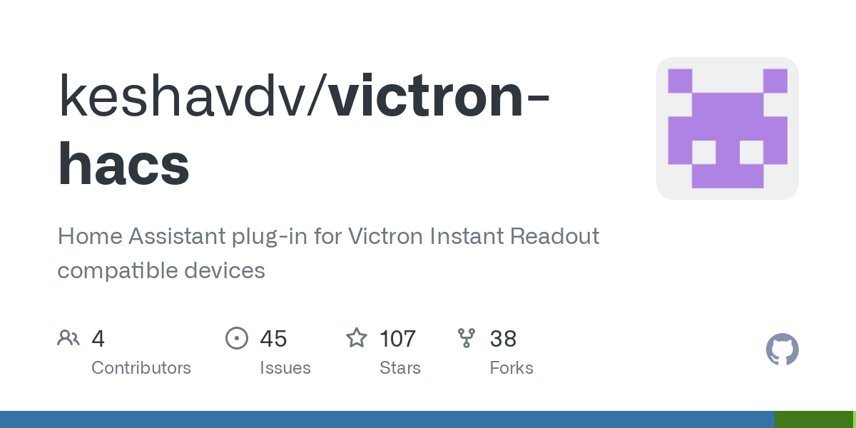

If you want to do a fork and add it on your own, you need to check whether the shunt uses active connections or broadcasts the information via the advertisement of BLE. If the second, my integration is the wrong starting point, i.e. for the Victron shunt. Btw. for this there is already an integration which can handle the advertisements:
