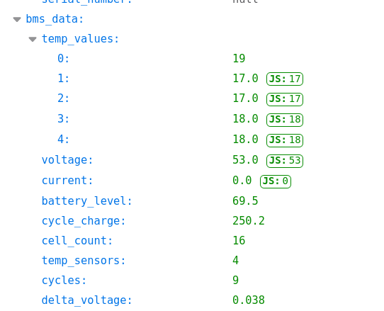

any idea if it’s also possible get the temperatures?
bms_data
temp_values
0 21
1 18.0JS:18
2 18.0JS:18
3 19.0JS:19
4 19.0JS:19
Sure, works similar way but the temperature sensor and the attribute there.
The data table looks a bit strange (is the value really 18.0JS:18?) Is this an issue?

I will try with the temperature readings, but I guess it is also a mixture of German and Englisch text. I also attach a screen shot of the diagnostic from the BLE unit.
this is my entry for reading the temperature, but it’s not working. Any hint ?
  • name: “BMS temp 1”
    state: “{{ state_attr(‘sensor.dl_41190601694b_temperatur’, ‘temp_values’)[1] }}”
    unit_of_measurement: ‘°C’
    state_class: measurement
    device_class: temperature
    availability: >-
    {{ has_value(‘sensor.dl_41190601694b_temperatur’) }}
Not sure if it will work with that formatting.
@Matthias1 the name of the attribute is wrong. The diagnosis data is the wrong place to look it up. Have a look at the sensor it self or the developer tools. The attribute is called temperature_sensors.

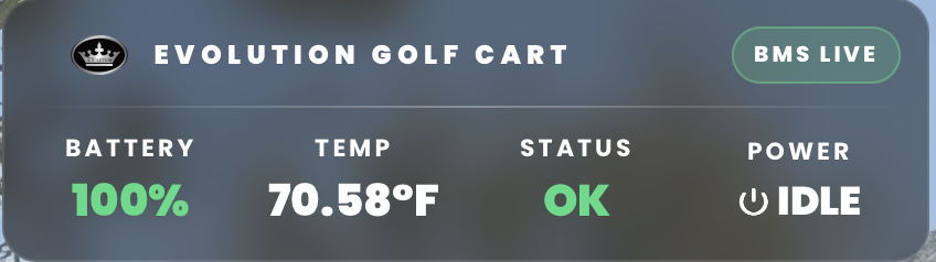

I put together a custom Home Assistant widget for my 48V lithium golf cart battery and figured I’d share in case anyone else is interested in doing something similar. The battery is a 48V 105Ah lithium pack with a 200A BMS (1000A peak), rated for 4000+ cycles, includes an 18A charger, touch monitor, and mobile app, and is also used in a solar setup. I’m pulling live BMS data via Bluetooth using an M5StickC PLUS2 (ESP32-PICO-V3-02) and forwarding it into Home Assistant over Wi-Fi (local only, no cloud). In HA I display battery percentage, temperature (to two decimals), charging vs idle state (with a pulsing animation when charging), BMS live/offline status, and OK/problem state with graceful handling when the cart disconnects. I’ve also added notifications for charger plug-in, battery reaching 100%, temperature hitting 110°F, status changes from OK → problem, and when the cart disconnects while the garage door is open so I know it left. It’s been rock solid so far and gives much better visibility than the stock app alone.
I just bought ogrphy LifePo4 Battery 105ah from amazon.
I used this to connect to the Bluetooth and it gave me all the info from the battery
