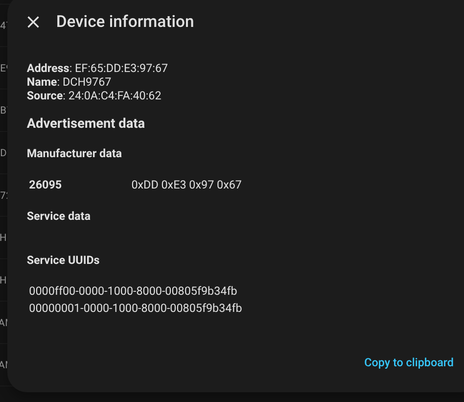

I have a DCHome Battery… but the Bluetooth isnd DCHOME but DCH with the last 4 characters from the mac address (ie. DCH9767) . I’m assuming this battery is using the same protocol. Here’s the Advertisemenbt
Please raise a ticket in the BMS_BLE repo and provide the information listed under additional context, e.g. link to an app you use. “DCHome” sounds like a new device, currently only “DCHouse” is supported.
