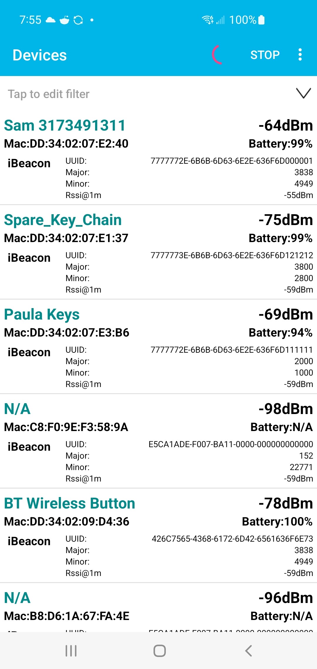

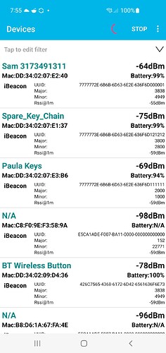

I dont think you have it set up right at all. Every type of wireless BT i’ve used, they use 2 and sometimes even more UUID’s because they can have the ability built-in for things like sending a unique UUID for single press, double press, press and hold etc
Do you have a BT beacon scanner app on your phone? I use Kbeacon Pro and its in the app store or play store and shows BT scans like this.
You should download a scanner and then check to see if
  1. Is the button broadcasting a UUID by default, even when its just sitting idle.
  2. When you press the button, does the UUID change to a different one?
  3. Check to see if your button has more capabilities than just being used to do a single function that’s one button press.

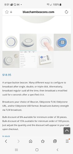

Here is one i use for example and see how it sais all the different button press combinations and then different ways to have the UUID broadcast based on how its pressed? Yours should be able to be configured similar to this and then however you configure it to transmit, thats the way you need to configure your esp32 ble tracker with 1 or multiple sensors for however many button combinations you configure. You may even be able to pick up additional information like it’s battery level and any other sensor values if it has them also.
