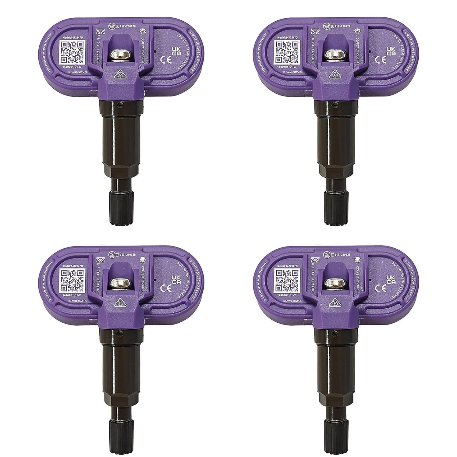

Do we know of those sensors advertised as being Tesla compatible will work? That’s what I seem to be able to easily purchase.
Do you have a link?
These:
I bought one to test with, just need to figure out to test it before ordering 11 of them for my 3500 and double axle trailer.
Why buy Tesla specified ones when they aren’t for a Tesla? More expensive too…
Anyway, I guess you’ll soon see if they work with ESPhome.
