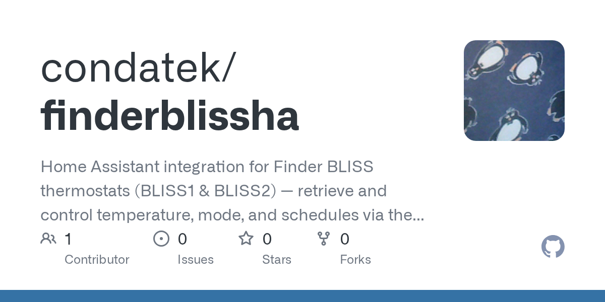

Hey everyone :wave:
Just wanted to share some exciting news — I’ve been working on a custom Home Assistant integration for Finder Bliss thermostats, called finderblissha :ice_cube::fire:
The integration is now in its first beta release, and it’s already able to:
  • Retrieve temperature, humidity, Wi-Fi, and battery level
  • Detect multiple thermostats (BLISS1 and BLISS2)
  • Show them as climate entities in Home Assistant
:warning: What’s still in progress:
  • The setters (changing mode or target temperature) are still under development
  • BLISS1 models may need more testing
  • Full async WebSocket handling will be improved in future versions
You can find it here on GitHub:
If you have Finder Bliss thermostats and want to help, please test it and share your feedback or issues — it will really help refine the integration.
The project is open source and built on top of a dedicated Python API library I’m developing in parallel (pyFinderBliss).
Thanks to everyone who showed interest in this topic — we’re finally getting closer to a native HA solution for Finder Bliss devices :raised_hands:
Hello! Thanks for the integration. I’m registered in the Bliss app with appleid… how could I access to this integration?
Update. I made a new account with email and pass
Hello, happy to know you are testing out and managed to access the integration! For anyone else wanting to try, if you have created an account for example with google or appleid, you need to go to: Finder Accounts - Login and then reset your password.
Thank you for your excellent work.
I have a Bliss model 1C.91 chronothermostat that I control via the ‘You’ app.
I tried your integration and it works great.
I hope you will be able to upgrade it so that we can also control the chronothermostat with HA.
Kind regards
Antonio
