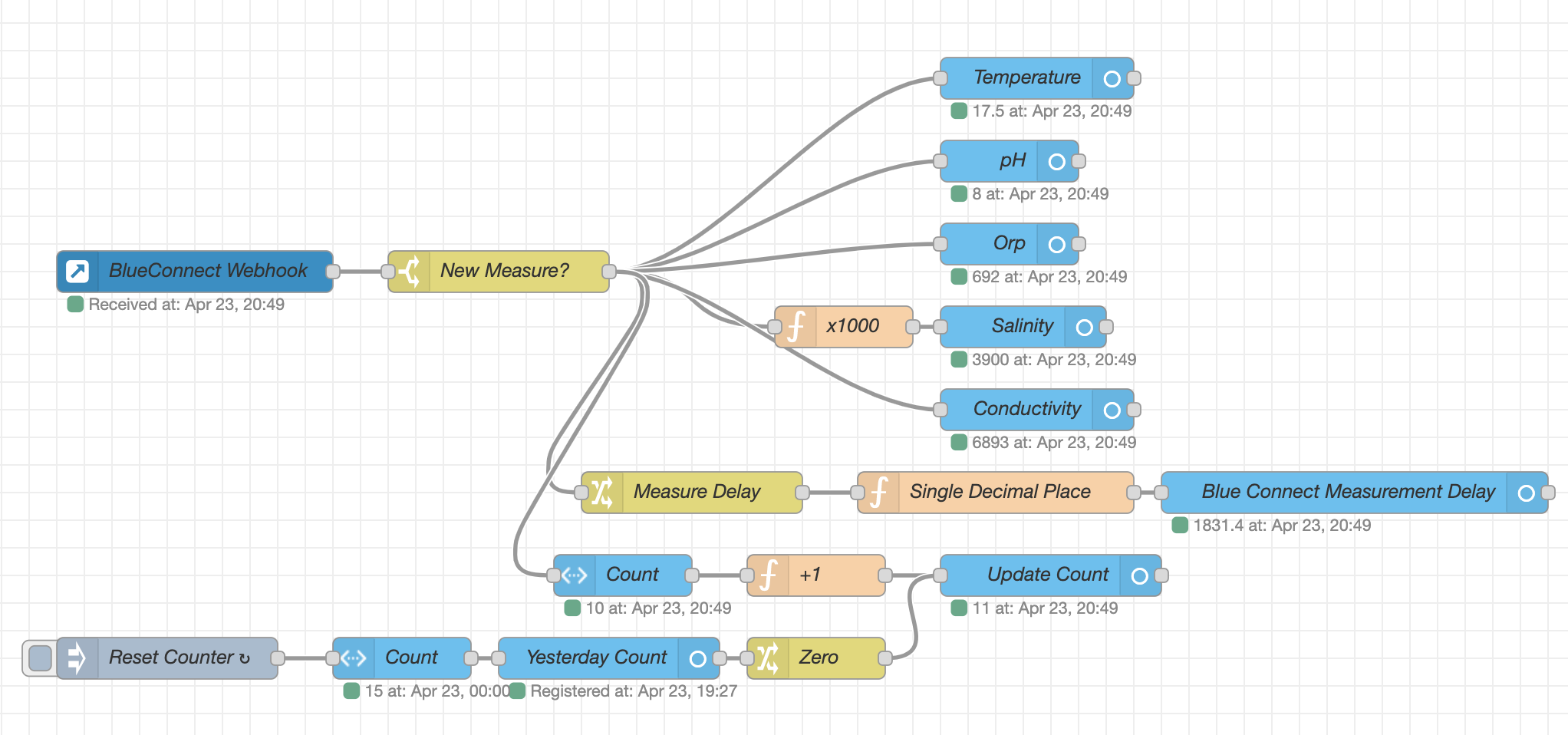

Here is the updated Node-Red JSON for my inbound data flow…
[{"id":"a2345807.bbc9c8","type":"ha-webhook","z":"1bb50542.81126b","name":"BlueConnect Webhook","server":"a23a4d01.eeb32","outputs":1,"webhookId":"blue_connect","payloadLocation":"payload","payloadLocationType":"msg","headersLocation":"","headersLocationType":"none","x":180,"y":320,"wires":[["ebc5b5a.3c2a248"]]},{"id":"ebc5b5a.3c2a248","type":"switch","z":"1bb50542.81126b","name":"New Measure?","property":"payload.time","propertyType":"msg","rules":[{"t":"neq","v":"","vt":"prev"}],"checkall":"true","repair":false,"outputs":1,"x":400,"y":320,"wires":[["d2c85e6f.f164e","3770976e.784fb8","5f5d6f7f.8c305","dae8675e.10b038","747b5a26.135d64","b048c2c3.9025d","7d0176e9.094a18"]]},{"id":"d2c85e6f.f164e","type":"function","z":"1bb50542.81126b","name":"x1000","func":"var x=Number(msg.payload.salinity)\nmsg.payload.salinity=x*1000\nreturn msg;","outputs":1,"noerr":0,"x":650,"y":360,"wires":[["f38fab54.5fe968"]]},{"id":"3770976e.784fb8","type":"change","z":"1bb50542.81126b","name":"Measure Delay","rules":[{"t":"set","p":"payload","pt":"msg","to":"(\t   $toMillis($now()) - $toMillis(\t       payload.time,\t       '[D01]/[M01]/[Y0001] [H01]:[m01]:[s01]' \t   )\t)/1000\t","tot":"jsonata"}],"action":"","property":"","from":"","to":"","reg":false,"x":540,"y":480,"wires":[["a256dbf0.03bb48"]]},{"id":"6424dda6.4cc674","type":"ha-entity","z":"1bb50542.81126b","name":"Blue Connect Measurement Delay","server":"a23a4d01.eeb32","version":1,"debugenabled":false,"outputs":1,"entityType":"sensor","config":[{"property":"name","value":"Blue Connect Measurement Delay"},{"property":"device_class","value":""},{"property":"icon","value":""},{"property":"unit_of_measurement","value":"s"}],"state":"payload","stateType":"msg","attributes":[],"resend":true,"outputLocation":"","outputLocationType":"none","inputOverride":"allow","x":1020,"y":480,"wires":[[]]},{"id":"5f5d6f7f.8c305","type":"ha-entity","z":"1bb50542.81126b","name":"Temperature","server":"a23a4d01.eeb32","version":1,"debugenabled":false,"outputs":1,"entityType":"sensor","config":[{"property":"name","value":"pool_temperature"},{"property":"device_class","value":"temperature"},{"property":"icon","value":""},{"property":"unit_of_measurement","value":"°C"}],"state":"payload.temperature","stateType":"msg","attributes":[],"resend":true,"outputLocation":"payload","outputLocationType":"msg","inputOverride":"allow","x":790,"y":180,"wires":[[]]},{"id":"dae8675e.10b038","type":"ha-entity","z":"1bb50542.81126b","name":"pH","server":"a23a4d01.eeb32","version":1,"debugenabled":false,"outputs":1,"entityType":"sensor","config":[{"property":"name","value":"pool_ph"},{"property":"device_class","value":""},{"property":"icon","value":""},{"property":"unit_of_measurement","value":"pH"}],"state":"payload.ph","stateType":"msg","attributes":[],"resend":true,"outputLocation":"","outputLocationType":"none","inputOverride":"allow","x":770,"y":240,"wires":[[]]},{"id":"747b5a26.135d64","type":"ha-entity","z":"1bb50542.81126b","name":"Orp","server":"a23a4d01.eeb32","version":1,"debugenabled":false,"outputs":1,"entityType":"sensor","config":[{"property":"name","value":"pool_orp"},{"property":"device_class","value":""},{"property":"icon","value":""},{"property":"unit_of_measurement","value":"mV"}],"state":"payload.orp","stateType":"msg","attributes":[],"resend":true,"outputLocation":"","outputLocationType":"none","inputOverride":"allow","x":770,"y":300,"wires":[[]]},{"id":"f38fab54.5fe968","type":"ha-entity","z":"1bb50542.81126b","name":"Salinity","server":"a23a4d01.eeb32","version":1,"debugenabled":false,"outputs":1,"entityType":"sensor","config":[{"property":"name","value":"pool_salinity"},{"property":"device_class","value":""},{"property":"icon","value":""},{"property":"unit_of_measurement","value":"ppm"}],"state":"payload.salinity","stateType":"msg","attributes":[],"resend":true,"outputLocation":"","outputLocationType":"none","inputOverride":"allow","x":780,"y":360,"wires":[[]]},{"id":"b048c2c3.9025d","type":"ha-entity","z":"1bb50542.81126b","name":"Conductivity","server":"a23a4d01.eeb32","version":1,"debugenabled":false,"outputs":1,"entityType":"sensor","config":[{"property":"name","value":"pool_conductivity"},{"property":"device_class","value":""},{"property":"icon","value":""},{"property":"unit_of_measurement","value":"mho"}],"state":"payload.conductivity","stateType":"msg","attributes":[],"resend":true,"outputLocation":"","outputLocationType":"none","inputOverride":"allow","x":790,"y":420,"wires":[[]]},{"id":"2e3b8fff.7ed07","type":"ha-entity","z":"1bb50542.81126b","name":"Update Count","server":"a23a4d01.eeb32","version":1,"debugenabled":false,"outputs":1,"entityType":"sensor","config":[{"property":"name","value":"Blue Connect Update Count"},{"property":"device_class","value":""},{"property":"icon","value":""},{"property":"unit_of_measurement","value":""}],"state":"payload","stateType":"msg","attributes":[],"resend":true,"outputLocation":"","outputLocationType":"none","inputOverride":"allow","x":800,"y":540,"wires":[[]]},{"id":"7d0176e9.094a18","type":"api-current-state","z":"1bb50542.81126b","name":"Count","server":"a23a4d01.eeb32","version":1,"outputs":1,"halt_if":"","halt_if_type":"num","halt_if_compare":"is","override_topic":false,"entity_id":"sensor.blue_connect_update_count","state_type":"num","state_location":"payload","override_payload":"msg","entity_location":"data","override_data":"msg","blockInputOverrides":false,"x":490,"y":540,"wires":[["b94912c.85ab7f"]]},{"id":"b94912c.85ab7f","type":"function","z":"1bb50542.81126b","name":"+1","func":"var x=Number(msg.payload)\nmsg.payload=x+1\nreturn msg;","outputs":1,"noerr":0,"x":630,"y":540,"wires":[["2e3b8fff.7ed07"]]},{"id":"88995690.f6b7b8","type":"inject","z":"1bb50542.81126b","name":"Reset Counter","topic":"","payload":"0","payloadType":"num","repeat":"","crontab":"00 00 * * *","once":false,"onceDelay":0.1,"x":160,"y":600,"wires":[["5230267f.9a7e68"]]},{"id":"a256dbf0.03bb48","type":"function","z":"1bb50542.81126b","name":"Single Decimal Place","func":"var x = Number(msg.payload)\n\nmsg.payload = x.toFixed(1)\nreturn msg;","outputs":1,"noerr":0,"x":760,"y":480,"wires":[["6424dda6.4cc674"]]},{"id":"c22f216.ef67ae","type":"ha-entity","z":"1bb50542.81126b","name":"Yesterday Count","server":"a23a4d01.eeb32","version":1,"debugenabled":false,"outputs":1,"entityType":"sensor","config":[{"property":"name","value":"Blue Connect Updates Yesterday"},{"property":"device_class","value":""},{"property":"icon","value":""},{"property":"unit_of_measurement","value":""}],"state":"payload","stateType":"msg","attributes":[],"resend":true,"outputLocation":"","outputLocationType":"none","inputOverride":"allow","x":480,"y":600,"wires":[["8215815e.5dfc2"]]},{"id":"5230267f.9a7e68","type":"api-current-state","z":"1bb50542.81126b","name":"Count","server":"a23a4d01.eeb32","version":1,"outputs":1,"halt_if":"","halt_if_type":"num","halt_if_compare":"is","override_topic":false,"entity_id":"sensor.blue_connect_update_count","state_type":"num","state_location":"payload","override_payload":"msg","entity_location":"data","override_data":"msg","blockInputOverrides":false,"x":330,"y":600,"wires":[["c22f216.ef67ae"]]},{"id":"8215815e.5dfc2","type":"change","z":"1bb50542.81126b","name":"Zero","rules":[{"t":"set","p":"payload","pt":"msg","to":"0","tot":"num"}],"action":"","property":"","from":"","to":"","reg":false,"x":630,"y":600,"wires":[["2e3b8fff.7ed07"]]},{"id":"a23a4d01.eeb32","type":"server","z":"","name":"Home Assistant"}]
One thing we noticed when I was helping a friend set his up using my exported JSON, is that for the HA nodes, we needed to go in and change the server name from “Home Assistant” to “Home Assistant”!!
I’m assuming there is some hidden id in play, and the imported “Home Assistant” which was selected was not the correct one.
The flow now looks like this…
It depends on having not just the node red addon installed, but also the integration installed (via HACS) and configured. I no longer use the “input-numbers” as NR can now create sensors directly in HA which is great.
As a previous poster mentioned, after deploying this flow, you’ll need to go into HA config and find the webhook that has been created. I use Nabu Casa cloud for this inbound webhook so it’s auto-created, but you could also port-map your HA server from the outside world.
Hope that helps

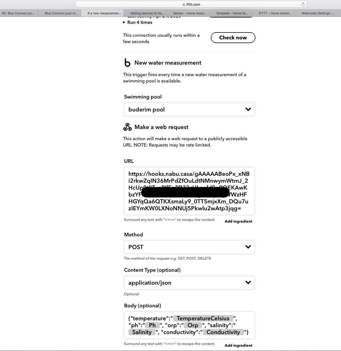

The IFTTT part looks to be working but my automation doesn’t seem to have been triggered.
I’m assuming my casa URL below is doing the same thing in calling my HA server:
My automation.blue_connect_data_update shows last_triggered: null and there aren’t any instances of webhook or IFTTT in my log.
The automation I have was from dan’s post above which looks inline with the advice from Riccardo:

@thetastate Did you check if this is triggering the automation?
curl -H 'Content-Type: application/json' -X POST -d '{ "temperature":"16.4" }' https://hooks.nabu.casa/everything-else

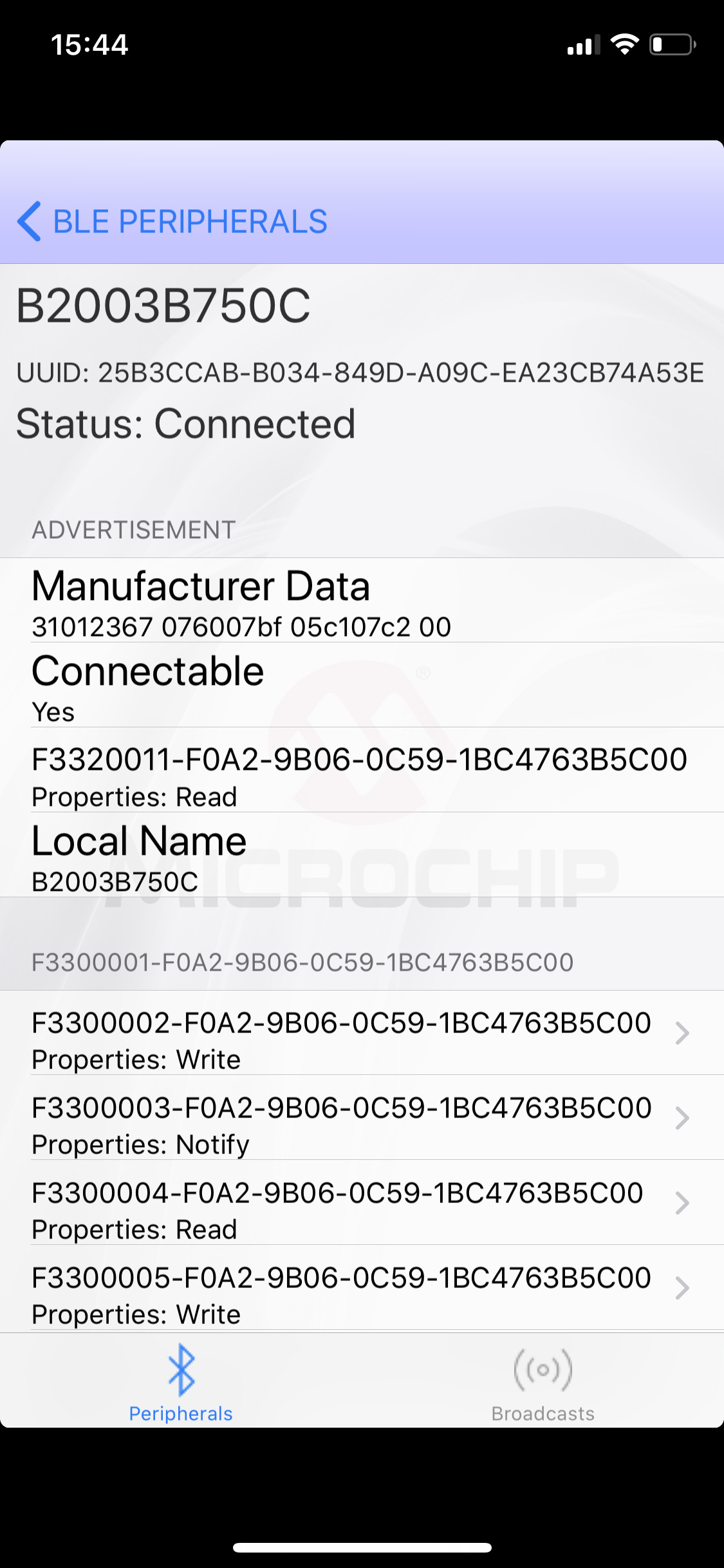

You may try to scan the device with a bluetooth app and see if it advertise service data like below:
If it is the case, there is a possibility that we could use these data directly from the sensor.
I am quite certain that this would be possible, as I can use my iPhone to request and receive a reading. The phone and blue connect communicates over Bluetooth. But has someone experience for how to understand Bluetooth protocols? Is there a Bluetooth “hub” that integrates with Home Assistant?
You can use either the embedded bluetooth chip of a Pi or an ESP32
Yes I have
I’ve just checked. It is advertising services
Cool! I assume a BLE integration needs to firstly send a command to the blue connect to perform a reading and then listen to it. Good thing that using BLE would allow for custom intervals of the reading polls, eg, every 30 mins instead of approx hourly with sigfox.
If you scroll down do you see some fields called “service data” like in my example?
Thanks @rzulian and @danps
All working now.
It turns out that I needed to enable the blue connect webhook in Configuration > Home Assistant Cloud > Webhooks > Blue Connect Data Update (automation).

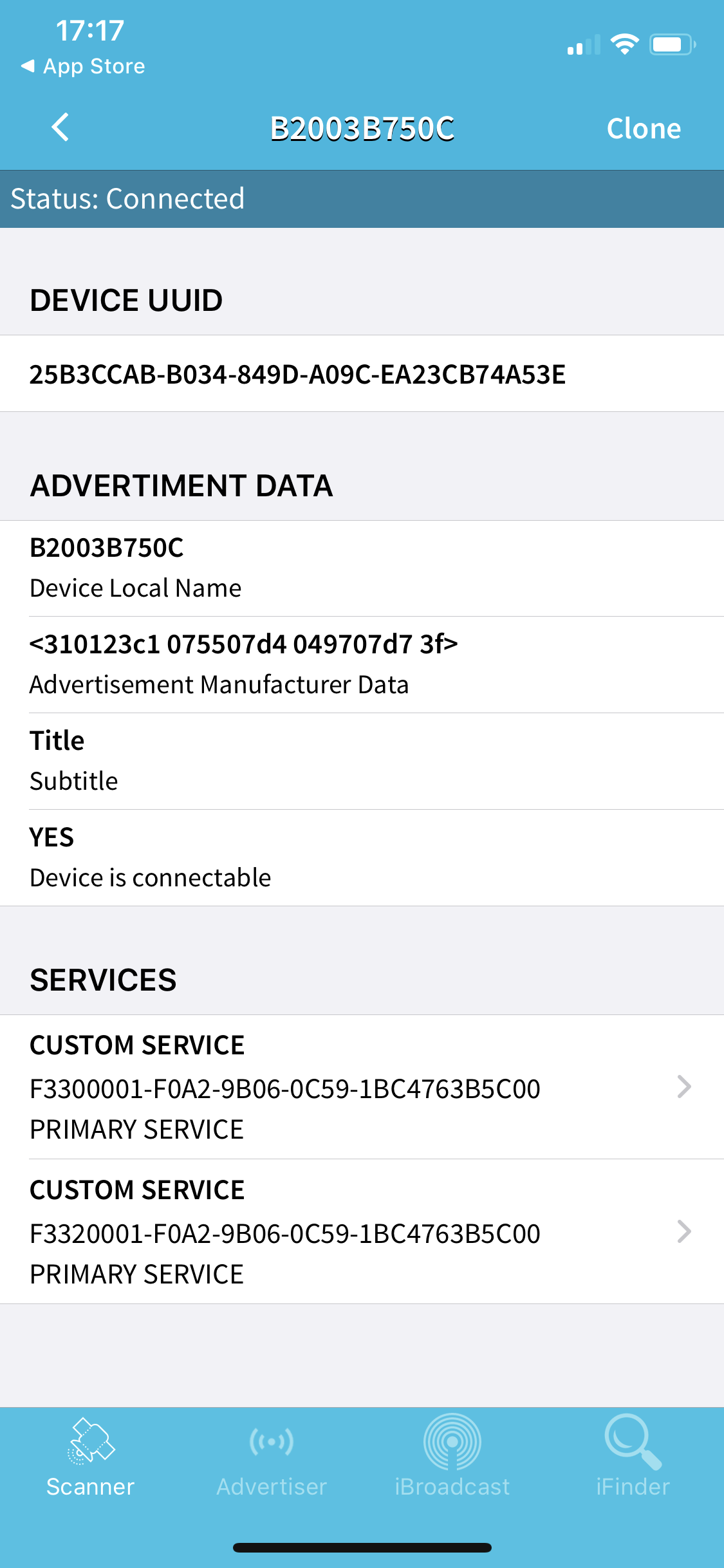

This is what I’ve got with another app
