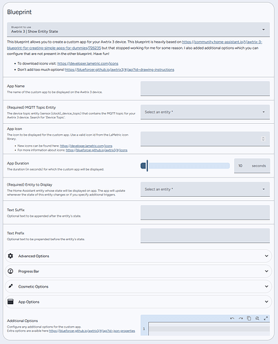

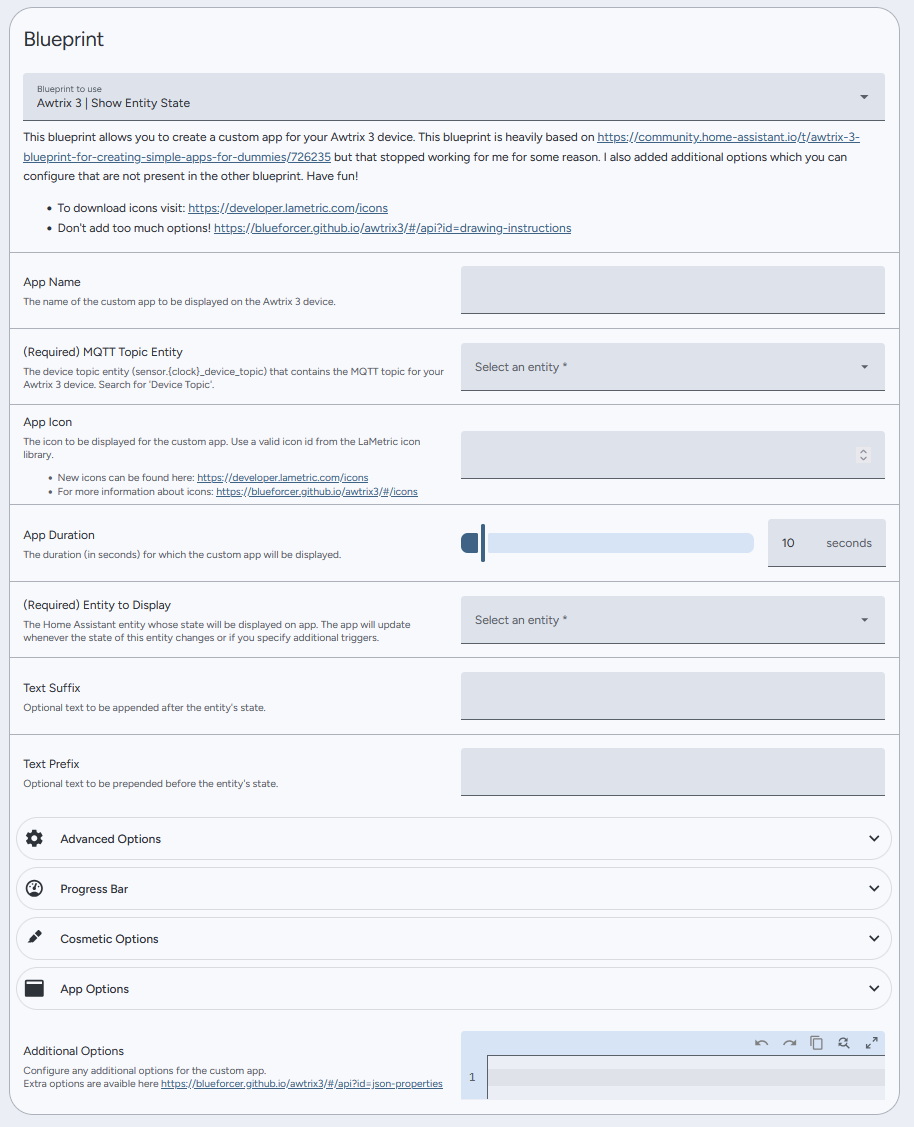

Hi, thx for the nice blueprint. But unfortuantly I do not have the possibility to add an Icon.
See screenshot
Hello There! I have changed it in the gist, so it should work now. Sorry for the long reply.
Technical details:
Changed default app_icon to 0
Hi, Downloaded the blueprint from the link button top of the page. But no change. Is the link correct? or can you provide the correct one. Thx
If you change the app_icon section in the blueprint to this, it will work. Make sure you have downloaded the icon from LaMetric and upload it to you device.
app_icon:
  description: "The icon to be displayed for the custom app. Use a valid icon
    id from the LaMetric icon library.\n - New icons can be found here: https://developer.lametric.com/icons\n
    - For more information about icons: https://blueforcer.github.io/awtrix3/#/icons"
  default: ""
  selector:
    text:
      multiline: false
      multiple: false

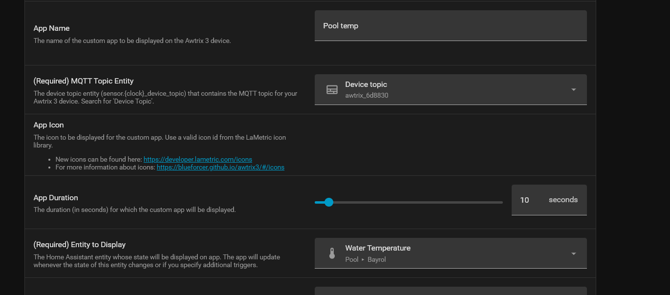

When I create two apps, only one appears on the Awtrix clock.
I want to display two different temperatures.
Perhaps you have used the same app name on both the automations? For each different entity you want to show you should use a different name unless you for example want to show the highest temperature only. If you can, please provide me the configuration for the two automations if what I mentioned above didn’t fix the issue
