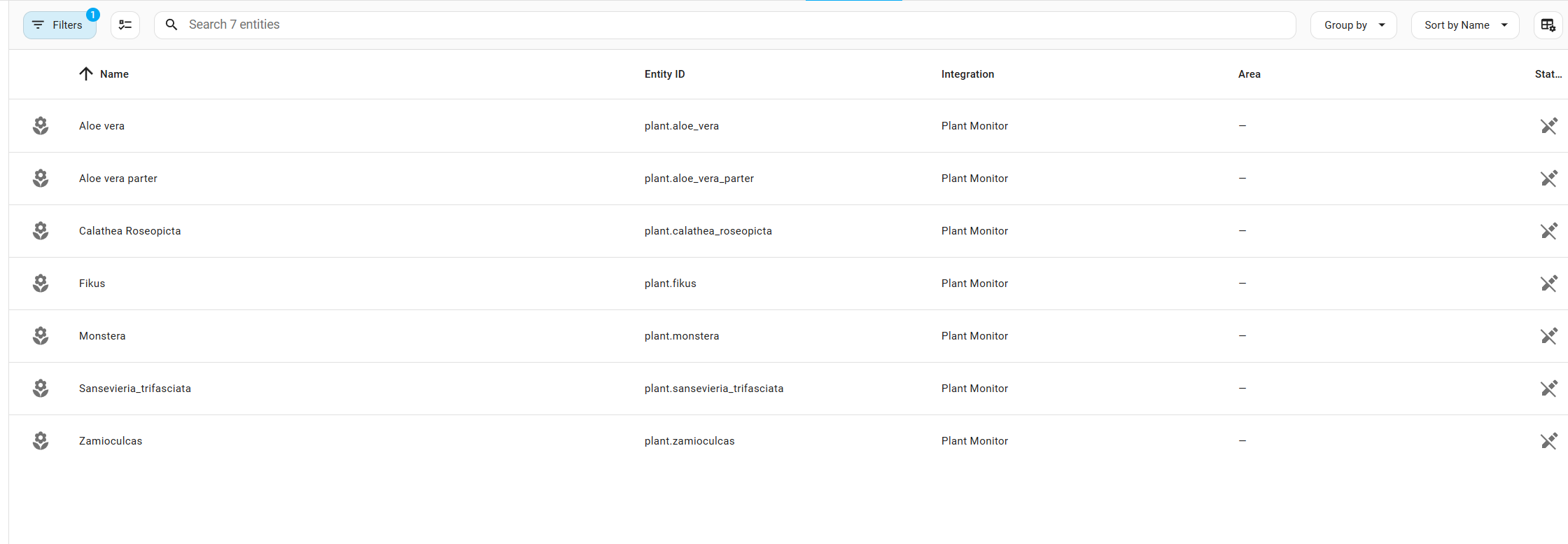

Blueprint for monitoring plants
So i made a somewhat complicated blueprint to use togeather with the Plant Monitor integration that reports the status of the plants that needs water and/or nutritions.
You can also activate if you want it to send a notification when the temp is out of range.
(for some reason the bool switches don’t work to turn off. Once they are turned on they will stay on so if you want to turn them off you have to edit the automation in yaml mode and change the true to false)
To use all the features you need the following:
  • Plant Monitor integration
  • Sensors for the flowers that have Temperature, Soil moisture and Conductivity (like the MiFlora)
  • To have the “Home” integration from Met.no with the houerly sensor enabled.

Its not working. Looks like it’s not finding any plants because i have blank exclude form
