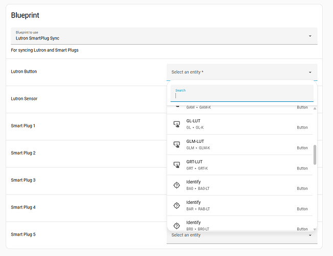

I’ve got a Blueprint that I have created. It is working really well.
The one issue annoyance is that in my Automation form, for the “lutron_target” button, buttons from other devices can be selected. How can I limit this to just Lutron buttons and not include buttons from other entities? The “Indentify” buttons in the below image are from Matter smart plugs and should not be available to select on this menu list. The xxx-LUT Buttopns are the Lutron buttons and the only ones I’d like to be able to select.
Is there a way to filter by “Integration”?
Thanks!

Add property ‘integration’ for filter
selector:
        entity:
          domain:
            - button
          integration: lutron
Excellent, thank you!
