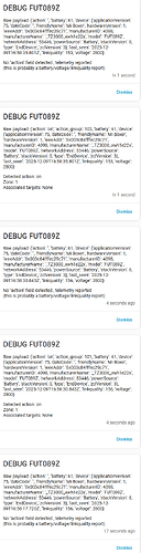

I have configured several lamps, and regardless of which button I press, the result is the same and nothing happens.
Unknown trigger
Hello thanks to use this bleuprint,
can you share your automation please ?
And the the Mqtt config if your rc, you may found it at device level, Mqtt entry on the left :slight_smile:
Cheers

Thanks, but…
Hi Lionel,
To avoid notifications becoming too long and cluttering the screen or database, the easiest solution is to turn off Debug mode in the blueprint.
Here’s what you should do:
1. Open the blueprint configuration in Home Assistant.
2. Set the Debug option to Off.
3. Reload the automation so the change takes effect.
This way, the remote control will work normally, and you won’t get massive notifications.
When you need to test or diagnose an issue, you can temporarily turn Debug back on.
Thanks!

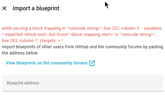

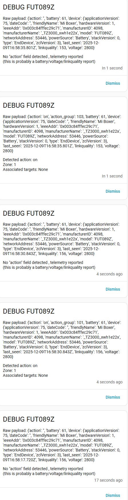

Thank you, but I pasted this screenshot because it doesn’t work…
Hi @Canaletto @Khzd

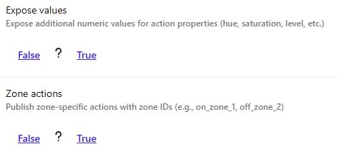

It looks like you’re running into the same issue I had — the action_group values range from 101 to 108, and they don’t come through as part of trigger.payload_json.action, but instead appear under trigger.payload_json.action_group.
I’ve gone ahead and modified Khzd’s code so that it works for me. I’m sharing it here in the hope that it will help you as well, and that Khzd might adapt it for our devices too.

Hello thanks for clarification
I see this
30
“action”: “on_zone_8”,
“action_group”: 108,
“battery”: 100,
“color_temperature”: 184,
“hue”: 189,
“last_seen”: “2025-12-10T01:05:30+01:00”,
“level”: 236,
“linkquality”: 134,
“saturation”: 254,
“voltage”: 3000
So I have in both action and action_group the zone, do you notice the same from your remote ? Sure we have different release of the rc, I got mine recently , what about yours ?

Hi all
Quick update about the MiBoxer remote and the blueprint:
The situation:
• In Z2M → Devices → Specific Parameters, there’s a toggle “Publish zone-specific actions with zone IDs”.
• If this toggle is ON, action is normalized like on_zone_1, off_zone_2, etc.
• If the toggle is OFF, action stays pure (on / off / brightness_move_to_level…), and the zone is only available via action_group.
What we did in the new blueprint version:
• We always normalize the action (act) so it’s consistent: on, off, brightness_move_to_level, color_temperature_move, etc.
• The triggered zone is reliably determined from action_group, which works regardless of the toggle.
• Debug mode is kept for testing, giving clear logs for actions and zones.
So now, whatever your Z2M toggle setting, the blueprint handles actions and zones consistently, including brightness and color changes.
Thanks for your feedback—it helped us simplify and make everything more robust
The new release is published soon and cover both cases
Your feedback is a gift :wink:

Hello
So probably you didn’t change it, this is default behavior, for my side I did change the option.
Did you reload the blueprint, what is your feed back ?
Cheers
Good evening,
I tried to re-import it without much success…
Hello
Thanks for your feed back
I checked again and have a difference with my local version, I update the git with mine ( which upload without error )
Please give a try
