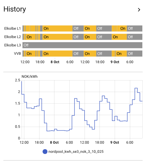

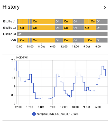

I have also modified it with minimum hours.
It controls a script for turning on/off L1, L2 and L3 in my cabin using Shelly equipment.
