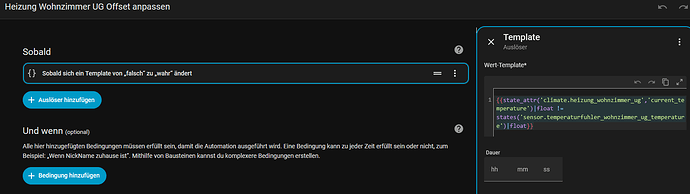

I hope someone here can help me. I’m trying to create a blueprint, and the action works, but unfortunately the trigger doesn’t.
I suspect my variables are the problem, but no matter how I try, I can’t get it to execute automatically.
Is there a way to test a blueprint, similar to the developer tools?
Or does anyone know where my mistake is and can help me get started?

Your variables seem okay, it’s the trigger that is the problem. A Template trigger only fires when it’s rendered value changes from false to true. You’ve created a trigger that will almost never be false

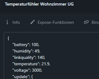

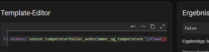

Thank you for your reply.
I simulate the false by manually triggering the automation and then set the external thermometer to the heater. The temperature changes, the value becomes true, but the trigger is not activated—I’ve been sitting here testing it for half the day.
Nothing helps—if only I could test the blueprint in the developer tools, that would definitely help me.
