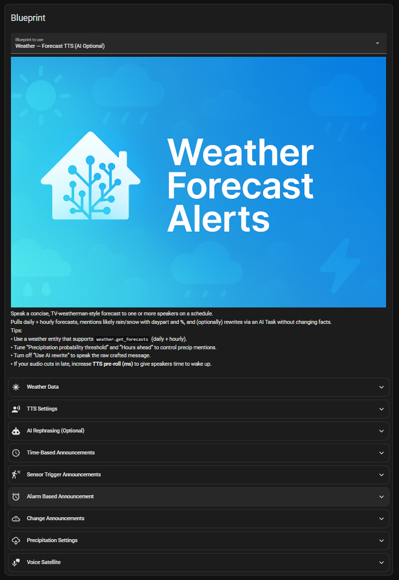

[Blueprint] Weather Forecast Alerts (TTS + Optional AI & Optional Iphone Alarm Integration ) Your Own In home Weatherman
No Additional Weather Integration Needed & Ai is Optional!
This automation uses the weather entity built into home assistant to read weather forecast alerts with option choice to pass the response through an ai of your choice. Took me a while to figure out the weather entity but hope you enjoy this automation. I notice people were having trouble doing this so here it is!
Feature highlights
  • :stopwatch: Schedule: Time pattern (e.g., every hour at :03), with active hours and weekdays.
  • :thermometer: Smart summary: Current condition, temp, humidity, today’s high/low.
  • :umbrella: Precip timing: Scans upcoming hours; mentions first hour ≥ threshold with daypart, time, and %.
  • :brain: AI (optional): Rewrites the message with strict “don’t change facts” rules.
  • :loud_sound: Per-speaker pre-roll: Insert 0–300 ms silence before speaking to avoid choppy starts.
  • :speaking_head: TTS-friendly: Works great with tts.piper; voice selectable (e.g., en_US-carlin-high).

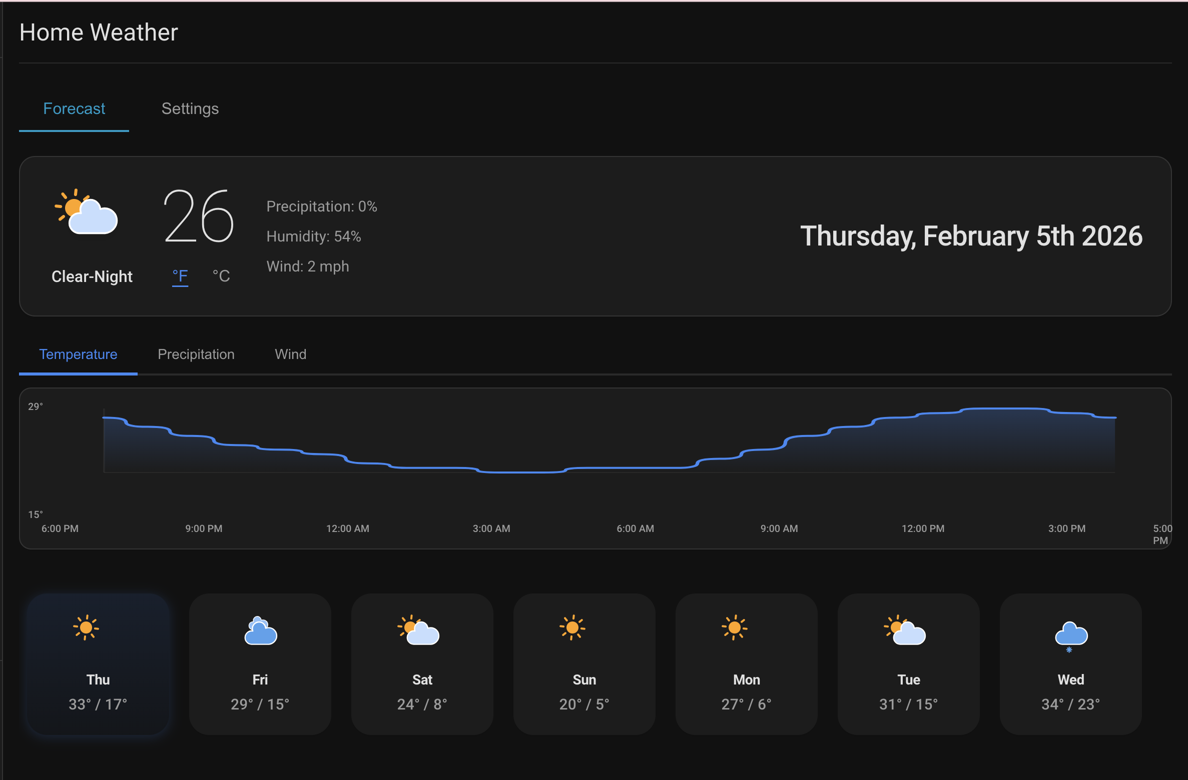

Preview (example output)
“Good evening! Saturday’s forecast. Right now: Clear night, 58°, humidity 75%. Expect sunny. High 70°. Low 58°. Rain chances this afternoon around 3 PM: 60%.”
(Exact numbers/times depend on your weather provider.)

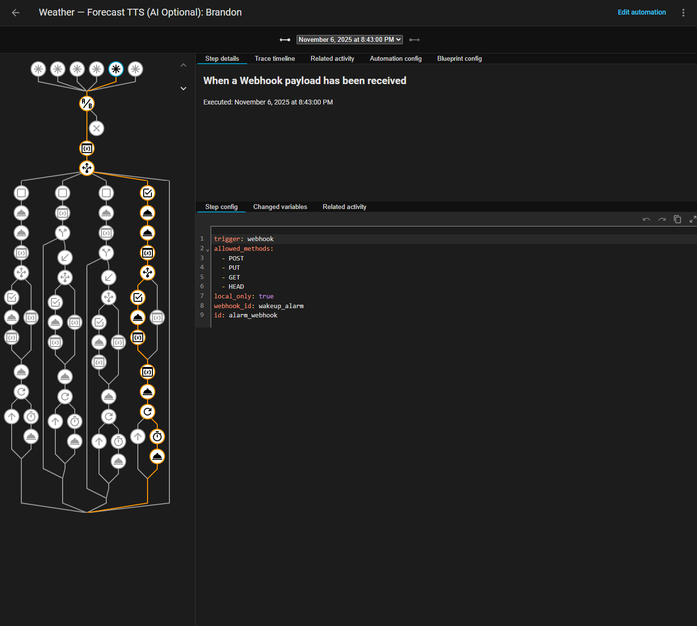

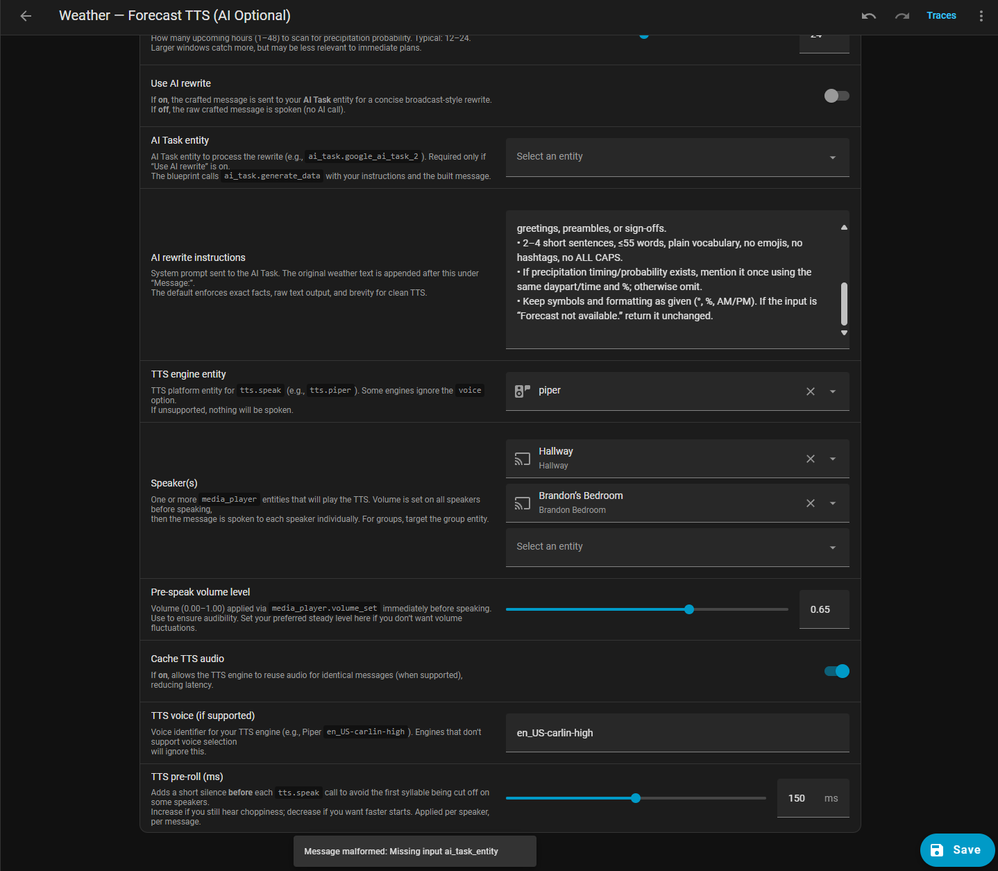

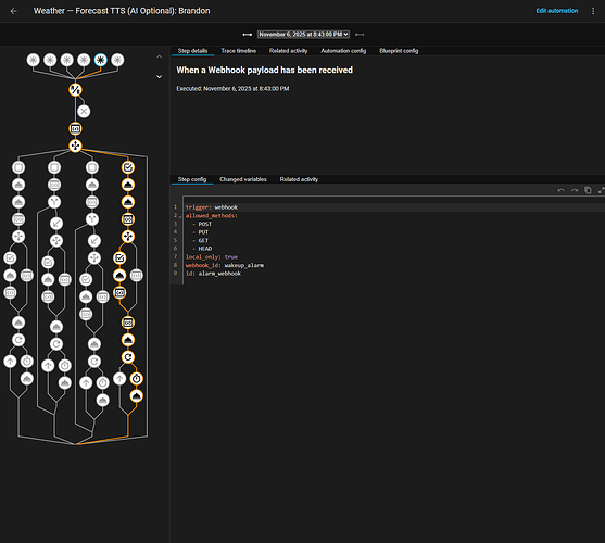

Looks very promising! I “installed”, but I think you are missing an error trap…I turned the “AI rewrite” switch off, but entered all the other inputs correctly…and get the error message “Message Malformed: Missing input ai_task_entry”…
While using the ai mode its very fine you can use Google Gemini’s API which is free for the meantime.
Ill diagnose it today and fix it, sorry for inconvenience. Also post a picture of the trace if possible.
As of now i can see one mistake, that forces you to have an AI Task entity, i want to make sure thats the only bug

  • AI Task Optional: No longer requires selection; skips if blank or disabled, no errors.
    ( @area_49 fixed your reported issue.)

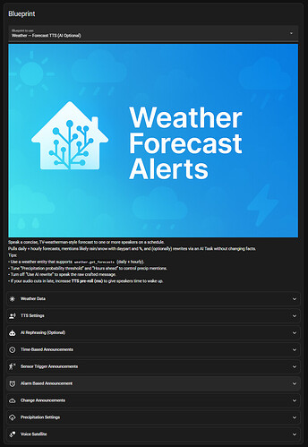

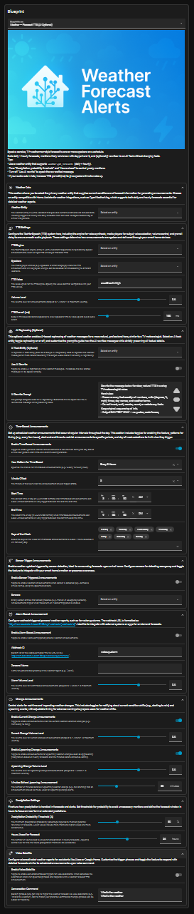

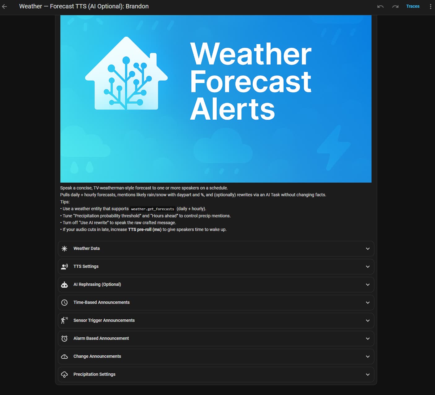

Hey Home Assistant Community! zodyking here with a big update to the Weather Forecast TTS (AI Optional) blueprint. This version brings on-demand wake-up weather reports via webhook, a cleaner collapsible UI, independent volume controls for every announcement type, and full iPhone alarm integration using the Shortcuts app. Utilizing the webhook trigger feature you can this blueprint allows you send a webhook from your iphone that triggers a morning weather briefing when your wake-up alarm goes off. (not sure how to setup on android as i dont use android but share for others to benefit)
New UI Layout – Collapsible Sections
All configuration is now neatly organized into collapsible sections with icons and descriptions:
Section Icon Purpose
Weather Data :comet: Select your weather entity
TTS Settings :speaking_head: Engine, speakers, voice, volume, pre-roll
AI Rephrasing (Optional) :robot: Natural TV-meteorologist rephrasing
Time-Based Announcements :alarm_clock: Scheduled forecasts (hourly, every 3h, etc.)
Sensor Trigger Announcements :walking_man: Play based on presence or any kind of sensor
Alarm Based Announcement :alarm_clock: NEW – Webhook-triggered wake-up report
Change Announcements :cloud::warning: Real-time & upcoming weather shifts

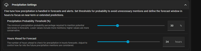

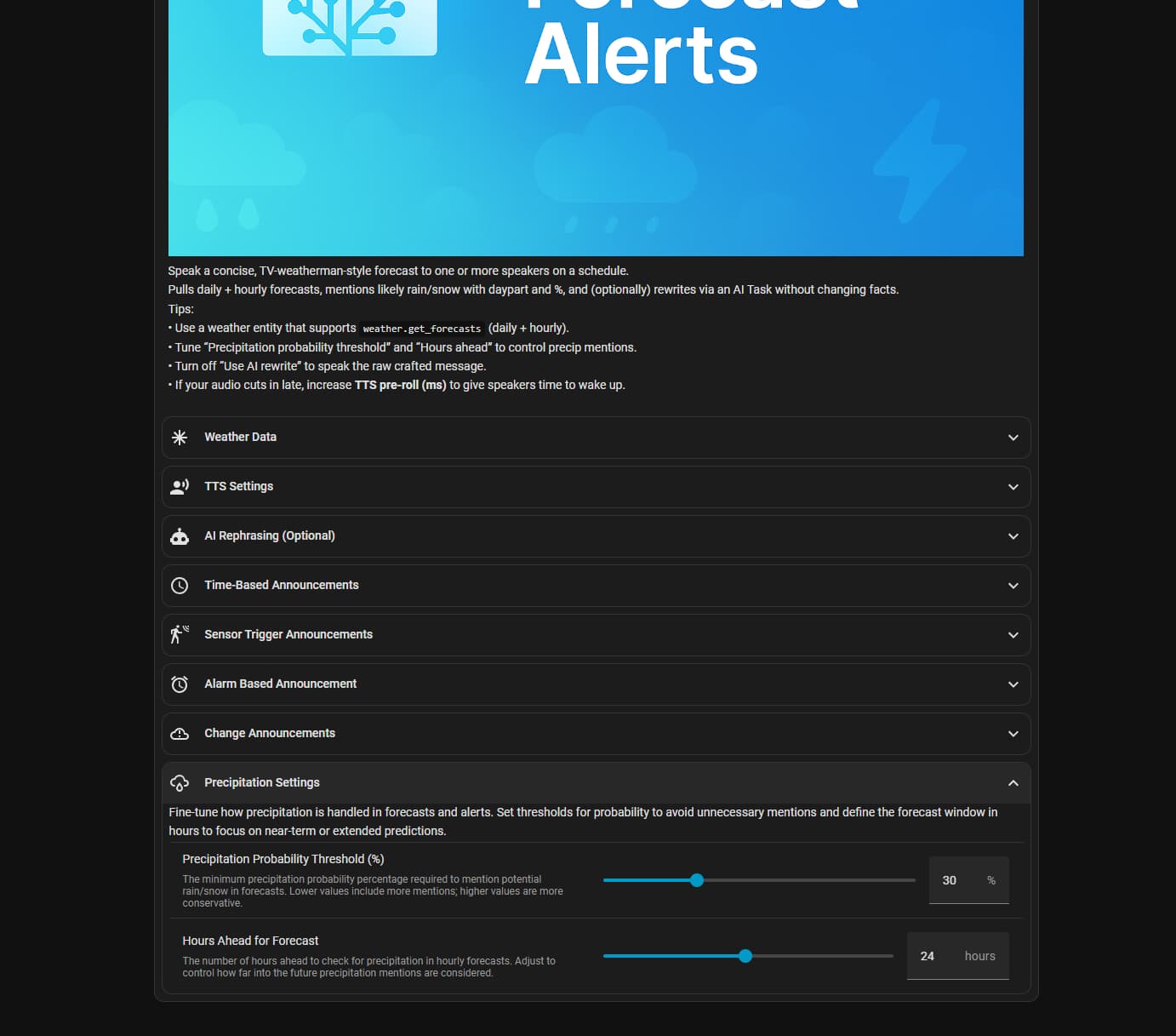

Precipitation Settings :cloud_with_rain: Thresholds & forecast window
All sections collapse by default — expand only what you need!

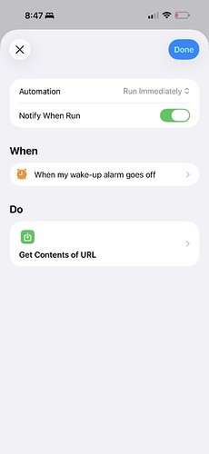

Now you can trigger a personalized weather report when your iPhone alarm goes offno extra apps, no cloud.
How It Works
  1. Enable “Alarm Based Announcement” in the blueprint.
  2. Set your Webhook ID (e.g., wakeup_alarm).
  3. Enter your name (e.g., Brandon).
  4. Adjust Alarm Volume Level (independent from others).
Webhook URL: http://homeassistant.local:8123/api/webhook/wakeup_alarm

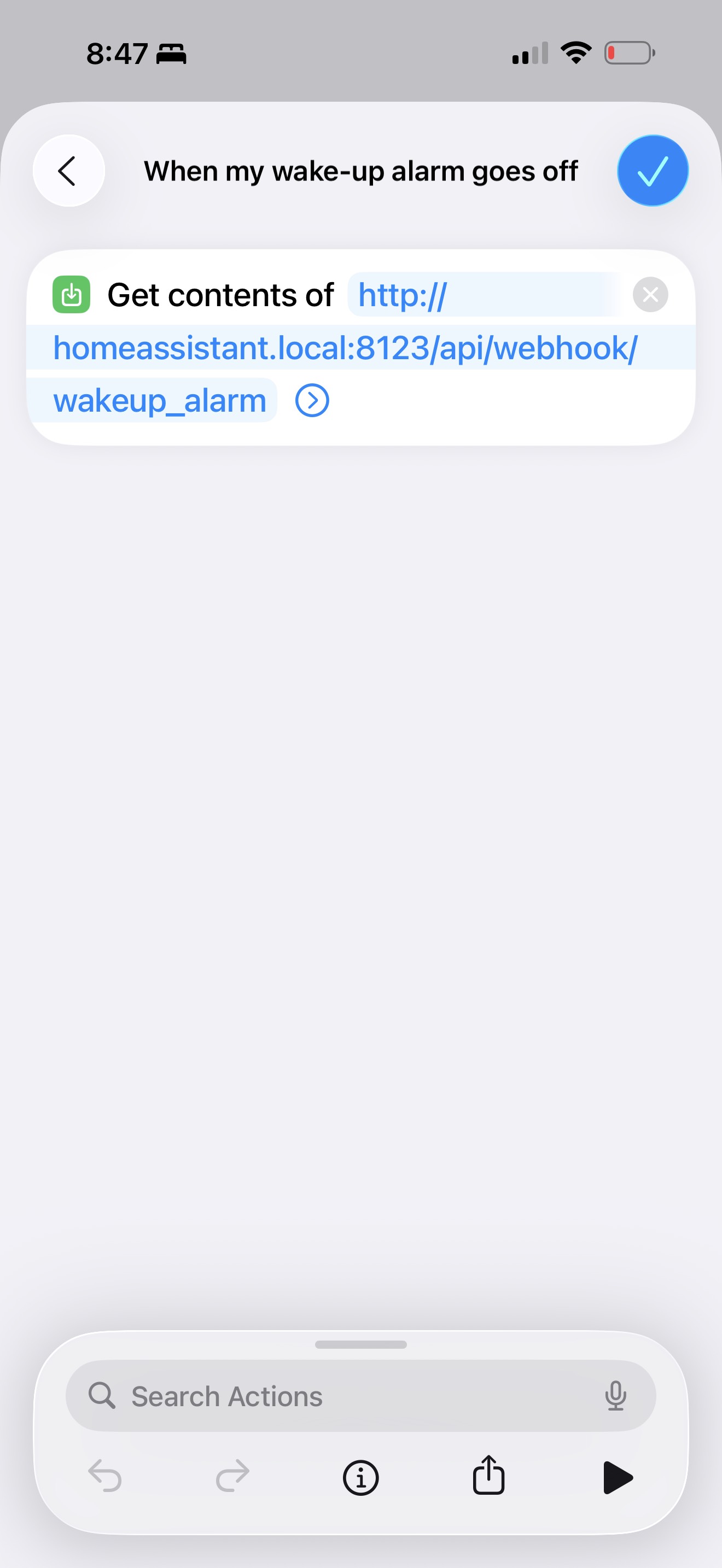

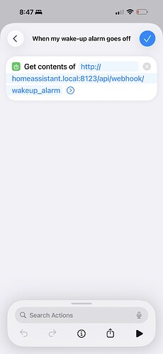

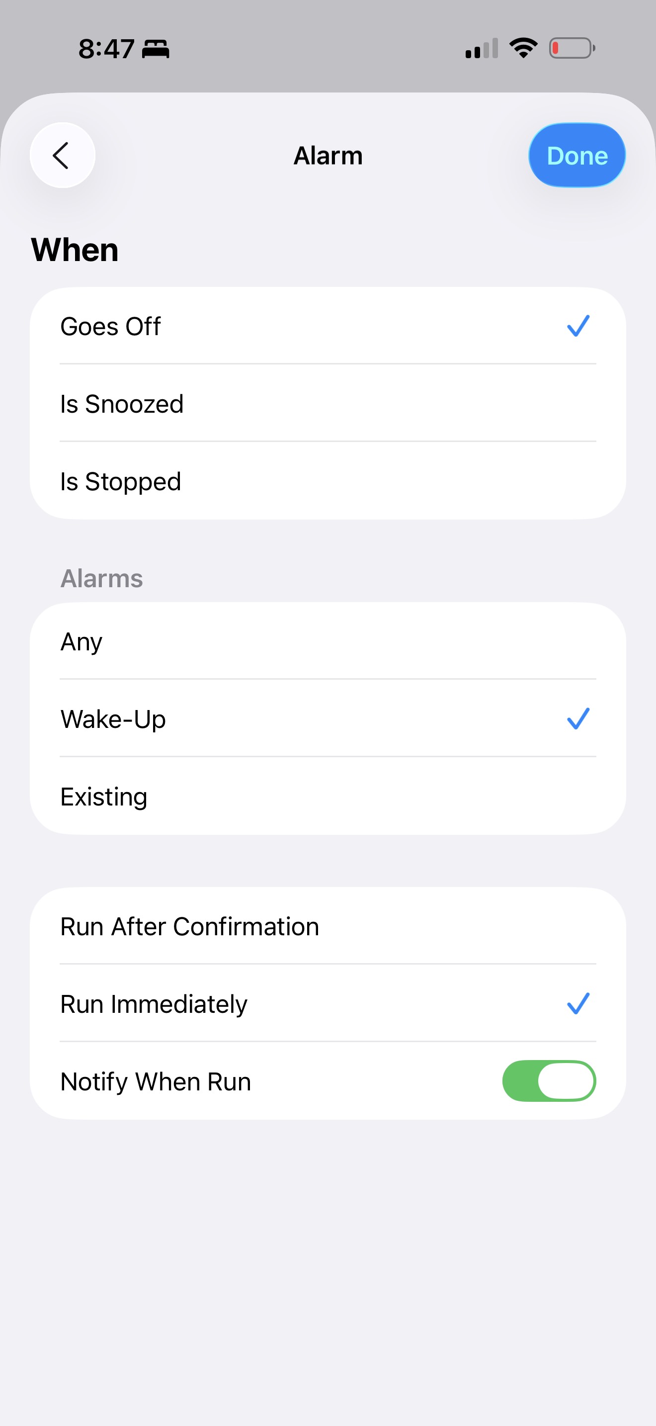

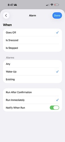

How to Set Up with iPhone (Step-by-Step)
  1. Open Shortcuts app → Automation+
  2. Tap “When my wake-up alarm goes off”Next
  3. Add Action → Search “Get Contents of URL”
  4. Enter:
  1. Tap Done → Name it → Done
That’s it! When your alarm rings, HA speaks: “Good morning Joseph, it’s 7:00 AM. Currently 65 degrees and sunny. High 75, low 55.”

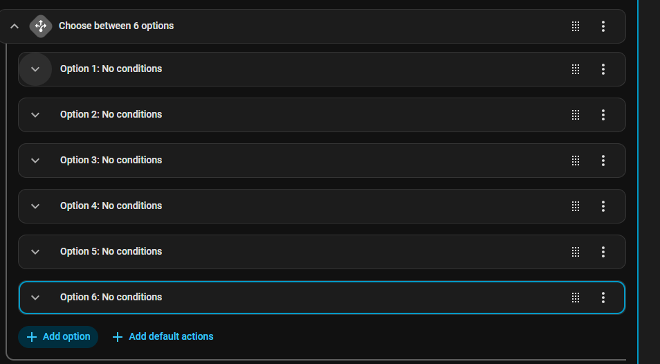

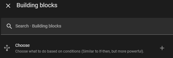

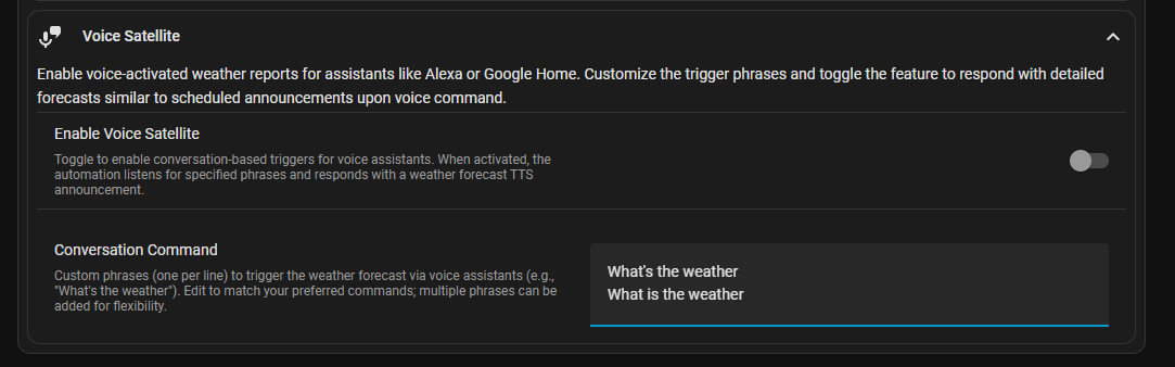

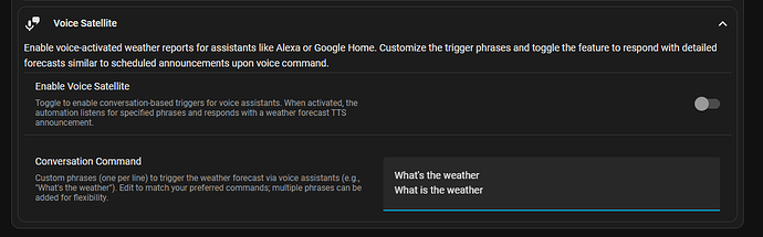

Thanks @zodyking this is great! Any plans to add a sentence trigger with a set conversation response action? That way I could ask for the weather report and get a response from wherever I asked.
Here is a rough example, I just copied the alarm_webhook actions, probably not correct but as a proof of concept it works, lol.

Oh, and one more thing. I noticed the run mode was set to single. This could be an issue. For example, if the blueprint is being triggered by the every 5 minute trigger, then it might prevent a run from another trigger. Then again, that may be by design.
Sure I’ll add this feature I was not gonna do voice satellite related things until I finished designing my own ceiling mounted satellite but I’ll add the feature I can’t say no lol
@MakingNate
I created the new feature, i did it fairly quick before i went to work and haven’t tested it yet,
Please try it and let me know!
Thanks for the quick update @zodyking. Unfortunately it did not work, looks like the enable_voice_satellite variable never gets set in trigger_variables. That said, looking at the current configuration, if I configured the Speakers to say, Kitchen and Living Room, the automation based triggers would play to those preconfigured speakers which makes sense. But if I ask “What’s the weather” in my bedroom, it would respond in the kitchen and living room.
Instead, if you use the Set conversation response action when triggered by voice_satellite then it will dynamically respond from wherever the conversation was initiated.
Thanks again!
When I use webhook as trigger i get this error:
UndefinedError: 'precip_threshold' is undefined When triggered manually or from sensor it’s running fine. What’s wrong?
webhook works without a doubt, ill need a trace file from the errored automation run to properly diagnose it. Are you familiar with downloading trade file. Once you do download it, open it and paste the content here
Then wrap it in preformatted text like this. :)
On the other hand…
Open the precipitation settings and change value then save. If that does not fix it then ill scavenge your trace file once uploaded.
No problem, also im gonna need time to re-setup my voice satellite and test this once i fix it.
@zodyking, your blueprint got me thinking. In order to setup optional triggers you use conditions to check if that trigger should be allowed to continue. But what if instead you use the enable_ variables directly with the enable option of the trigger, like this:
trigger:
  - trigger: time_pattern
    hours: !input hour_pattern
    minutes: !input minute_offset
    enabled: !input enable_time_based
Now the trigger is actually disabled if the slider is off and the conditions section is no longer necessary. Just a thought as I was playing around. I am new to Home Assistant and Blueprints so if there is a reason not to do it that way I would love to know.
Thanks for the idea! I stick with conditions in the actions section for greater flexibility, templates let me handle complex logic beyond simple enables.
For instance, in a blueprint for smart lighting, I use a template condition to check multiple entity states dynamically:
yaml
condition:
  - condition: template
    value_template: "{{ is_state('light.hallway', 'off') or is_state('light.kitchen', 'off') or is_state('light.bathroom', 'off') }}"
This allows branching paths: if true, run a delay/recheck loop until lights are online (Tuya API lag); if false, proceed directly. I save initial states in variables and restore them later with similar conditions.
It also aids debugging the automation runs even if “disabled,” letting me trace issues by adding temp time triggers (e.g., for webhook testing) without real inputs.
HA could use better flow testing, like Node-RED’s debug nodes, vs. just action testing.
All my blueprints use the “choose” block for scalability: name options clearly, avoid trigger clutter, and layer precise templates. Your way works for small automations, but gets messy in big ones.
In short i can literally have one trigger and a tremendous about of automation that going on based on that single trigger if i use the Choose building block. If my trigger was a lamp turn on, i can have an automation that runs when:
On + presence
On + time of day
On + pretty much anything
and it get even more powerful if your trigger is less specific and change it to entity state change from any option to any option so now one trigger can literally combine what would have been countless automations which is what these fantastic blueprints aim to do :slight_smile:

Moving away from Blueprints
Slowly as i convert all my blueprints to integrations, Home Weather is the current one next inline.
You will have same functionality if not better :slight_smile: and a registered Panel.
Blueprints are cool and fun but annoying to develope python is better and more straightforward. The concept is why have a blueprint when you can have a “Smart Dashabord” you get a cool display plus you still get the cool automations built in, with superior logic than a yaml automation.
  • as of now im trying to make it look home asssitant native but if any feature request let me know
