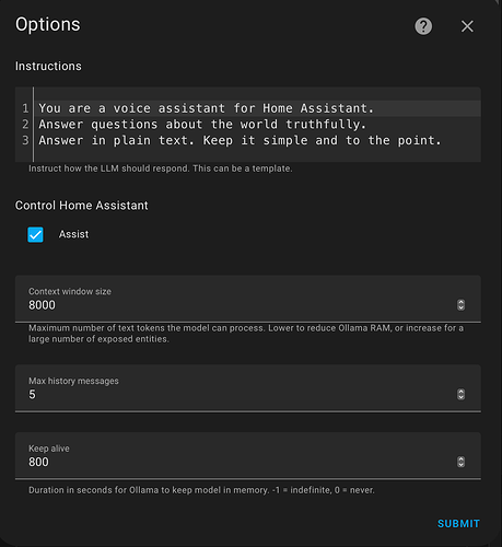

Thank you for the fix! Just a related question, I assume for the weather full LLM script, in settings your LLM for Conversation Agent must have it’s ā€œAssistā€ checkbox on for this to work right? The script is firing now but it’s taking a very long time. I have a feeling the llm is getting too much context to deal with does anyone have any best practices for keeping the # of tokens down? I’m on Ollama set up with a 24GB RTX5000 card so it’s decently fast but not when context window fully used. I’m using Gemma3 27B that’s tuned for tool use.
