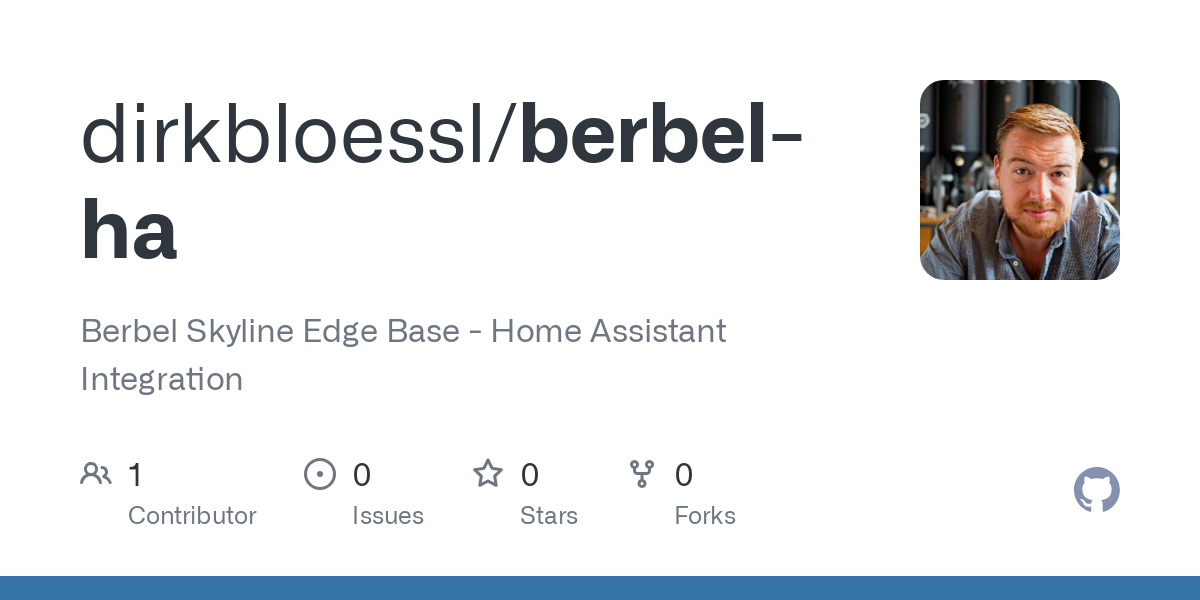

I created an integration for my Berbel Skyline Edge Base, which is installable via HACS. Tested it the last week and seems to be stable.
Unfortunately, I have no idea, if any other Berbel models work, as I do not have any for testing ![]()
