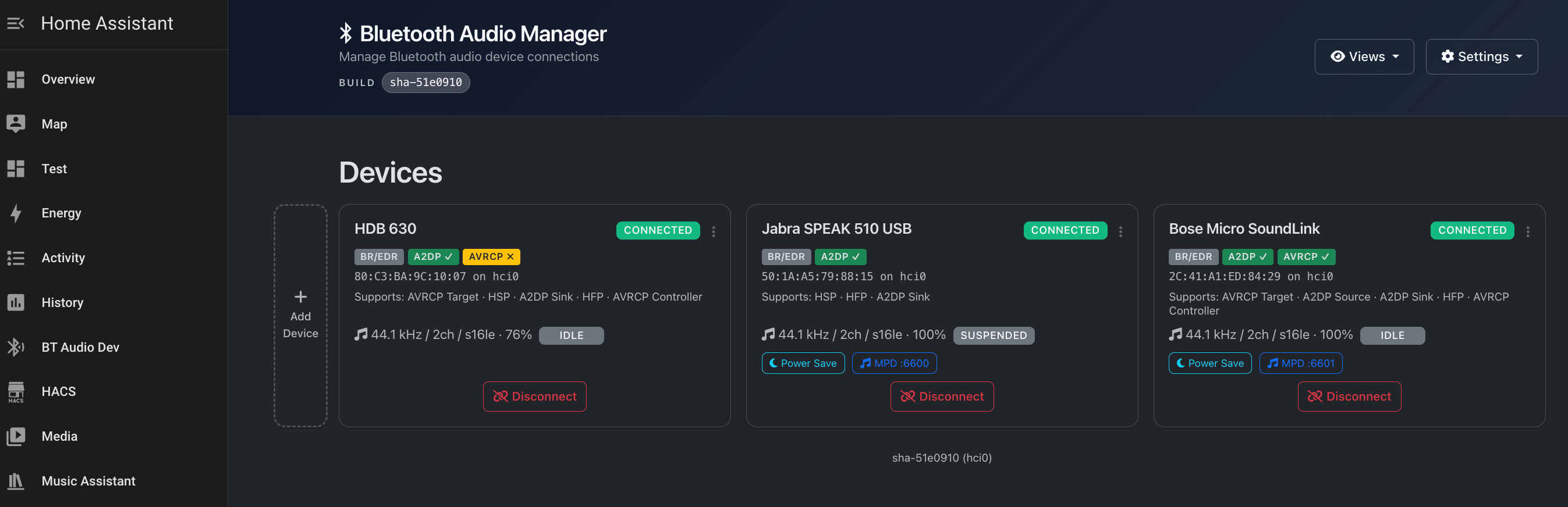

What does it do:

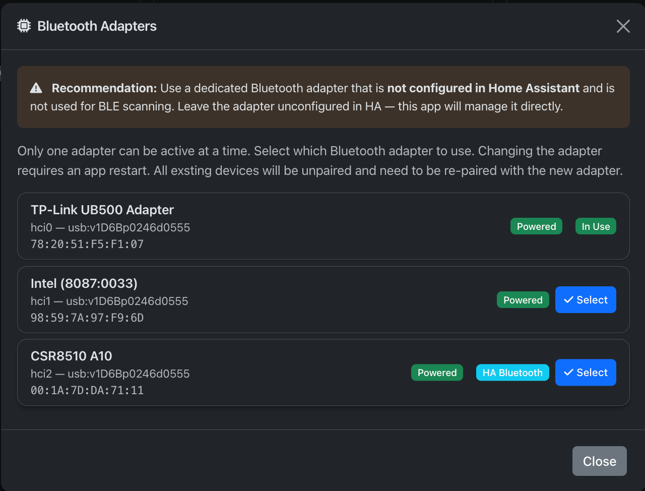

  • Manage which BT adapter will be used for this purpose (i recommend dedicating an adapter but it should work well with any you have doing BLE/beacons etc)
  • lets one discover and pair A2DP target devices (speakers, headphones)

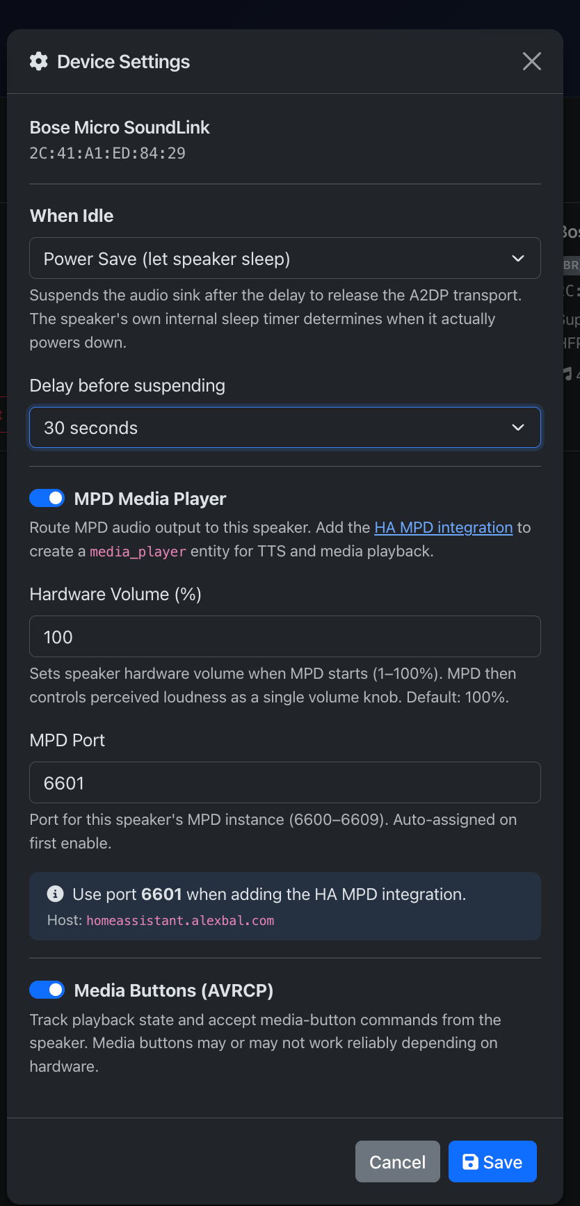

  • it ensure that pulseaudio is configured correctly for each device
  • provides various options for letting the device sleep or forcing it to remain on
  • enables hardware vol buttons to work on devices that didn’t have local overrides
  • provides a per device Music Player Dameon (intended for testing and TTS) for music i recommend Multiroom Audio coupled with Music Assistant
