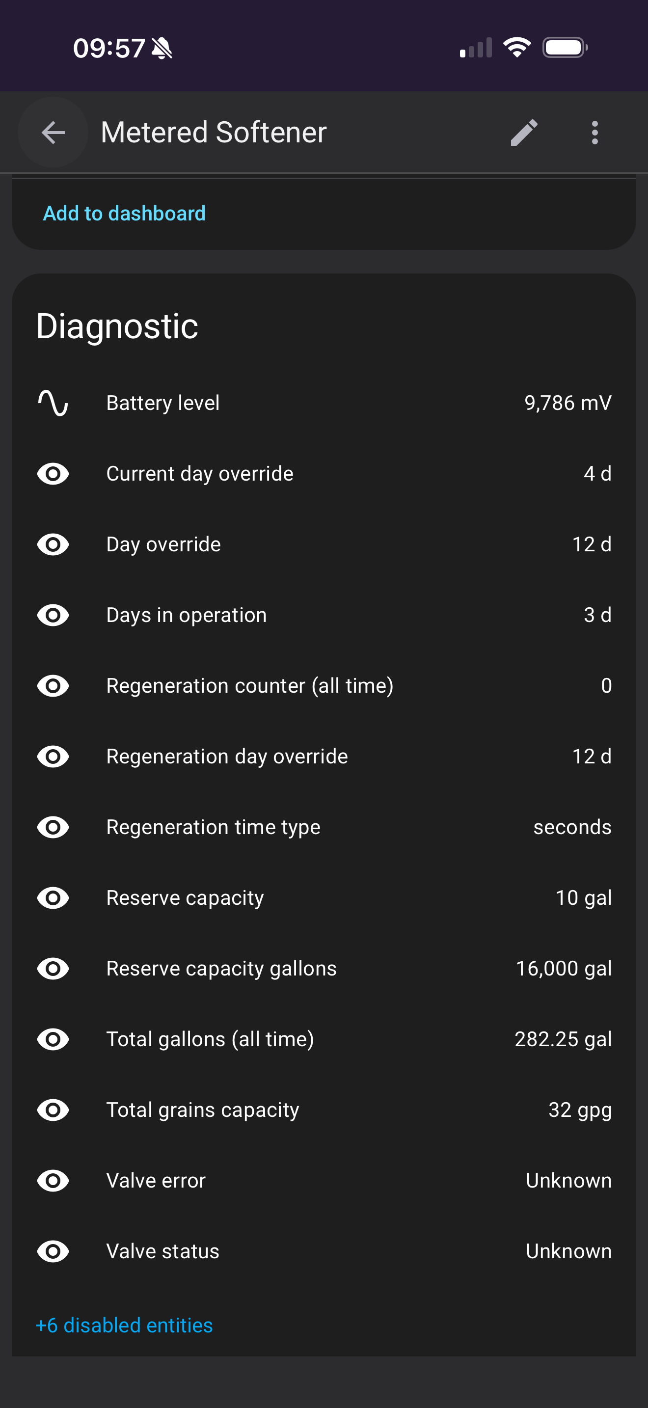

@toekneestuck my first PR - changed the unit of reserve_capacity from gallons to percents
Btw, my salt readings are “undefined”. Is there a way to log the raw json somehow?

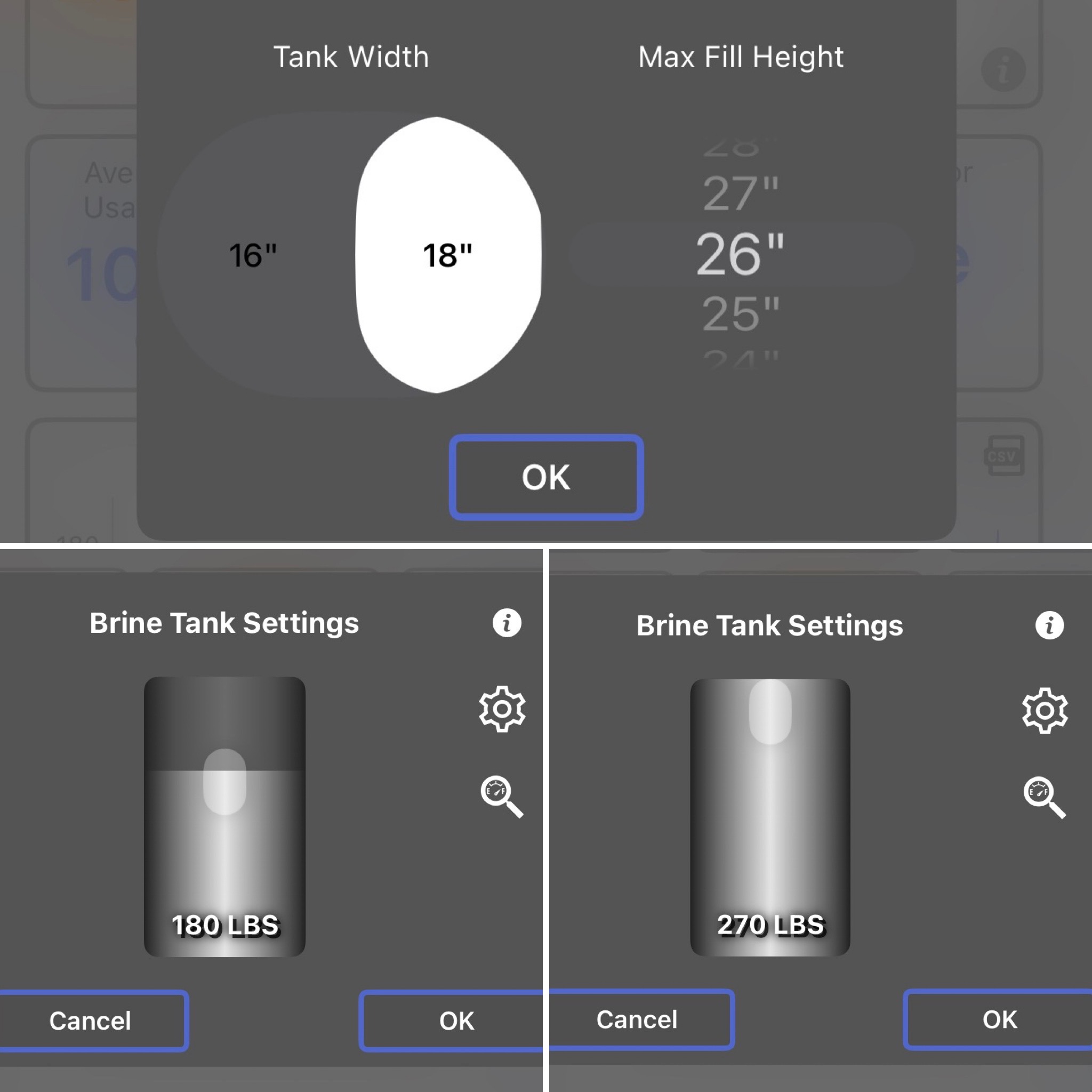

Anyhow, this is the portion of the payload related to the salt brine tank:
'dbtw': 18, 'dbth': 26, 'dbts': 270, 'dbtr': 1800
dbtw - the brine tank width in inches
dbth - the max fill height in inches
dbts - the max capacity calculated based on two parameters above in pounds
dbtr - the brine tank level in pounds x 10

Looking through the dashboard API docs though, I don’t see the heigh/width definitions
There was a typo in the doc. James confirmed that my key/value pairs are what I think they are in the issue I opened yesterday.
Quote:
#define KEY_DB_BRINE_TANK_WIDTH              "dbtw"
#define KEY_DB_BRINE_TANK_FILL_HEIGHT        "dbth"
#define KEY_DB_BRINE_TANK_REFILL_TIME        "dbrt"  /*! @note Write-Only */
#define KEY_DB_BRINE_TANK_TOTAL_SALT_LBS     "dbts"  /*! @note Write-Only */
#define KEY_DB_BRINE_TANK_REMAINING_SALT_LBS "dbtr
His rationale for not documenting brine tank width and height - they are not that useful in a context of Home Assistant. I just saw those values based on the payload from my device and matched them agains the data in he app.
