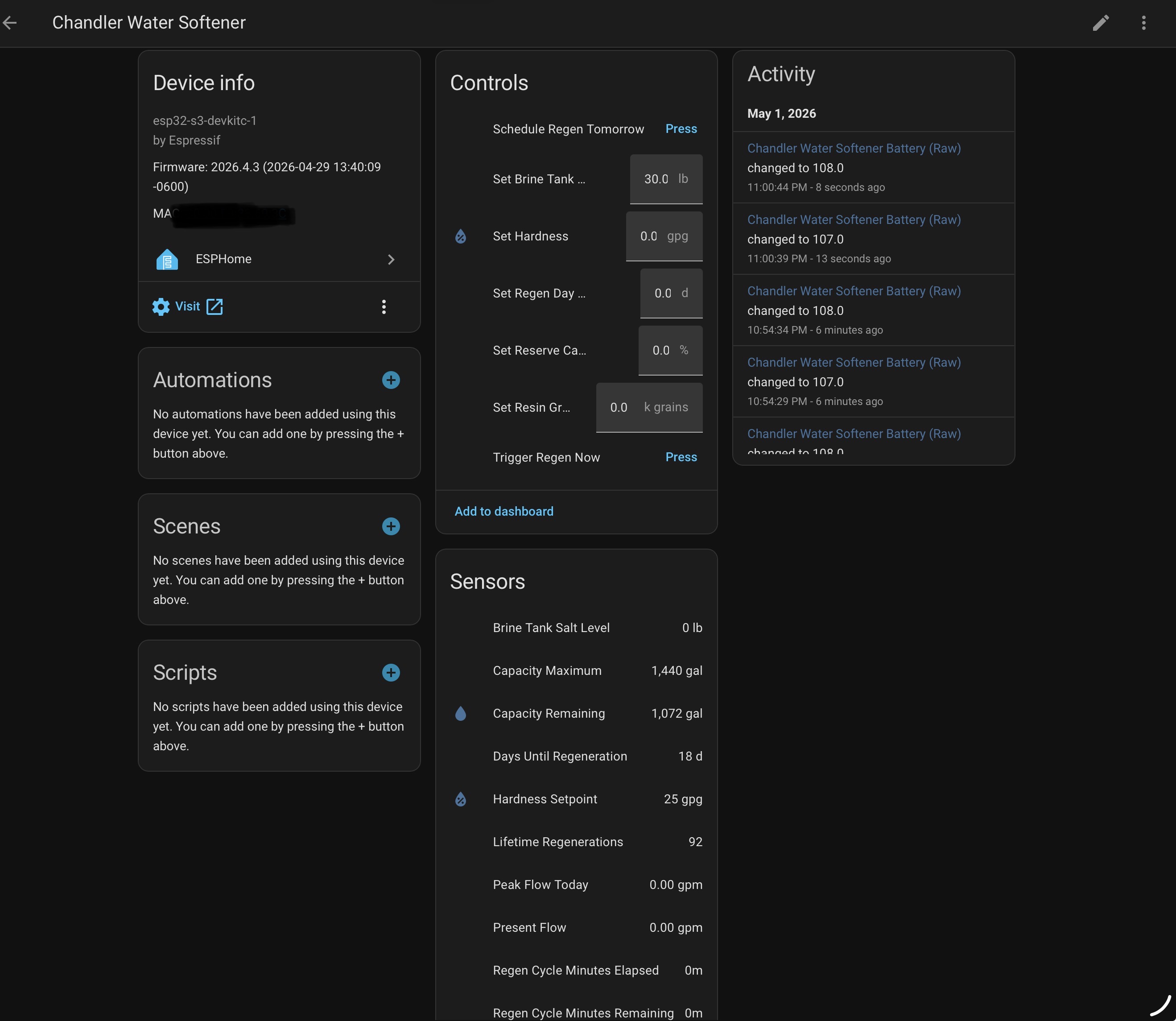

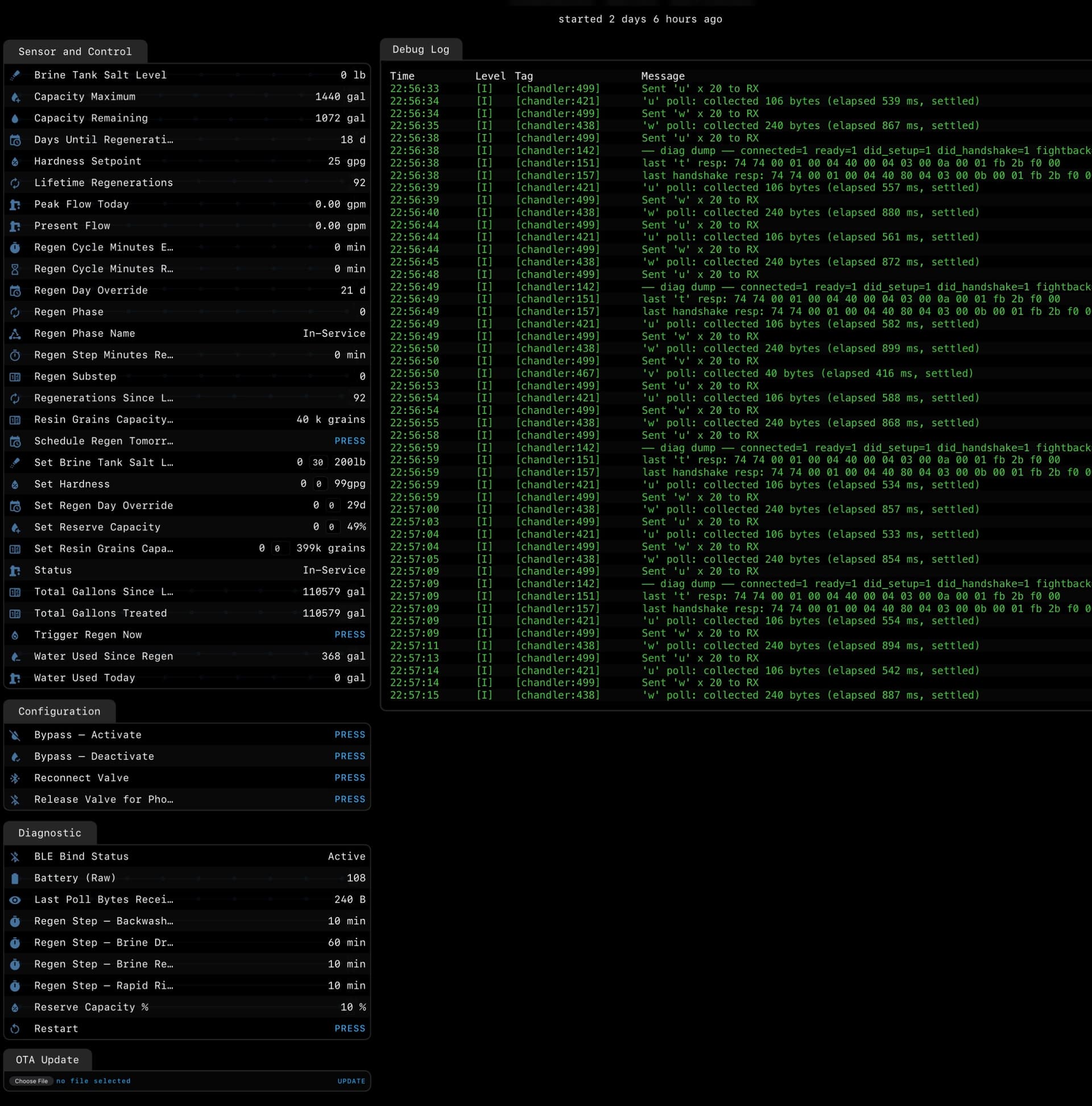

If anyone is interested, I (mostly Claude) have reversed engineered my Chandler Meter and an ESP32 that can connect to the meter, poll it, and read most of the data on the device. The data is then placed in HA as a device. I have been able to write data to the device as well. Therefore, I can update salt/trigger regens if necessary. I have not at all, polished everything, but I am running C4.40. I know that has been a sticking point for most with my hardware and software which is the reason I set out on this project to begin with. I’ll provide a few screenshots of the data I am able to receive. The ESP is running a web server along with updating HA. I can certainly create a git if there is interest. I’m new to this and know just enough to prompt Claude for the coding, but wanted to share. I’m sure there are plenty of bugs, but nothing. that can’t be polished and reworked to make whatever you’d like. Feel free to reach out if needed.

Thanks for this. At this point, both your project and Tony’s causes the valve lockout issue very often when using the BLE on an ESP32. It can range from a couple minutes to a couple hours. Using Tony’s HACs addon but with a dedicated Bluetooth adapter is much more stable. Before disabling it to try yours, it had been up for almost 2 weeks.
I appreciate your time coding this ESP project up but I’ll keep running Tony’s till the valve lockout issue is resolved.

Well, now I do. I pulled all the WiFi/BLE proxies and even disabled the Bluetooth built into my HA server (Yellow). The only BT device recognized by HA now is Seeed XIAO W5500 Ethernet Adapter V1.2
Unfortunately, the board locks out just as frequently as with WiFi proxies.
