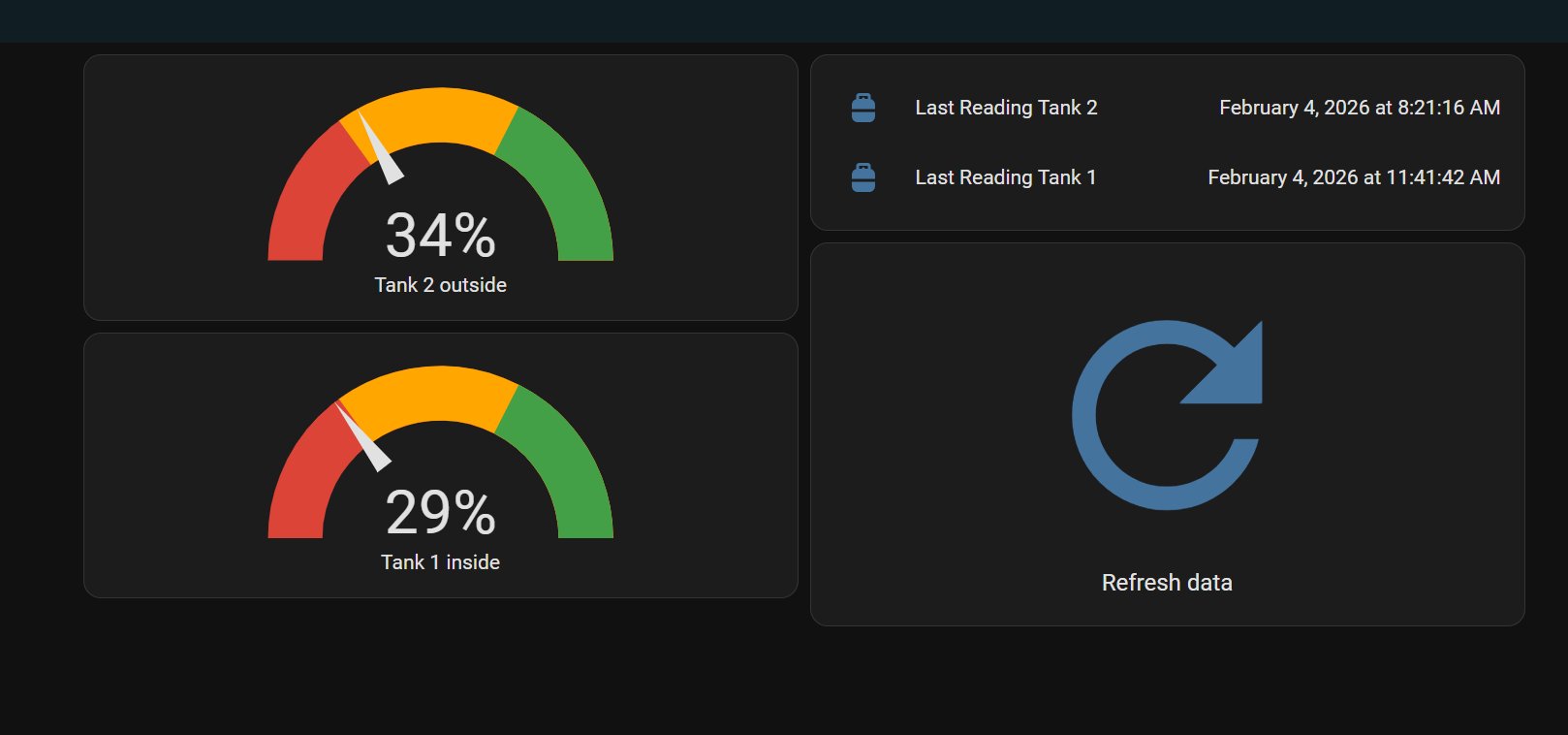

I use this integration for otodata tank monitor. I had to tweak the code a bit since the fields didnt match up. I’m using two tank sensors. tank data is coming straight from otodata.
https://github.com/briadelour/otodata-tank-monitor
Well that was easy! Thanks a million!
Any idea how I get it to refresh? I added it yesterday, and it still shows 39%, checked the app and it’s at 34%
Yes you need to change Attributes at the bottom of file const.py located at
/homeassistant/custom_components/otodata_tank_monitor/const.py
since some changed in the api.
# Attributes ATTR_LEVEL = "Level" ATTR_LAST_READING = "LastReadingDate" ATTR_TANK_CAPACITY = "TankCapacity" ATTR_PROPANE_PRICE = "propane_price" ATTR_SERIAL_NUMBER = "SerialNumber" ATTR_CUSTOM_NAME = "CustomName" ATTR_COMPANY_NAME = "CompanyName" ATTR_NOTIFY_AT_1 = "NotifyAt1" ATTR_NOTIFY_AT_2 = "NotifyAt2" ATTR_TANK_PRESSURE = "TankLastPressure" ATTR_PRESSURE_UNIT = "TankPressureDisplayUnitSymbol" ATTR_IS_OWNER = "IsOwner" ATTR_PRODUCT = "Product"
I also changed my DEFAULT_SCAN_INTERVAL = 240 (every 4 hours)
