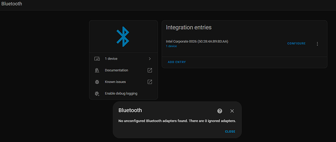

Home Assistant does not detect this device as a Bluetooth adapter. Under Settings → Devices & Services → Integrations → Bluetooth, the only device is the onboard hardware of the NUC (NOT a USB adapter), which does not detect any Bluetooth connections. Removing the NUC Bluetooth from Devices does not change anything.
I’ve tried a number of different ESP32 chips. No difference. Wiping the chip and reinstalling does not do anything. Restarting HA does nothing. It’s been several days and nothing has changed. Device is working as above under the ESPhome tab.

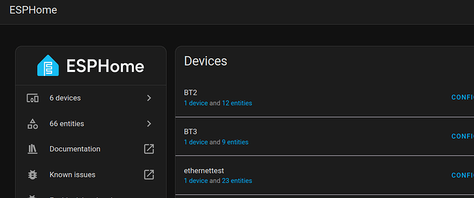

My mistake. Yes, this is where I am looking, under the Integrations → Bluetooth. It is still not there. Apologies, integrations is under the ā€œDevices & servicesā€ tab leading to me misspeaking. I updated the OP for clarity. Here is the Bluetooth integration window. (Again, removing the NUC adapter does not seem to change anything.)
EspHome…
Device is there, I put the logs in OP. Seems to be working fine otherwise.
What devices are you expecting it to pick up? It will only work with devices that have HA integrations. And it won’t show up under the Bluetooth integration, only under the ESPHome integration just like any other ESPHome device.

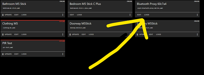

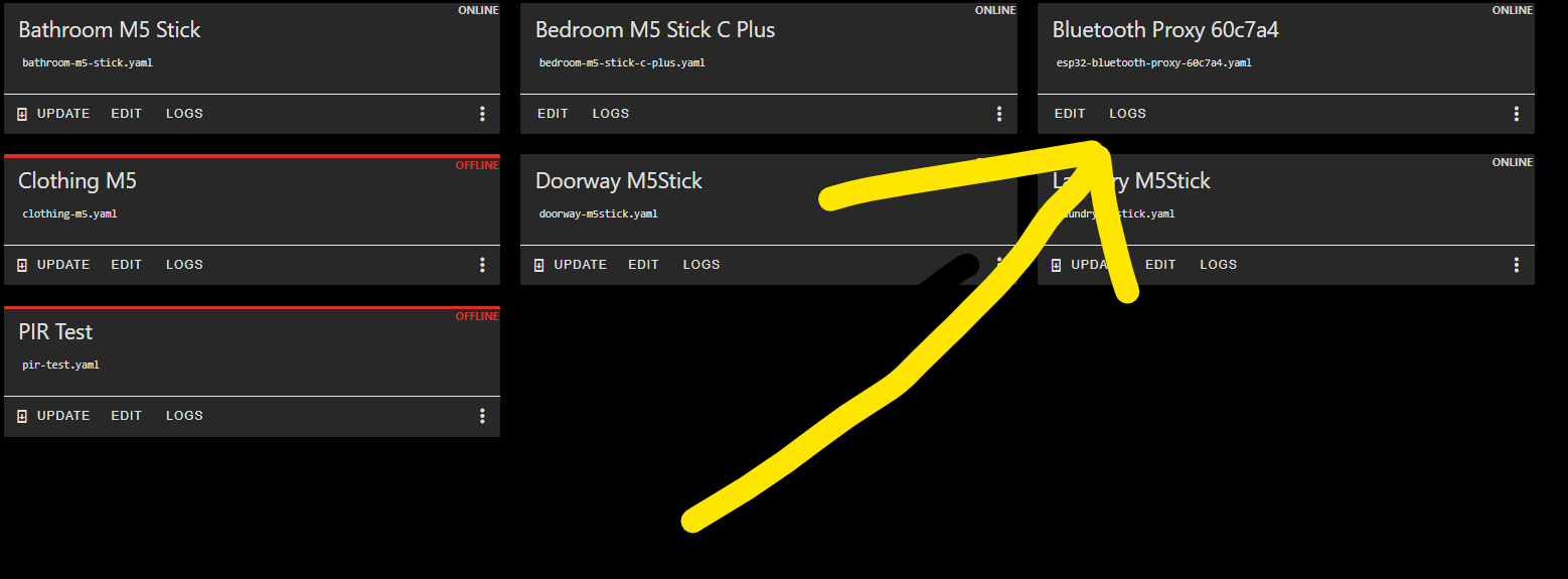

Did you ever solve this? I have the same issue. Following all the guides, which say once you’ve installed the firmware from the ESPHome site, HA should discover it as a proxy device. It is found by the ESPHome add-on, but HA has nothing. It’s not there to add to HA, so its services are also not available. It’s supposed to be so simple, so troubleshooting is kind of like ĀÆ_(惄)_/ĀÆ
