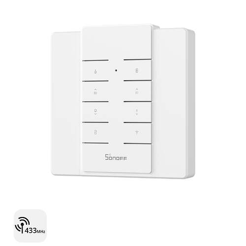

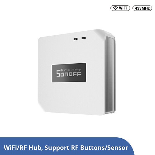

Sonoff RF remotes with a Sonoff RF Bridge and you are good to go.
RF Bridge might also be flashed to atawmota or ESPHome (at least the older ones. I have not checkee the newer ones).
The first picture of the remote is with its wall mount.
I have sawed of the sides on some of mine and replaced the magnets with some small neodyme ones, which now acts like a magnet in a phone changer and hold the remote easily.

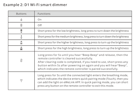

Does not seem to be just click and done, but maybe it works? Atleast it does not have the multiclicks and only holt so might avoid muliclick issue, but I’m not sure.
again says stuff about pairing, which in my expeirence always breaks

The best thing is that the RF Bridge with ESPhome or Tasmota can catch lots of other RF remotes and also send those signals.
