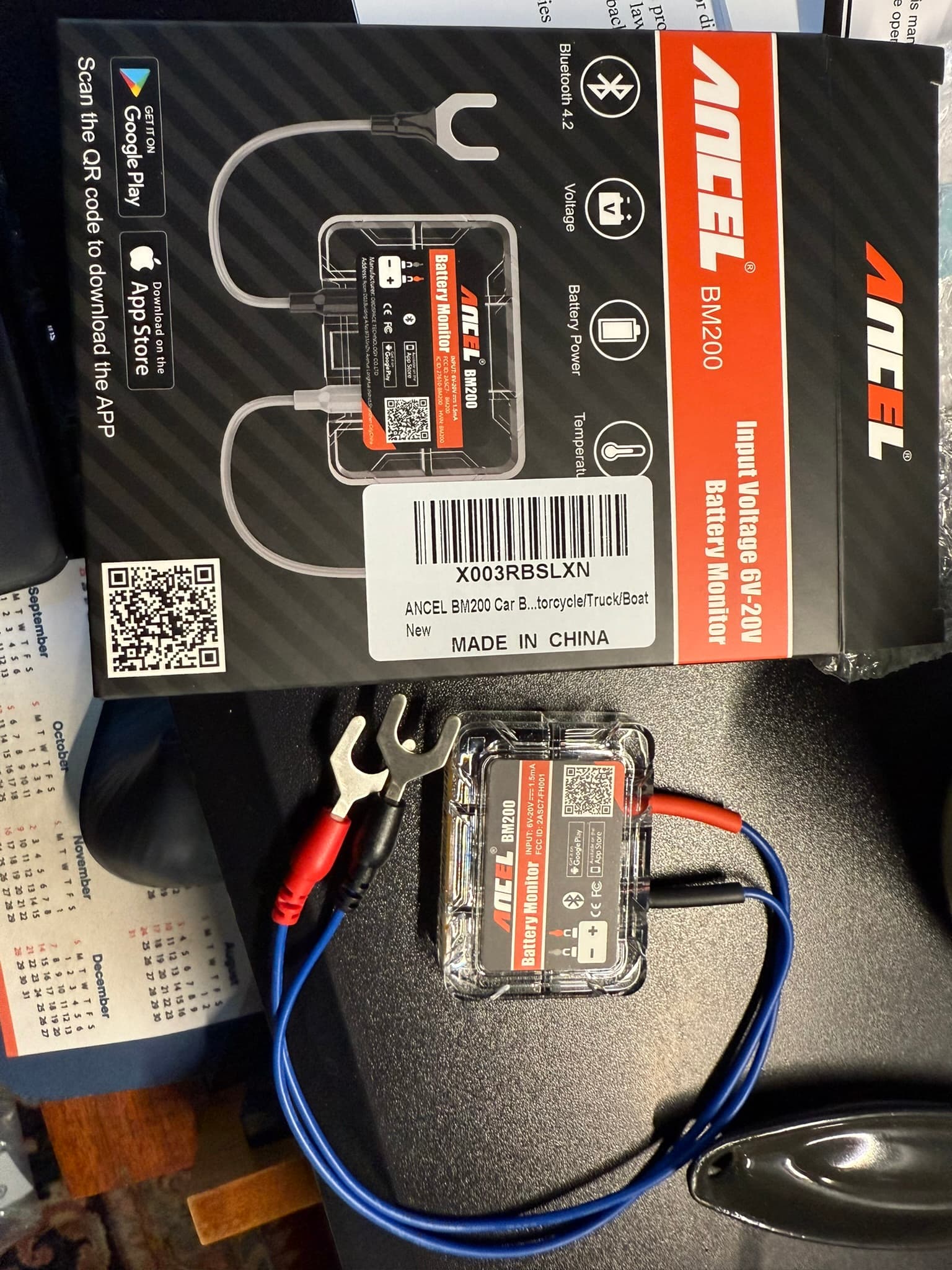

I’m having a lot of trouble getting mine working. Mine is an ANCEL BM200.

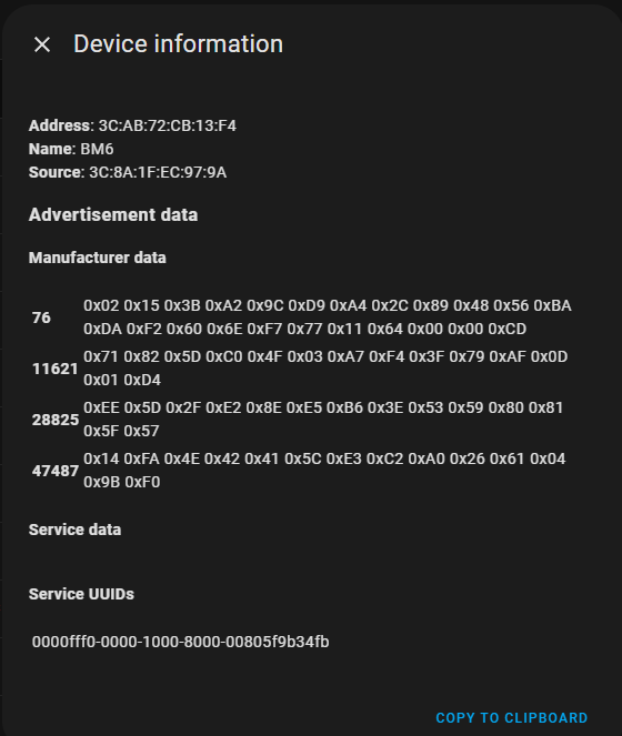

When I try adding the integration, I get the error that “No BM6 devices were found.” I can see the BM6 in my bluetooth integration though, and clicking on it shows the following device information:
Are you using the Bm6 Battery monitor integration?.
Mine says the same when i try to add it (Ancel BM200 & Ancel BM300 Pro), “No BM6 found”.
But when I go into devices & services, it has automatically discovered them.
I have 2 x Ancel BM200 (exactly as yours, same box and all) & 1 Ancel BM300 Pro.
The 200’s show up as BM6 Devices and I get all the info from the sensors.

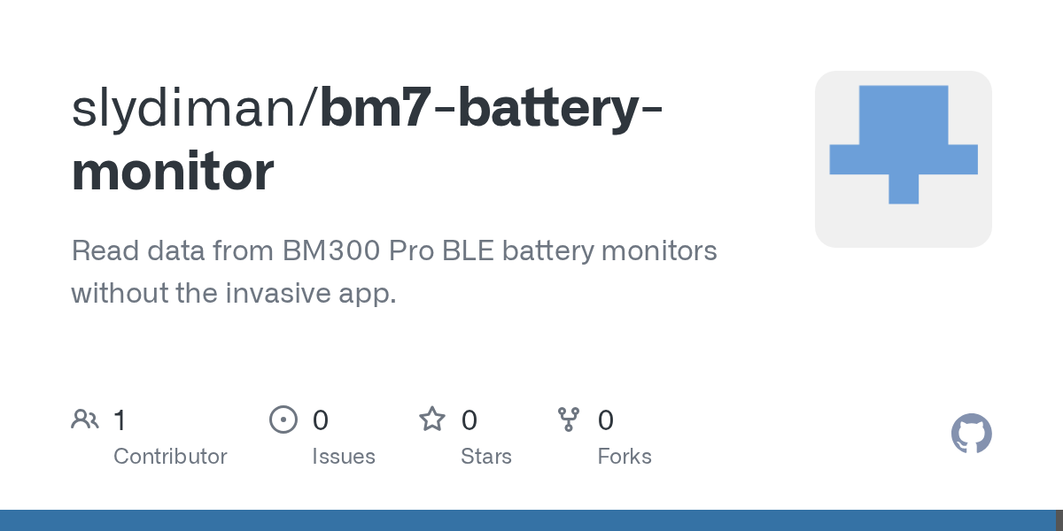

I do wonder what it would take to get newer versions supported.
Ancel BM300 Pro

Hey @B_Rotten, i don’t know if the original project is alive still… but i made an issue in that repo as yours didn’t have issues enabled.
do you think this is something you could implement in your fork? my fork works as a POC… but i think it would be better if a single integration would support multiple devices.
if anyone wants to test the fork or work on changes to submit PR to original Rafciq repo, its here… GitHub - derekpurdy/BM7: Home Assistant integration for Battery Monitor BM7
Thank you so much. Just ordered one and should be here next week.
