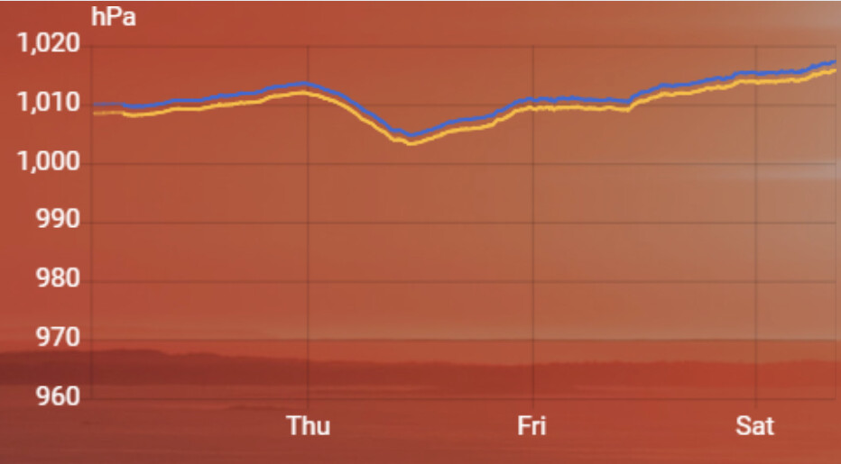

I use BMP for pressure and keep them indoor. They seem to have good precision. Accuracy harder to say. Above the blue line sensor is about 6m above lower sensor. Either way it looks like the weather is improving for the weekend.

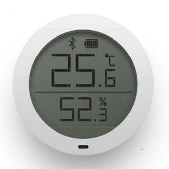

That's true. However i guess that "best second" is: i bought 6 of BLE Xiaomi's and i've had them on the same place (very close to each other) for a month or so, and they were all accurate to max. one decimal. I'd say that's "good enough" for amateur... without any reference.... statistically there's very little chance that 6 of them would lie exactly the same...

Not long ago added two Shelly's ( Shelly BLU H&T) to my "collection".

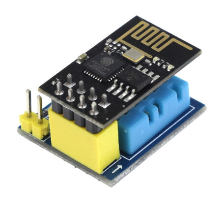

If you look at the specs of the DHT11/12 you'll see they are +/- 2°C. My experiments with them showed me this. I applied an offset and found that it was an addition +/- 2°C depending on actual temperature. Even with a slope and an offset, I never could get two to agree. So, yes, these devices can by off by 4°C!
The picture showed an ESP-01 with a DHT11. The heat dissipation from the ESP8266 increases the temperature reading by 5°F!
