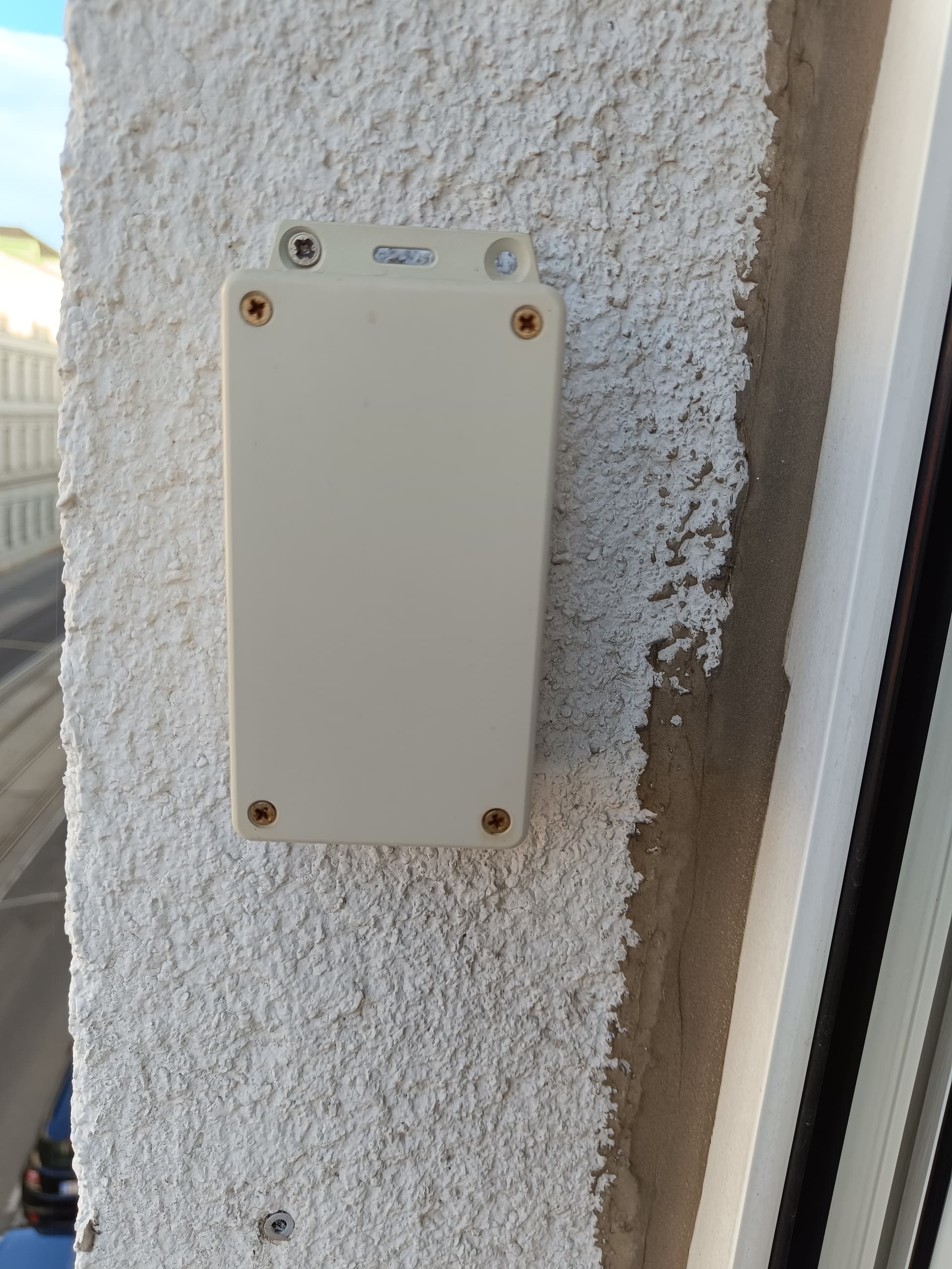

This is what it looks like after being outside for 5 years with still the same single AA Alkaline battery. Battery voltage currently: 1,388V
Expected Battery Liftetime: 10 years.

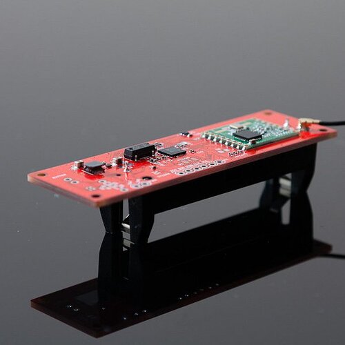

Some infos about the project:

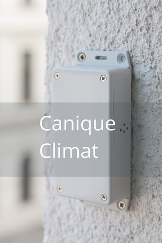

Product page:
When comparing the pic from the product page to the current picture, you can see some UV light influence which changed the colour of the ABS enclosure. And there seems to be some rust on the screws now. But apart from that it’s still working and still sending every 30 seconds (yes: seconds) temperature + humdity with 2 decimal places, and once per hour its battery voltage.
P.S.: internal sensor used: SHT40

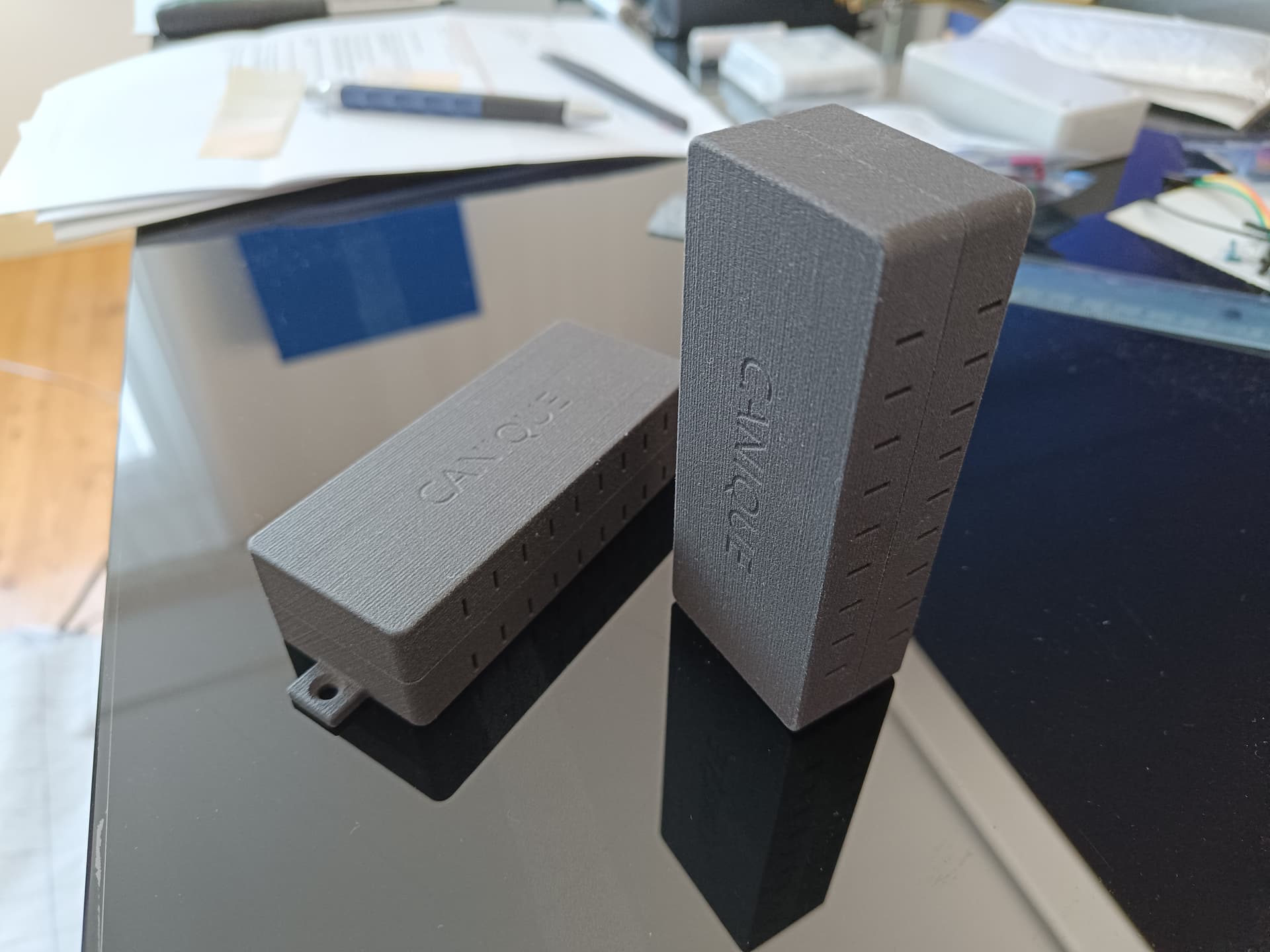

PPS: I’m working on different enclosures right now - to make the product more “sexy” because people often judge a book by its cover.

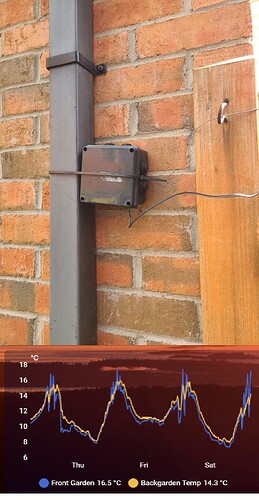

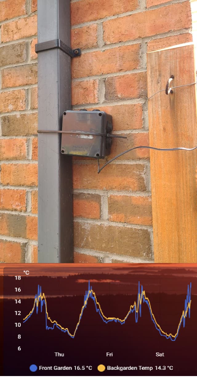

In my back yard I have a cheap 433mhz temp/humidity sensor that runs on 2AA cells. I replaced the cells with a TP4056+lithium cell from a discarded vape with a 30mmx90mm 5V solar panel. The sensor is put in a outdoor junction box and never gets direct sunlight. Solar is on other side of wall facing west. Only running with lithium cell for 6 months and I had to open box once as soldered wire to battery compartment had come off.
You can see the difference between front of house temp which gets the sun directly and the back of the house.
