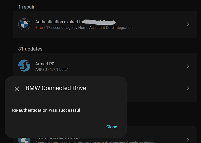

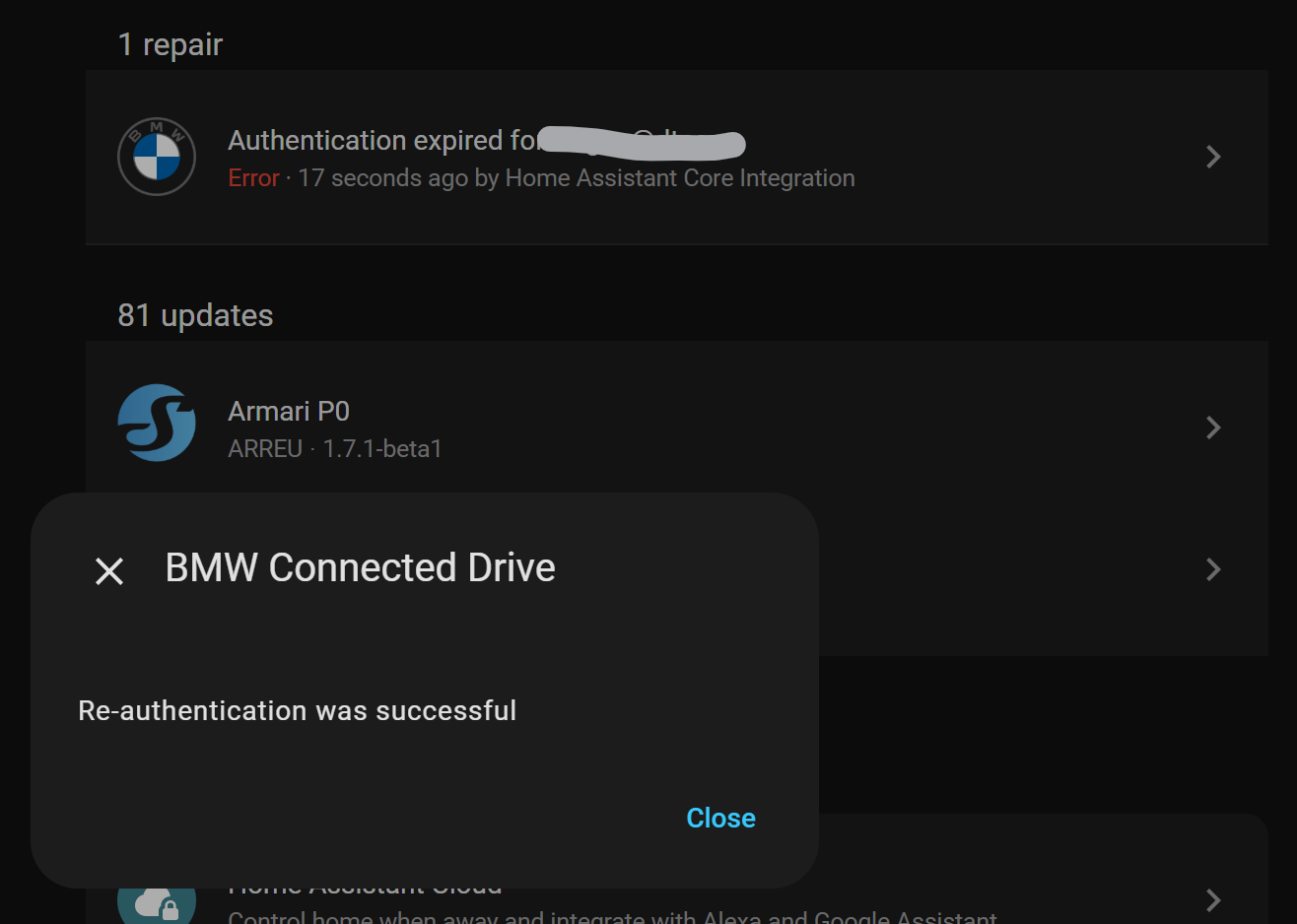

I’m getting this same authentication error. The authentication seems to work after the captcha is entered,but it actually doesn’t work:
After entering the captcha the authentication error persists.

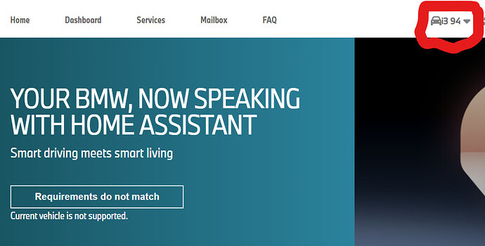

Looks nice, but not supported on my i3 :frowning:

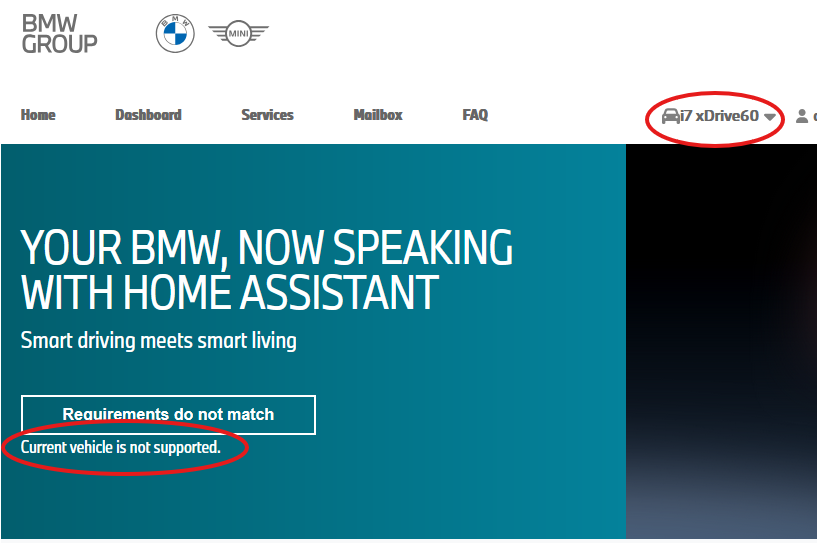

Same on my i7.
Currently have an ix3 & i7, had a mini JCW & M3 touring, got an M5 touring on order and about to also order a new ix3 this weekend. The fact I could connect to these and run automations that integrated with our solar, home battery, chargers, garage doors, gates etc was a major plus for our purchasing decisions. If this is the state of direction for BMW, then Ill not be bothering.
Surprising that the flagship i7 is not supported. Anyhow, I re-authenticated two days ago and I am still connected through the original HA integration.
