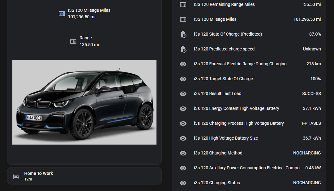

I’ve been using my own integration for a while now:

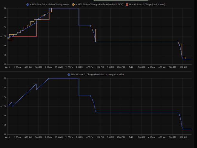

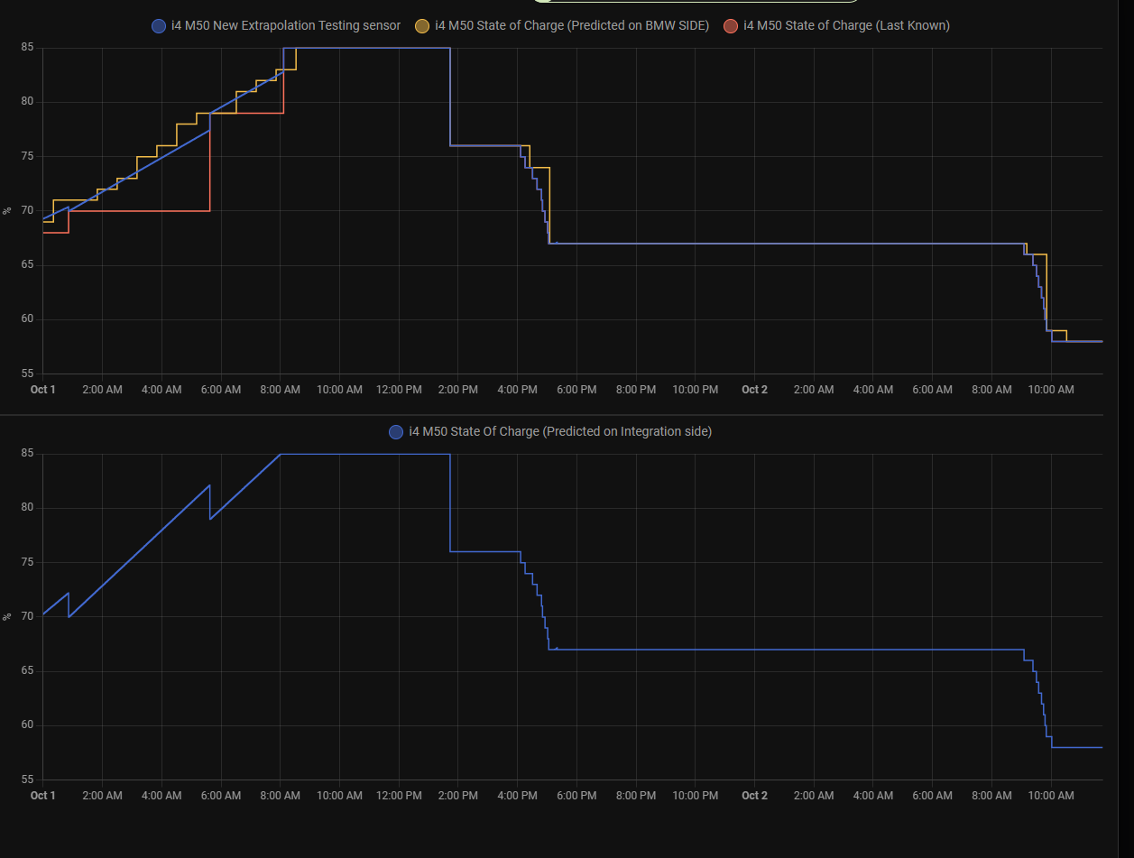

Apart from the BMW side hiccups, WIP in progress sensor names and BMWs documentation the differences between cars and how they might show the same data in different fields, it has been working pretty well for last 2 days.
Some of the data needs to be extrapolated (BMW did it as well even on their old API apparently)
Note that it doesn’t feel as finished as the old integration and will still need some extrapolation sensors to get fast enough updates like charging time remaining etc implemented.
However, it allowed me to get most of my automations that needed read only access back to working.

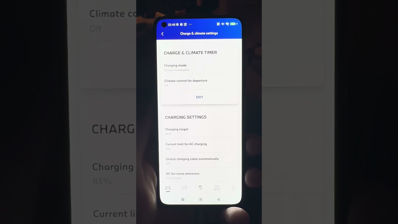

New account so I can’t include multiple links in a post. However here’s an another addition that I’ve been working on: a POC version of ADB Bridge to control the MyBMW app:
It’s already a much faster than in the video, but this is the only one I recorded. This would allow us to access any app features over Android Debug Bridge. Basically making it so that if you have an old Android phone lying around (MyBMW doesn’t work on emulators), you could plug it into your HA server and adjust anything from HA.

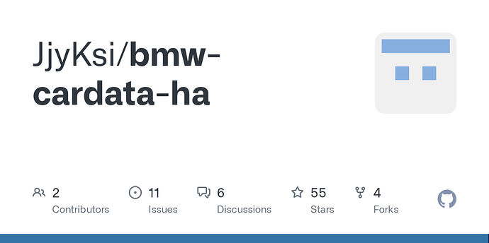

I can recommend JjyKsi’s integration. I have 2 BMW accounts, 1 car on each and it works great. You can’t control the car from it, but you can use your app to heat the car.

Finally got GitHub - JjyKsi/bmw-cardata-ha working - problems not due to the integration but the overly complicated and fastidious process at BMW to get registered on their API :grimacing:
