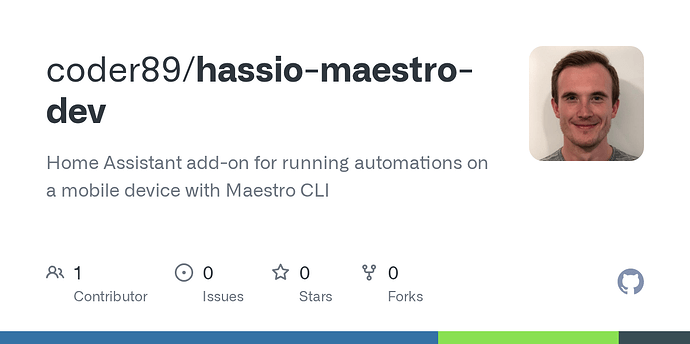

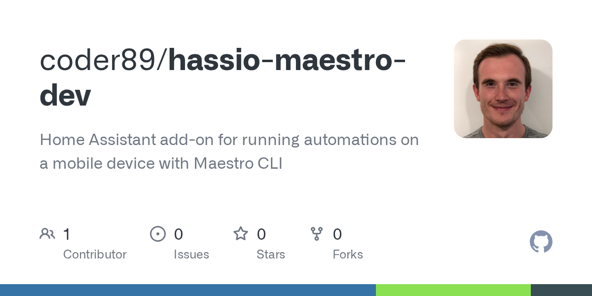

  2. Add GitHub - coder89/hassio-maestro-dev: Home Assistant add-on for running automations on a mobile device with Maestro CLI as a new addon repo & install the “Maestro Mobile” addon. DON’T start it yet.
  3. Add GitHub - coder89/hassio-maestro-dev: Home Assistant add-on for running automations on a mobile device with Maestro CLI as a new HACS repo and install “Maestro Mobile” integration.
