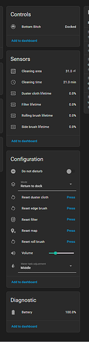

In home assistant with tuya app, you can start/stop change power ect. standard stuff. see screenshot below

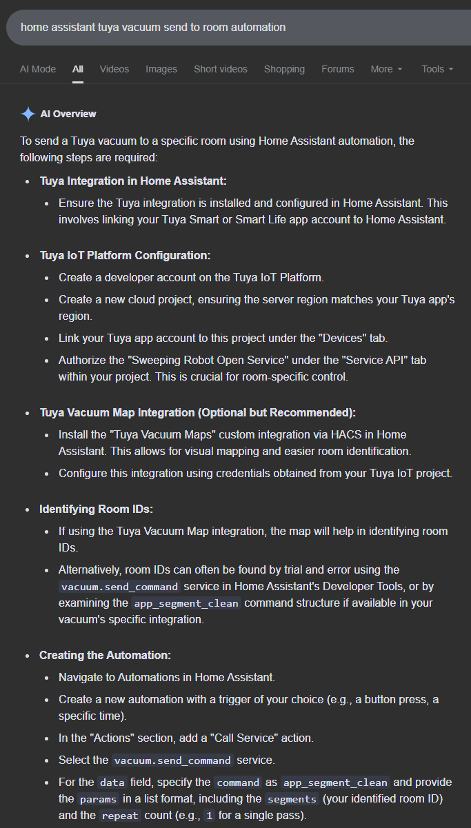

however I there are ways to have home assistant send robot to specific room. just involves setting up Tuya developer account and some extra steps to find the room ID, then yaml the ID in the automation.
I had to do the same stuff with my Dreame Vac, to have it vac a room, then empty, vac another room, then empty… ect
I had to automate the self empty after each room as i have dogs.
This can be done too with some/if-not-all Tuya robot vacs.
Live maps can be done too with HACS addon and Tuya dev account.

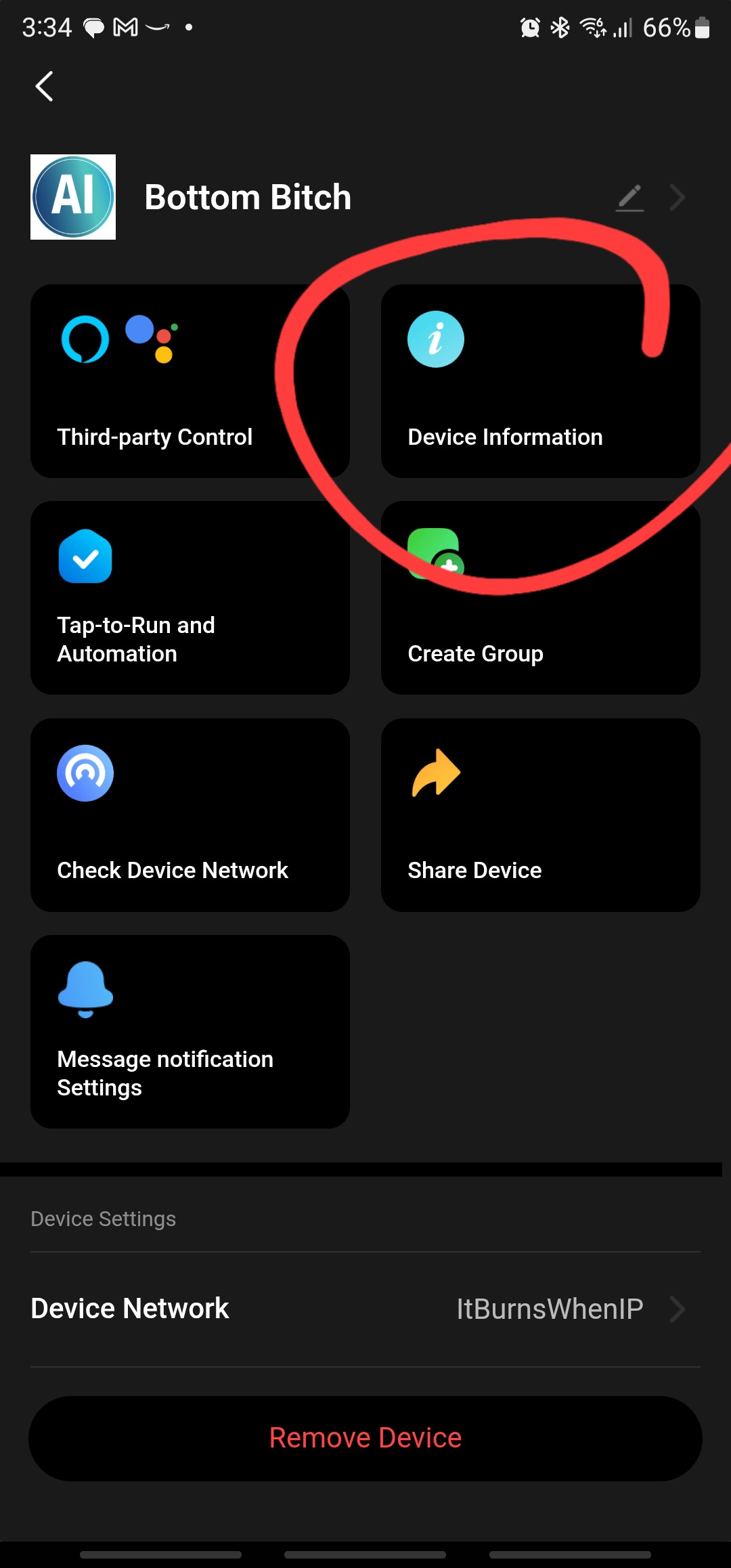

MAC addy
Tuya app > click robot > Map screen
Edit button (top right corner) > Settings Page
Device Information
