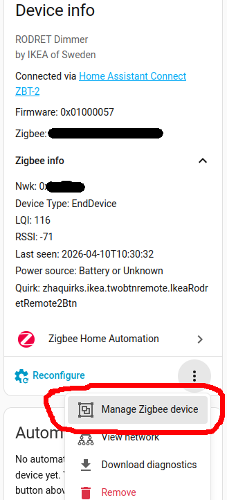

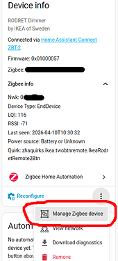

As the device uses Zigbee, it advertises what it can do, and any configuration parameters in a standard format. Both ZHA and Z2M interpret this data, and allow changes to be made. Where the device profile broken, it can be modified with a “quirks file” which is typically applied automatically, but can be manually edited (a “custom quirk”).
The question is, can you see any parameters to change in ZHA?
Here’s an example:
The settings will very likely be confusing, and are specific to this device so I can’t tell you what to look for, just where to look!
As the Amazon post doesn’t mention a “quirk”, my hope is there is a parameter in there as standard, and you don’t need to start writing custom code to get to the setting.

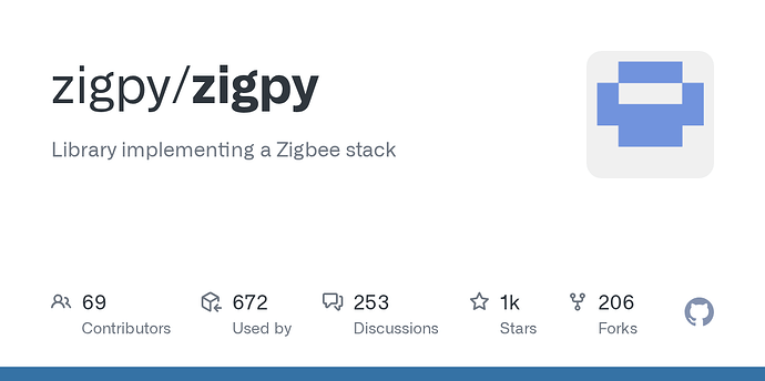

ZHA uses the zigpy open-source Python library:
