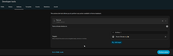

I do not have a Thermostat II 230V, only thermostats mounted at the heating, but you can try the folllowing:
In HA, go to “developer tools” and there to “Scripts”, here you try the actions you put later into the automations. For example:
As target I selected the entity for the thermostat
Press “Perform action” and your thermostat should switch on.
When switching to “YAML”-Mode it looks like this:
action: climate.turn_on
data: {}
  entity_id: climate.room_climate_xxxxx
use action “climate.turn_off” to turn it off

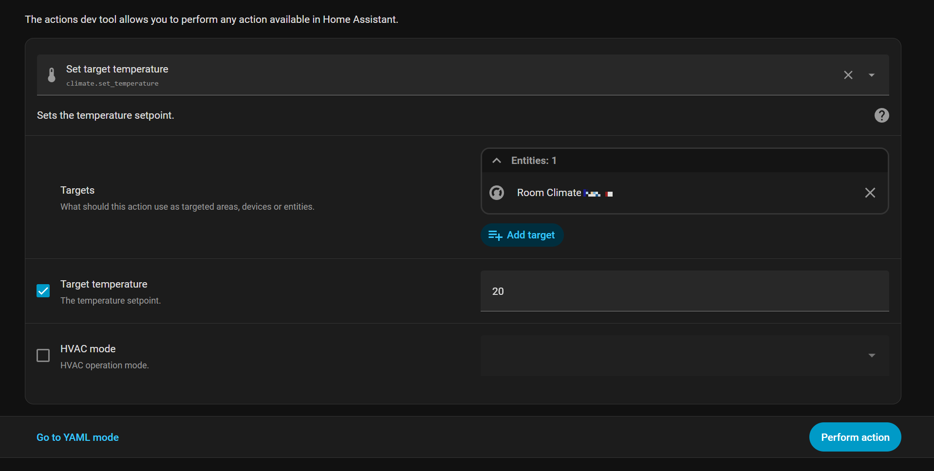

You can also set a target temperature, of course it starts to heat only after it has been switch on too:
as YAML:
action: climate.set_temperature
  entity_id:
    - climate.room_climate_xxxxx
  temperature: 20
Once it works from developer tools you can add the same actions to your automations
hope this helps

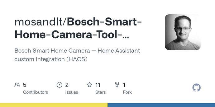

Just want to promote my camera integration
If you have feedback or issues with dot cameras, let me know
Awesome ! I dreamt of it. You did it!
The stream sometimes appears upside-down. I did not yet try to solve that issue. Maybe a setup.
Many thanks for this great work.
tested with Bosch 360 Indoor Camera 1st generation
