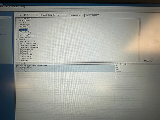

Hi everyone,
I have a Bosch AMAX 4000 (Firmware V2.00)
A-link Plus software V5.2.0
Connecting via IP address using “Home Assistant” with “Bosch Alarm” works perfectly.
For the password connection:
It asks for an automation code.
I can’t configure the automation mode for mode 2 in A-link Plus.
Does anyone have a solution?
Thanks in advance for your help
With the AMAX panels, what you are looking for in A-Link Plus is the “Automation Pass code”
which us under the “Remote access” section
thank you for your feedback.
Unfortunately, the code automation tab doesn’t appear.
I read in some articles that this option isn’t available in certain countries
Looks like in your language, Automation got translated to Supervision, its that last entry there, “Mot de passe Supervision”
