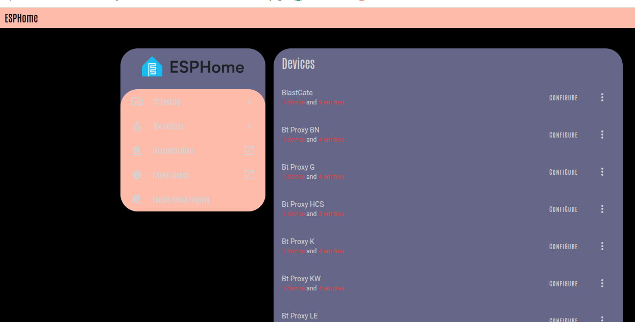

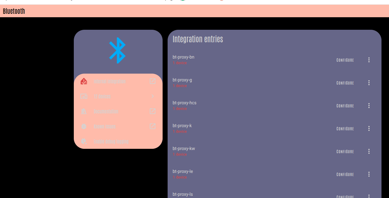

Probably more of a Bermuda, ESPHome, or Bluetooth integration question but in all my reconfiguring, at some point all my BT Proxies started getting the FULL naming convention applied. I’ve tried to rename, reinstall, and reboot but cannot seem to get the names to clear out of Bermuda and subsequently for use in BPS on the floorplan.
Any ideas?
Also, I have this in all the ESPHome codes:
esphome:
name_add_mac_suffix: false
friendly_name: ${friendly_name}
With the latest Bermuda update, have you managed to solve the issue. I had the same issue as well. I removed the old “unused” entities and updated Bermuda and now everything works as intended.
It cleaned up the device names, yes!

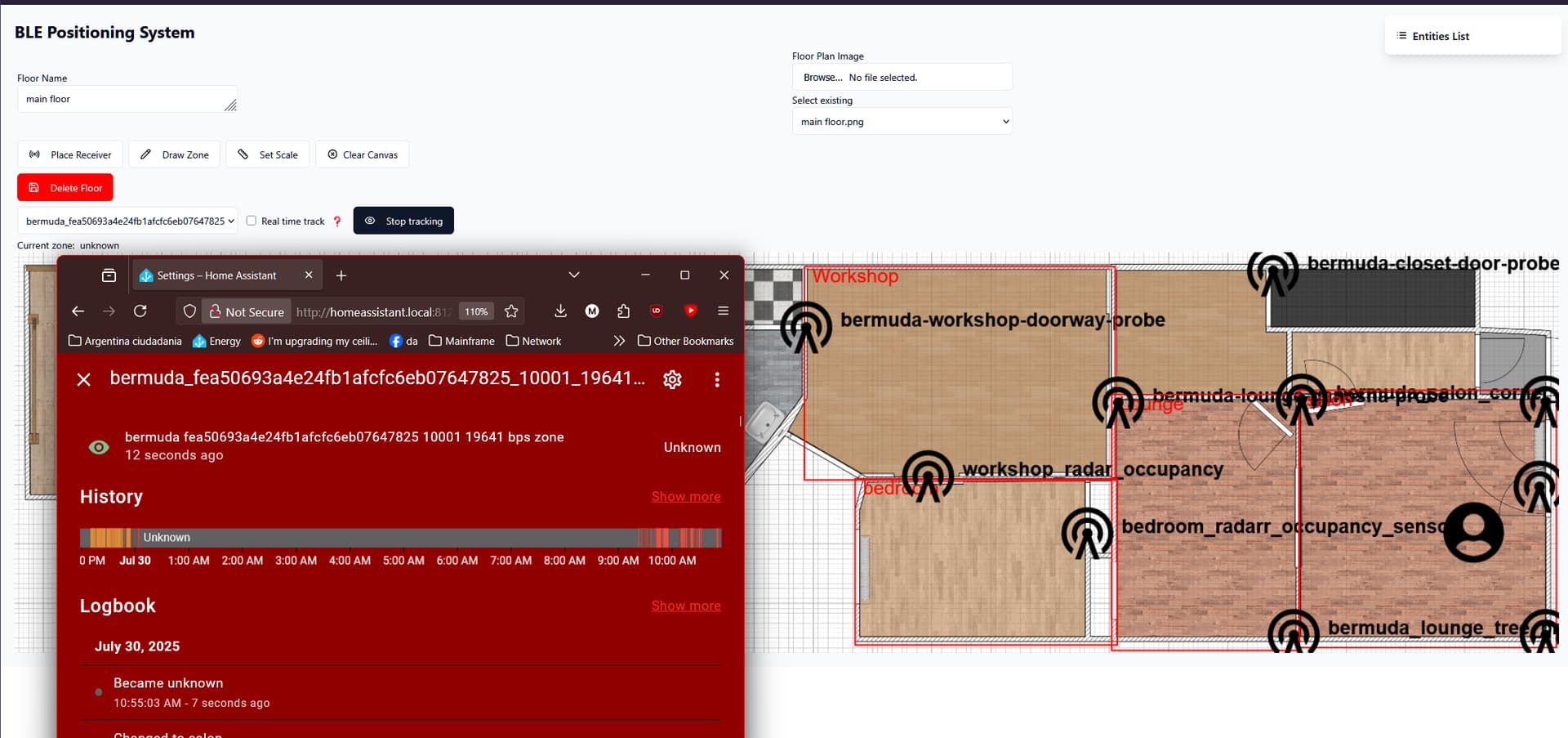

I have an entity that is visibly in the Salon zone; but it shows unknown as the room entity
Edit:
Installed a few more nodes but the issue persists:

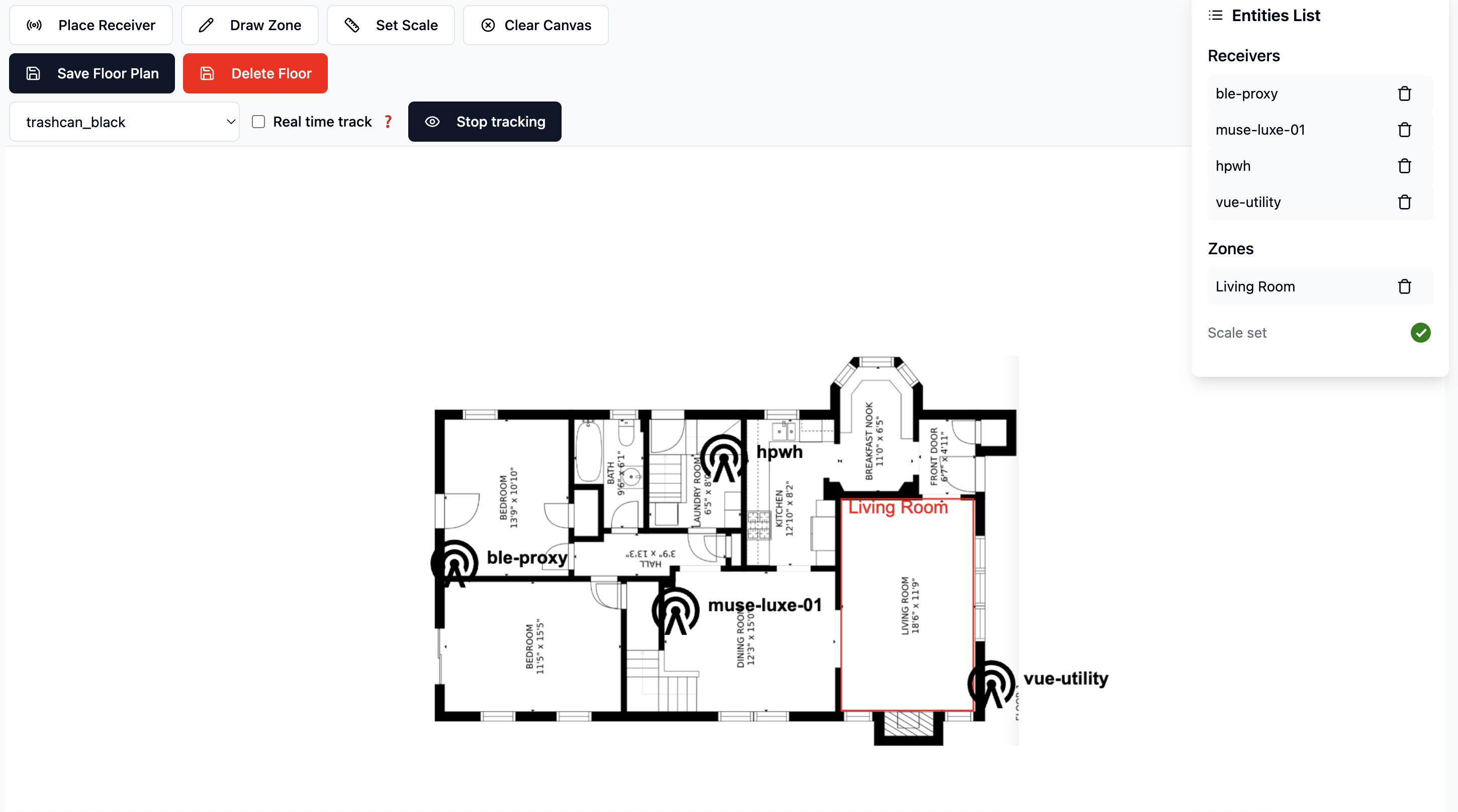

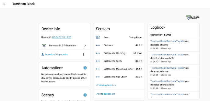

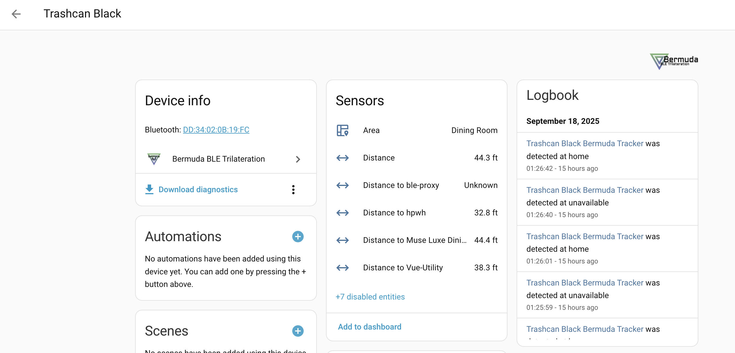

I have the issue that my tracking devices just won’t show up:
However, they do work, as an example, all distances are shown (except in this case ble-proxy which is “Unknown” due to out of range):
Any advice?

Without having analyzed the code, I visually notice that you 1) mix upper and lower case 2) have spacing in you names.
What you could try (no guarantees) is to make sure all are low case and replace spacing with underscore “_”.
