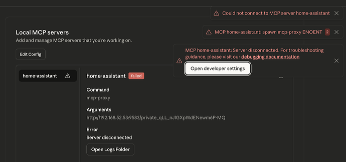

As instructed I added mcp-proxy (how to verify installation is properly concluded?).
I tried to configure Claude Desktop to connect adding to its configuration file (claude_desktop_config.json on Mac):
  "preferences": {
      "quickEntryShortcut": "off"
  "mcpServers": {
    "home-assistant": {
      "command": "mcp-proxy",
      "args": ["http://192.168.52.53:9583/private_redacted"]
After restarting Claude I get error in application:
What is wrong here?
I fixed the instructions. There was an error in the docs. See [ISSUE] Home Assistant MCP Connection Error · Issue #93 · homeassistant-ai/ha-mcp · GitHub

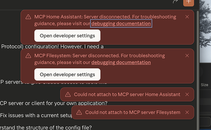

EDIT: Just noticed new guides for configuration for specific environment. So I tried again Claude and it it does not work even for demo config. I get errors:
So seems something wrong with. my Mac setup?
UI-only for now. I’m looking of ways to edit yaml files, but it’s not ready yet.
I made the choice to not have list_automation tool since there is a search entity tool that can be used with the automation domain. maybe it`s not working with your setup. let me know.
to debug your problem on Claude Desktop, I would need the logs.
Clear the folder ~/Library/Application Support/Claude/Logs
Restart Claude Desktop
Make a copy of the Logs folder and ~/Library/Application Support/Claude/claude_desktop_config.json
you can remove any sensitive information.
zip and send to [email protected]
