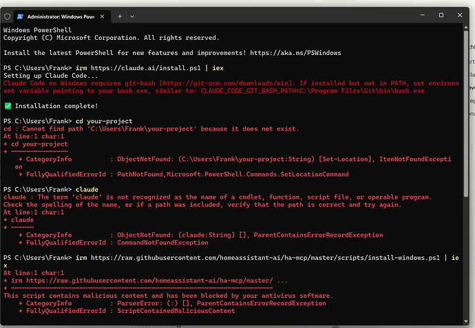

I’ve registered with Claude but have got a bunch of errors when installing the desktop on Windows 11.
Anyone able to offer a solution? Much of what is reported in the screenshot is language I don’t understand!!
Probably not surprising but whatever has been installed cannot see my Home Assistant installation.

You need git for Claude Code to work :
Install it from the URL they provide or use this command:
winget install --id Git.Git -e

Thanks. git installed without any dramas, I’ll see how I go!
